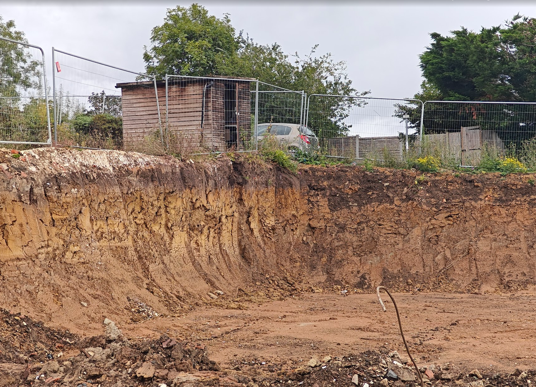

And then the neighbouring plot to mine have done almost the identical excavation to me, and left it like this:
I see how this could be safe whilst excavating with a digger, as no one is in the collapse zone, but how about doing any work under it?
To me, it seems unlikely the bank would suddenly collapse, it will probably be fine, but thats not good enough when the consequences could be death?

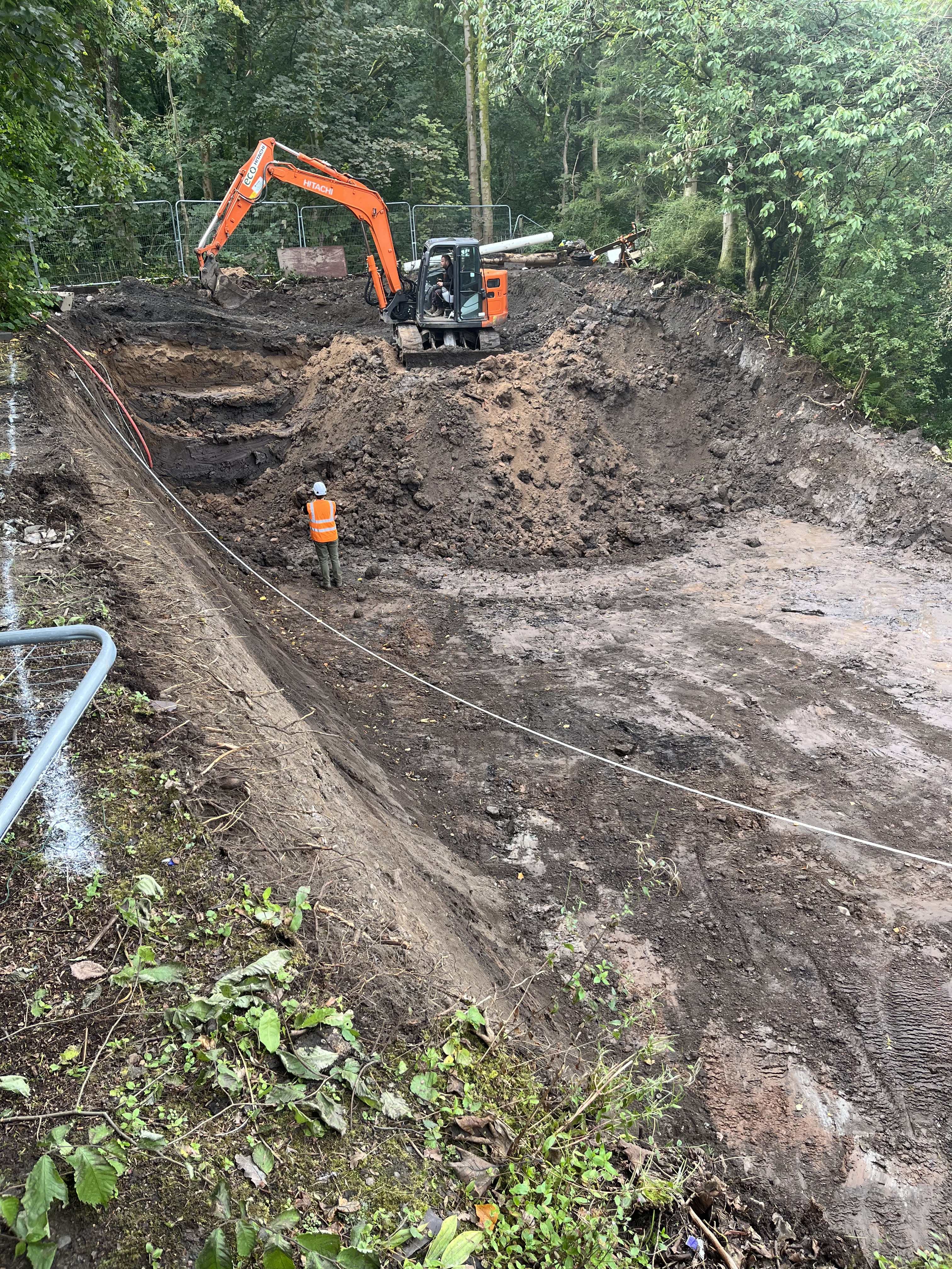

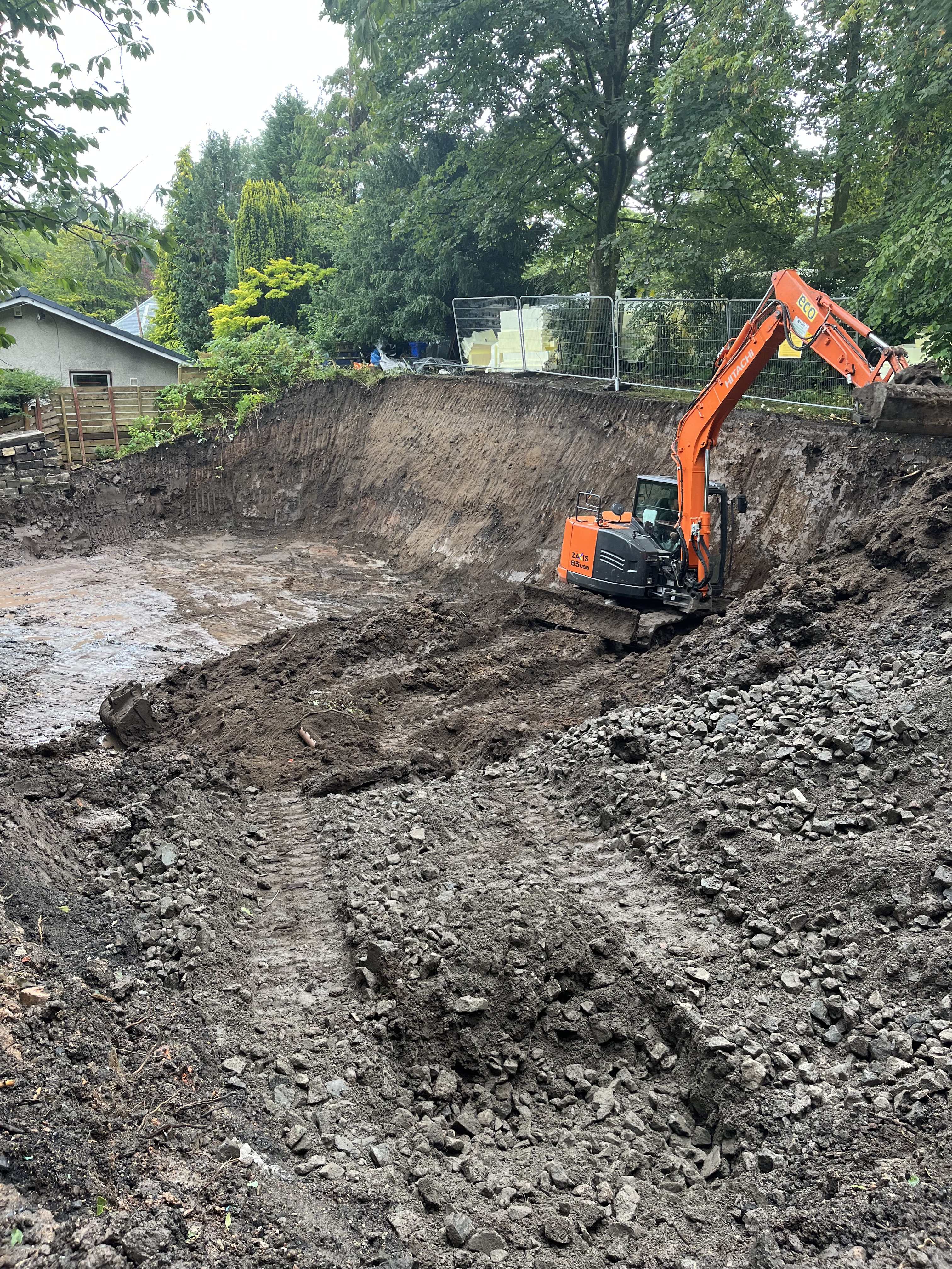

We have a similar issue when digging for basement, the house we demolished had a basement but was not deep enough and only used for garden storage. I did but didn’t really appreciate how tight our build is until it came to sloping the ground to accommodate the basement build. But we are in a slop, several slops in all directions, just to make things fun.
we are heavy clay although we found some building sand had be used on the original fill in, which gave us some issues and had to dig wider to remove as this could have easily have fallen on us when working in our hole. We are still in our hole!

The first photo shows the front south facing trees behind security fence, they have TPOs which is why the fence is there to protect them. The second shows the north back garden trees, which also hides a 45 degree slope of 9m which then goes down to a flat area of 10m, it then goes down another 45 degrees for 6m and then flat for 5m. Our farmer digger operator tracked a path for us for his digger and us after the photos were taken to the bottom of our hole, he also created a secret path behind the trees which leads to the flat garden but also able to access what will be the entrance to our basement. The skill of his digging and navigate his digger in and out the hole and moving the soil was amazing to watch.

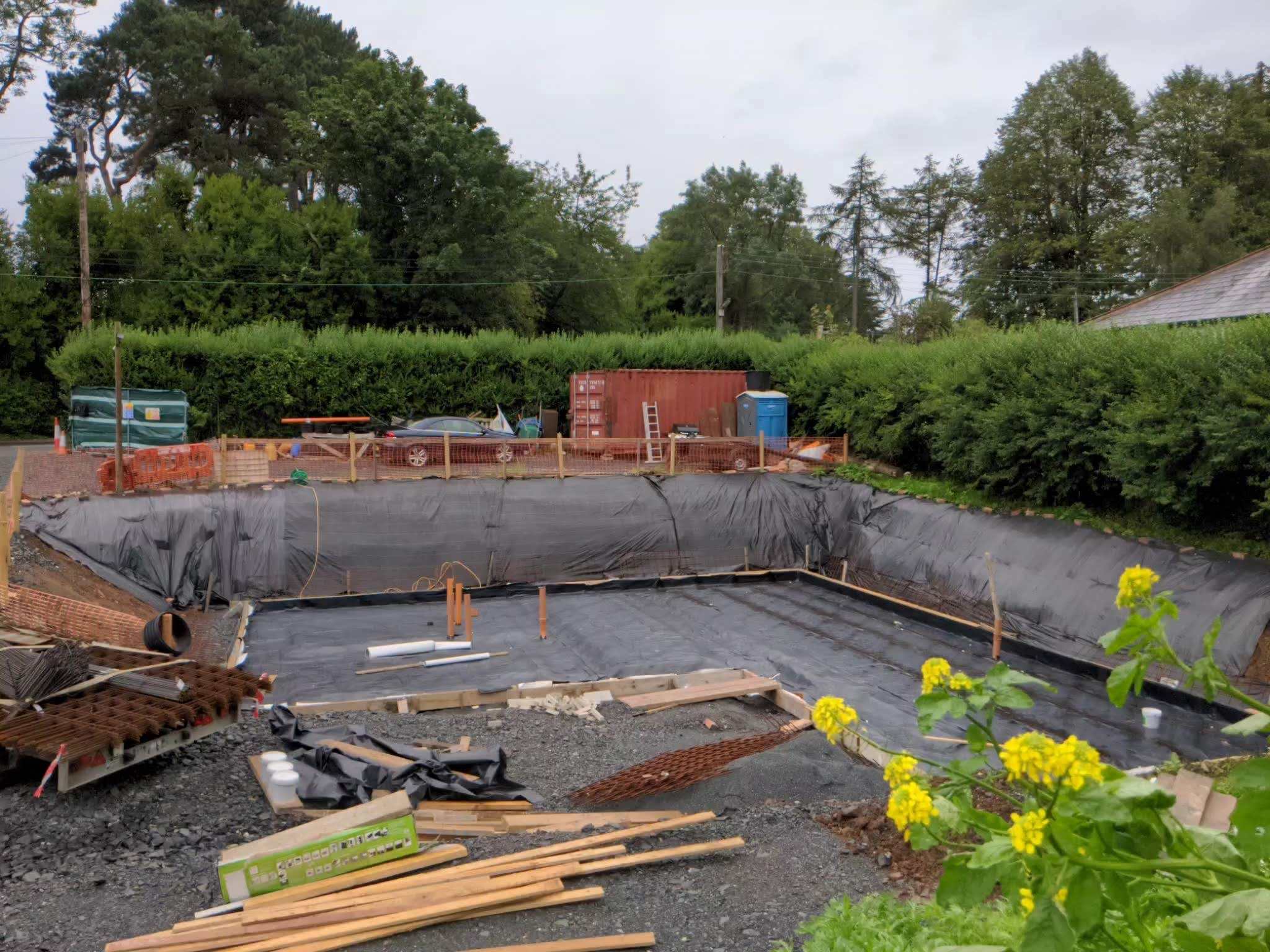

We batted back to about 60degrees. This was based on an assessment of the soil by the SE following a trial hole and a determination of soil modulus. A key thing to remember, is that weather and time are enemies of a stable slope. To help mitigate this you can employ various methods to stabilise the slopes. I chose to use woven membrane, overlapped and staked in to the ground, lapped under compacted stone at the top. At the bottom we had a sturdy catch fence to stop any material to spill in to the working area. No issues. through a wet winter. One corner was particularly wet with a constant flow of water the pulled out a bit of clay. had to be cleared out a few times.
Also, critically, an exclusion area at the top of the slope so vehicle or material weight aren't too close to the top edge.

Question 1. What is your ground? As in the photo referring to neighbours? Is that actually it?
No, this actually is the neighbour's, not me trying to cover up! 1m made ground over stiff clay (site of a former brickworks, 100 years ago), but with a severely sloped section that probably needs to be levelled for a piling rig to work, just out of shot to the left on my picture.

On 07/09/2025 at 23:21, Gus Potter said:
When we dig a hole in a sticky clay soil you'll often see that the sides don't fall in right away. But after a few days/ months the sides do fall in.
About 2.5 weeks is the stand-up time it appears, it has now started to collapse!
Nice to know I wont be spending money for no reason.
