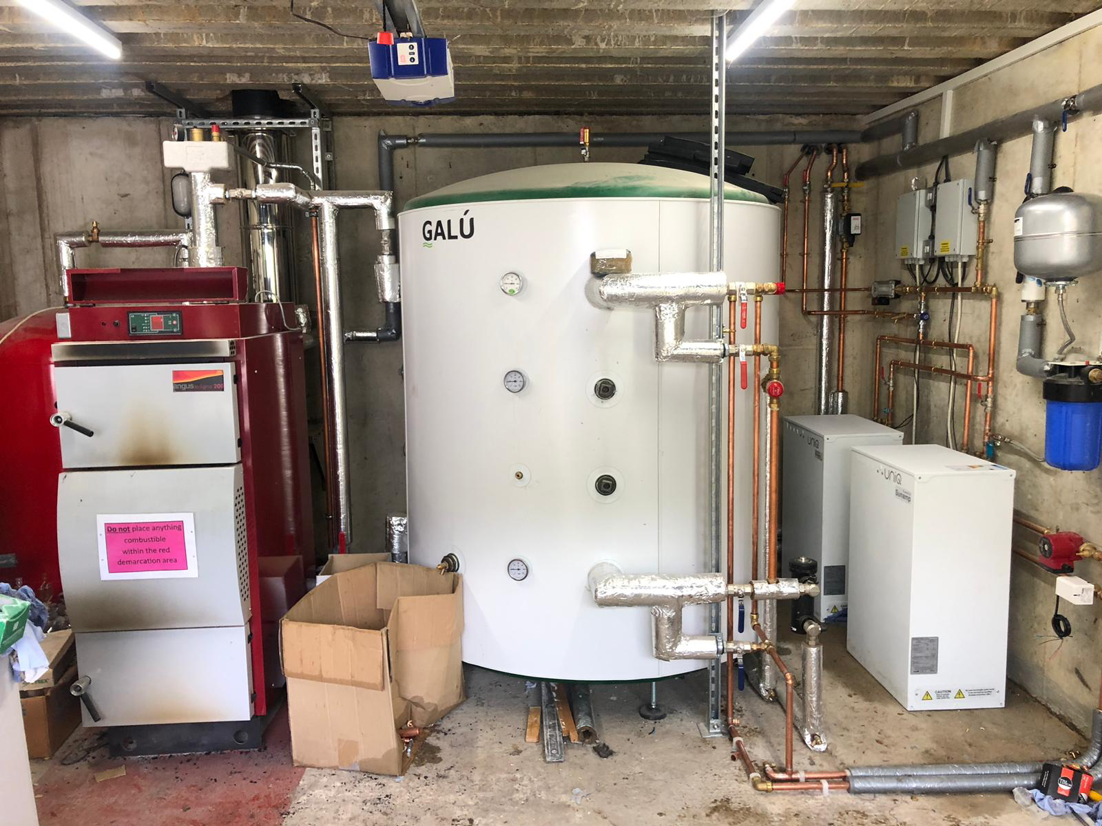

I fitted a pair of ‘9’s’ to a buffer fed from a log gasification boiler, and until the buffer (thermal store) got up to north of 75°C the Sunamps didn’t really pick up very quickly.
I hadn’t finished fitting the insulation at this point!! Relax people :)
At 82°C they seemed to then get some sense of urgency.
An UVC would have started mopping up useful energy way sooner <60°C.
