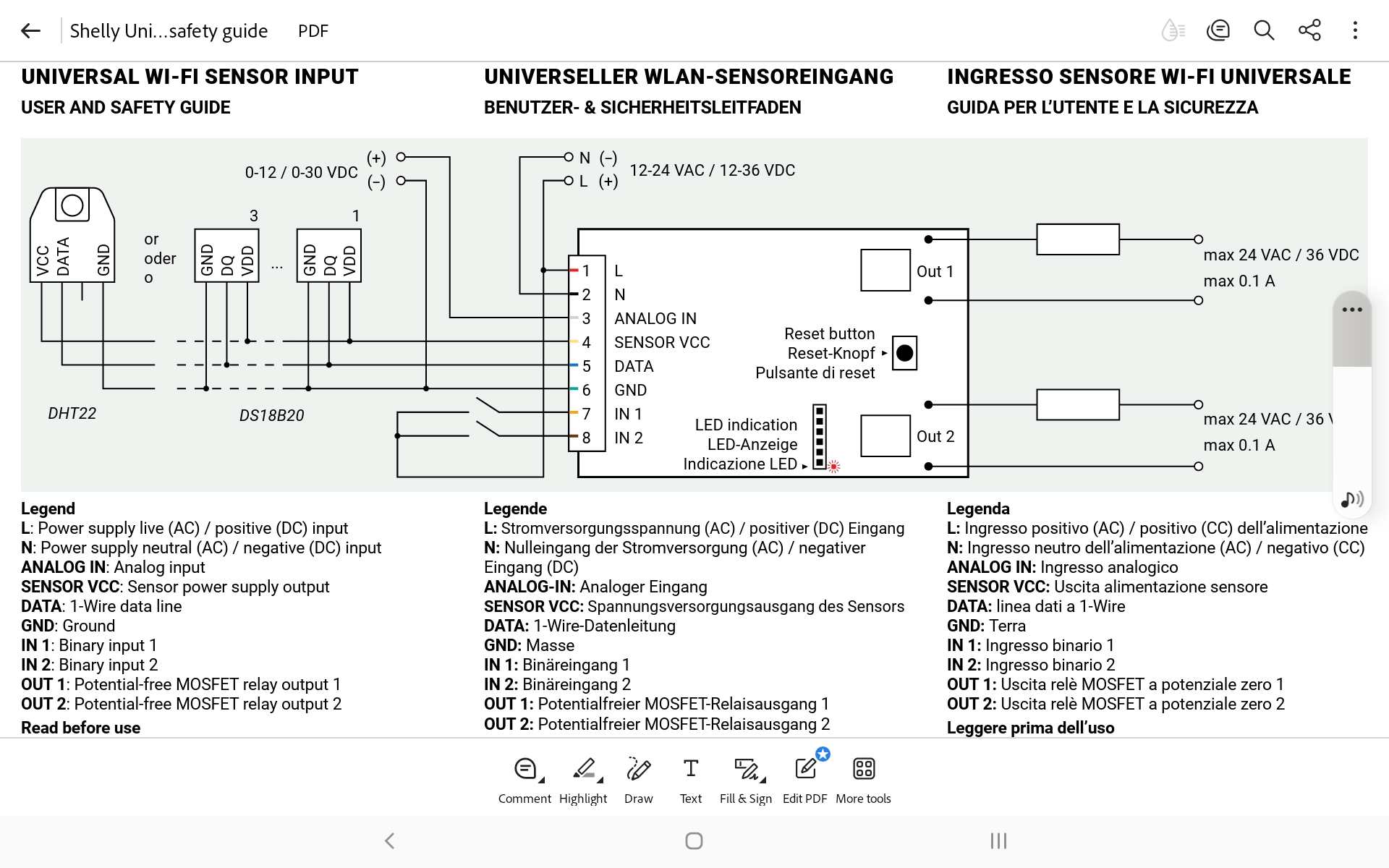

Temp Posted Friday at 14:51 Posted Friday at 14:51 (edited) 23 hours ago, Pocster said: In Home assistant though ( via a Shelly uni ) If the float switch is essentially just an un powered switch with two wires I believe it should be connected to pin 7 (or 8 ) and VCC (pin 1)... Edited Friday at 14:53 by Temp 1
Pocster Posted Friday at 15:08 Author Posted Friday at 15:08 16 minutes ago, Temp said: If the float switch is essentially just an un powered switch with two wires I believe it should be connected to pin 7 (or 8 ) and VCC (pin 1)... Hmmmmm Not pin 7/8 and gnd ?
Temp Posted Friday at 15:42 Posted Friday at 15:42 (edited) 37 minutes ago, Pocster said: Hmmmmm Not pin 7/8 and gnd ? Not if you follow that diagram. One side of the switch is shown connected to pin 1 L. (Sorry I called it VCC earlier.) However that assumes the float switch is literally just that, a switch. It may not work if the float switch is a powered device. Sorry for editing this post a lot. I'm waiting for a train and hate typing on my phone. Edited Friday at 15:46 by Temp
Pocster Posted Friday at 15:50 Author Posted Friday at 15:50 (edited) 15 minutes ago, Temp said: Not if you follow that diagram. One side of the switch is shown connected to pin 1 L. (Sorry I called it VCC earlier.) However that assumes the float switch is literally just that, a switch. It may not work if the float switch is a powered. Yeah it is just an open or closed circuit ( the switch ) . Been fiddling and am indeed using pin 9 and pin 7 gnd and I think it works . Just noticed your diagram is different . Also just noticed I have the Shelly uni plus - so that could be the confusion Edited Friday at 15:58 by Pocster

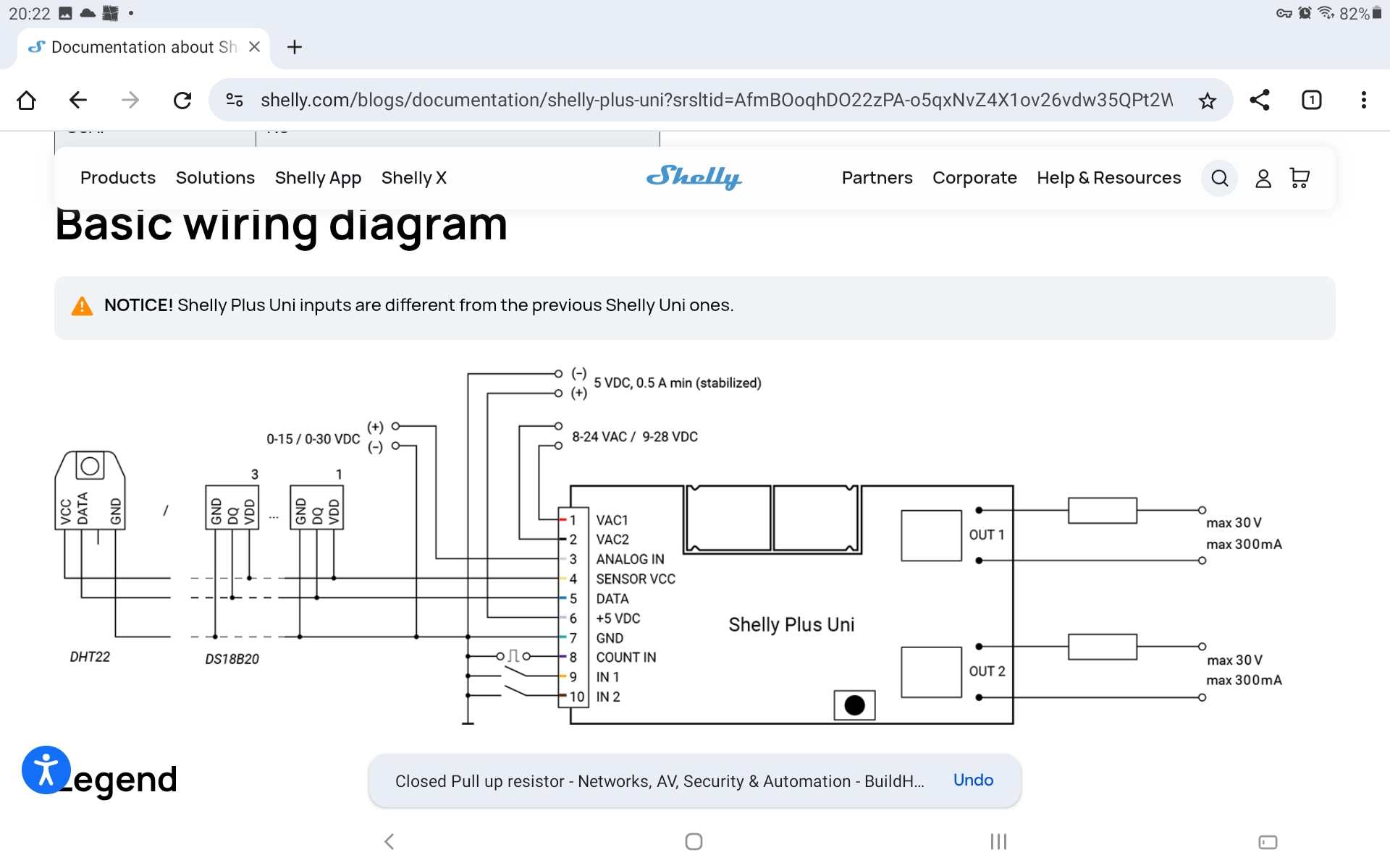

Temp Posted 5 hours ago Posted 5 hours ago On 15/08/2025 at 16:50, Pocster said: Yeah it is just an open or closed circuit ( the switch ) . Been fiddling and am indeed using pin 9 and pin 7 gnd and I think it works . Just noticed your diagram is different . Also just noticed I have the Shelly uni plus - so that could be the confusion Yes the "plus" is different. I found this circuit for the plus which shows switch between 9 or 10 and GND pin 7. No pull up resistor shown.
Temp Posted 5 hours ago Posted 5 hours ago Google AI said.. Quote The Shelly Uni Plus does not require an external pull-up resistor for its digital inputs as it has a built-in pull-up resistor, according to the Shelly community. The digital inputs are "active low", meaning they are pulled high by the internal resistor and pulled low when activated by a small current (typically 36μA) flowing from the input pin to ground, according to the Shelly forum. Explanation: Built-in Pull-up: . The Shelly Uni Plus has an internal pull-up resistor on its digital input pins. This means that when no external signal is connected, the input pin is automatically pulled high (to a voltage level that indicates a logical "1"). Active Low: . The digital inputs are designed to be "active low," meaning a signal is considered active (or triggered) when it is pulled low (to ground). No External Resistor Needed: . Because of the built-in pull-up, you don't need to add an external resistor to pull the input high. You can directly connect your sensor or switch between the input pin and ground.
