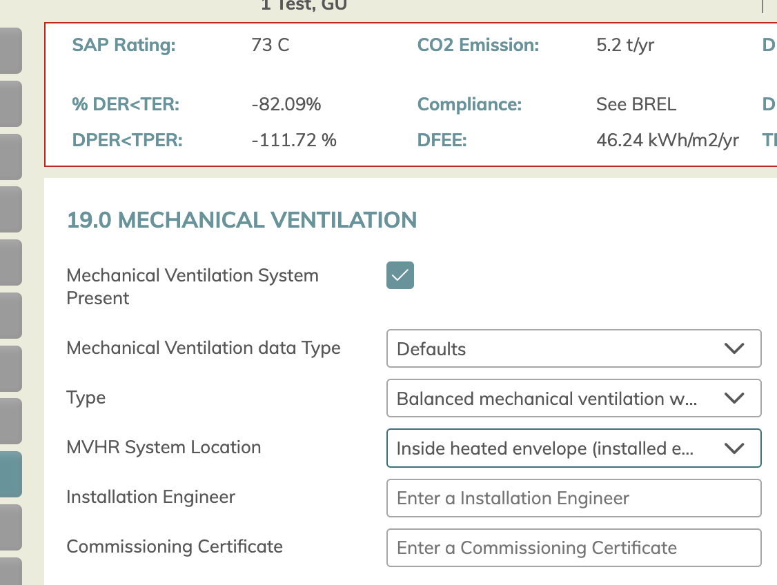

I thought the assessor must be entering something wrong so I got access to a trial version of SAP assessment program and re-did the info myself. Nope, it somehow actually gave me an even lower score of 73. I removed the MVHR and added vents, changed the ASHP to a mains gas boiler and straight back to 87.

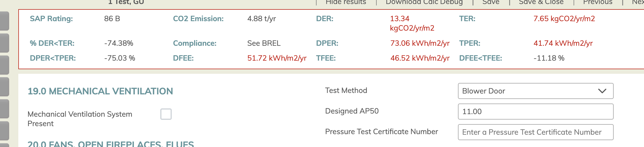

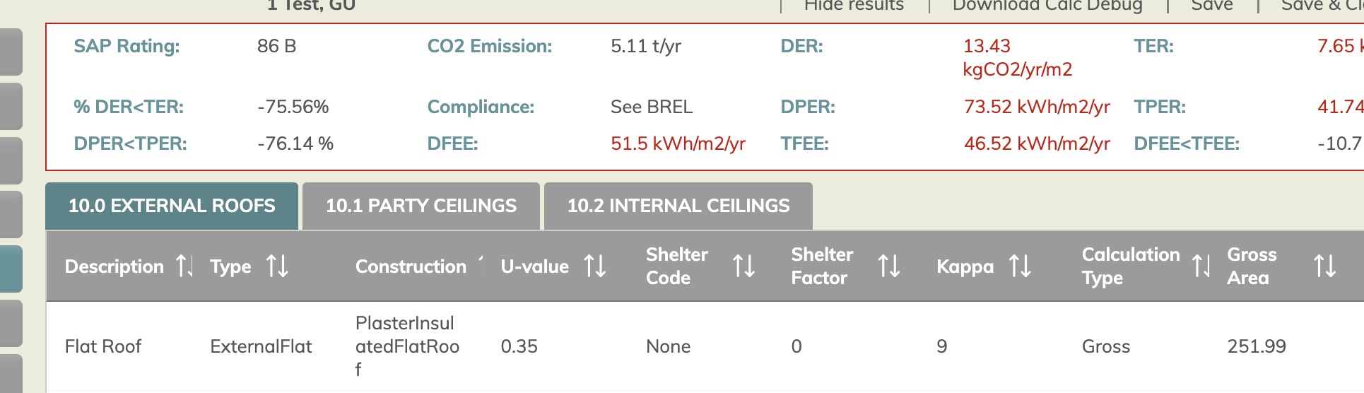

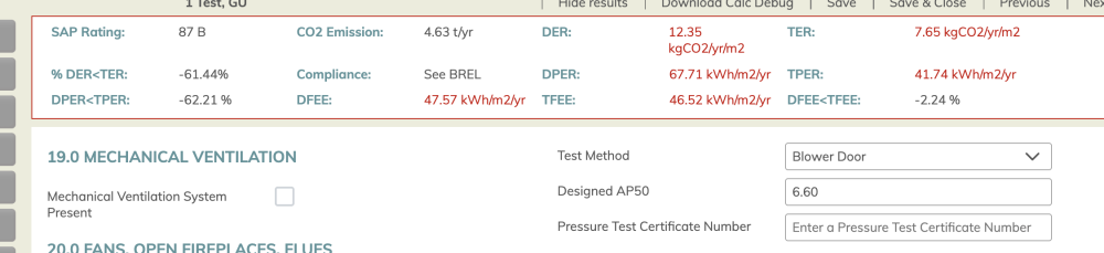

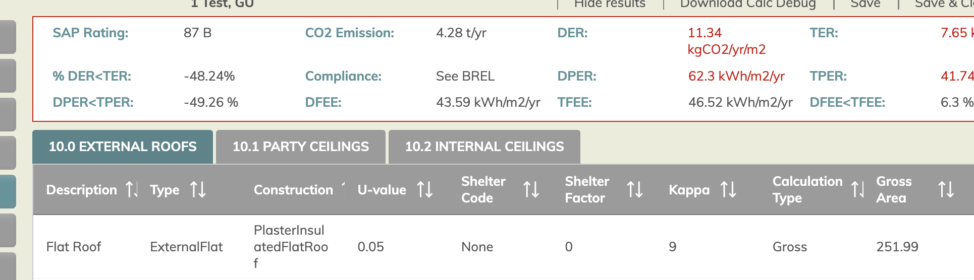

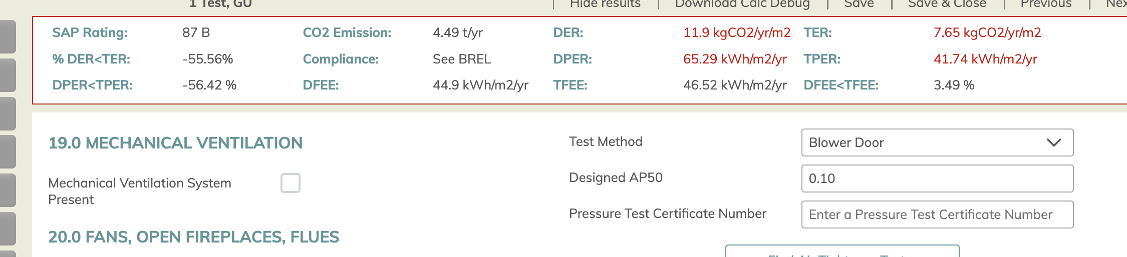

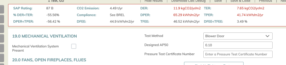

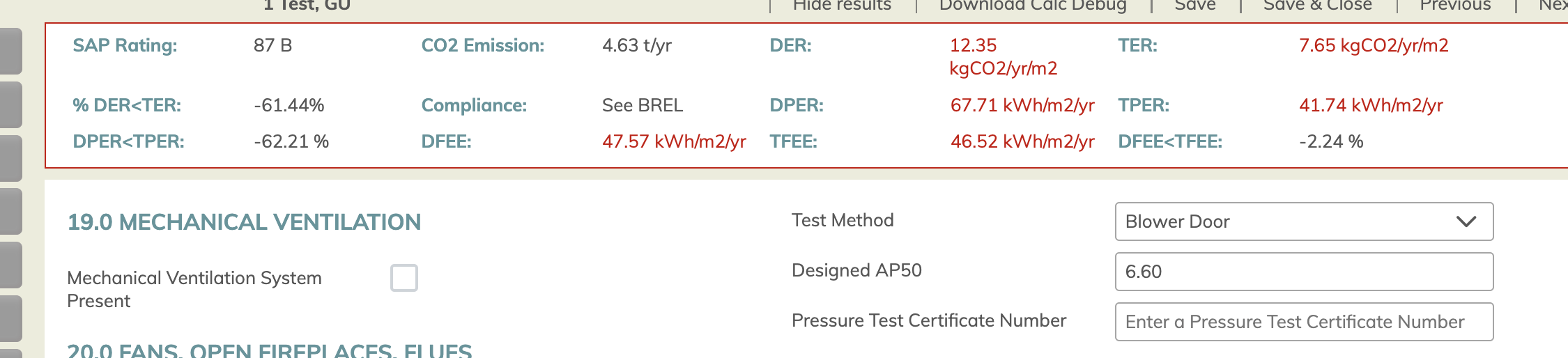

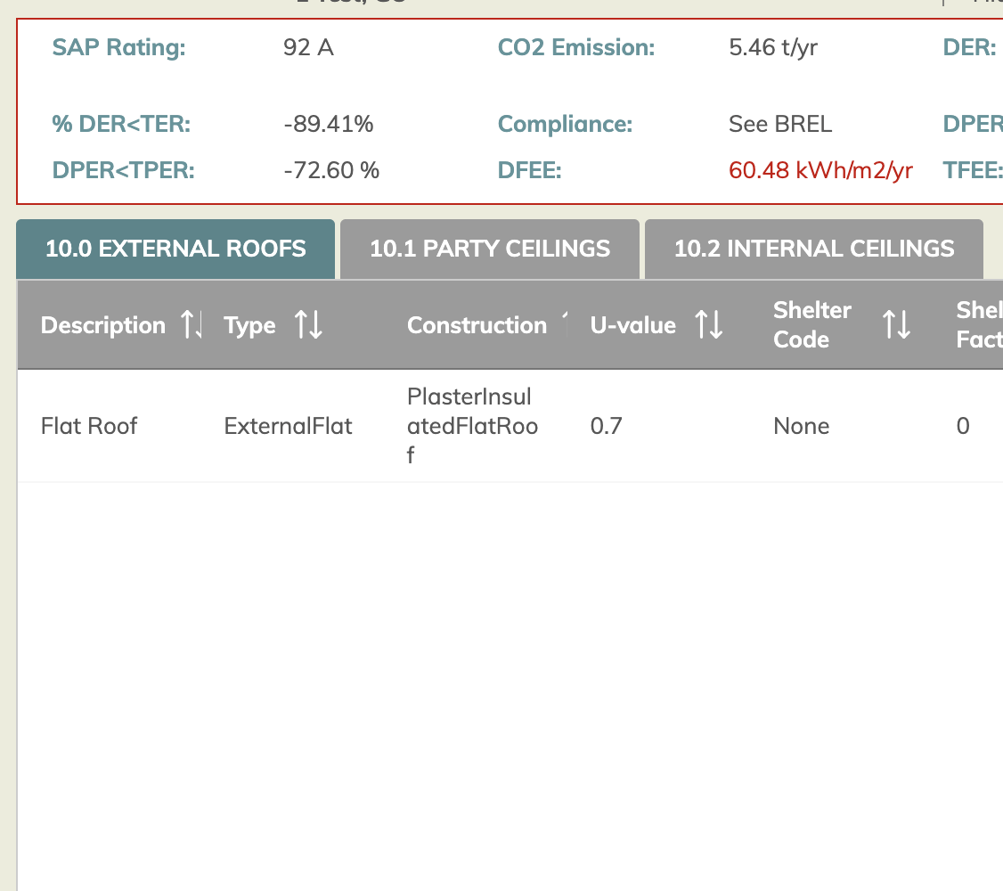

This is all done on the latest SAP 10 standards. I've attached some screenshots showing the score change from making one alteration to the spec, leaving all else the same. I reset the spec to the original before changing a new data field.
I start on 87 B with no ASHP or MVHR, 0.15 u for roof and 0.1 u for walls.
Air Tightness - no change in score between 6.60 and 0.10
Roof u-value (251m2 gross area) - 1 point change between 0.35 u value and 0.05
Adding MVHR - 5 point reduction to 82
Adding 6kW PV + 12 kWh battery - increase of 8 points to 95

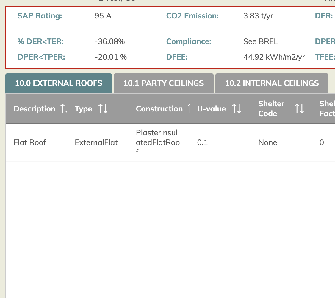

Changes to data but keeping the PV and battery in the spec:

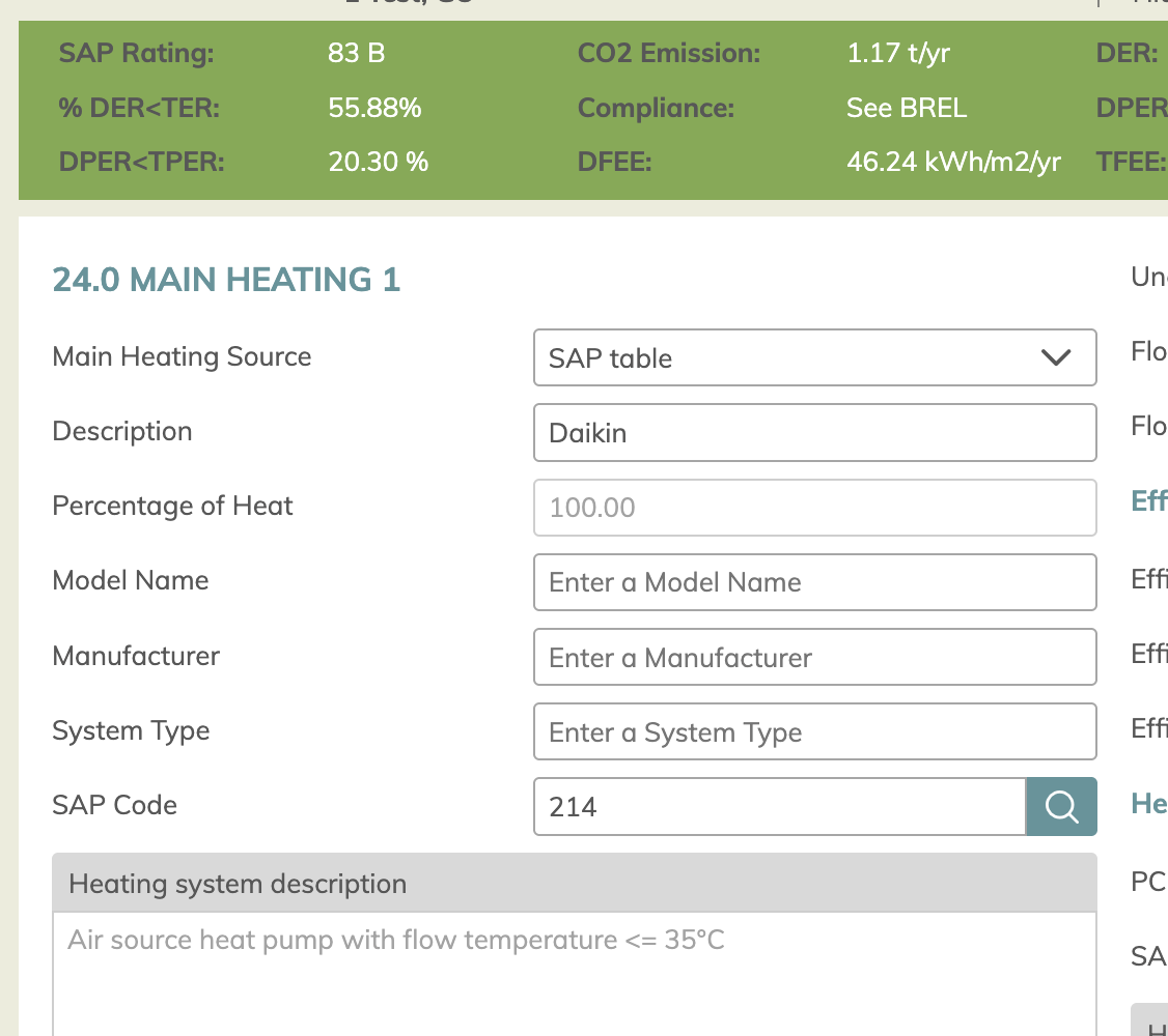

Main heating source changed from mains gas to ASHP - 12 point reduction to 83
Flat roof u-value - improving u-value from 0.15 to 0.1 has no effect. Worsening the u-value to 0.7 drops the score by 3 points to 92

Have you completed the details fully to come up with the number or just the basics? I don't know the app but I note that the heatpump efficiency is marked at 100% in your screenshot. In reality a good install should be 400-500%.
You need the detail to be correct to get good output. I've seen many on hear saying they initally got bad numbers but once all the little details were added it came out better. SAP is still a flawed system however.

Yes, took ages copying all the details into the new one before making changes. That 100% isn't for efficiency, it's for percentage of heat i.e. how much of the heating for the house is done by that unit (for situations where you have multiple sources).

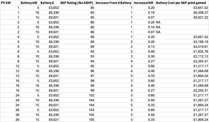

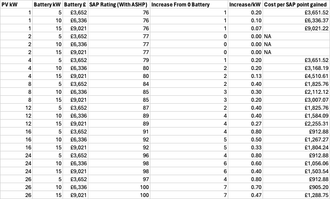

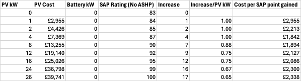

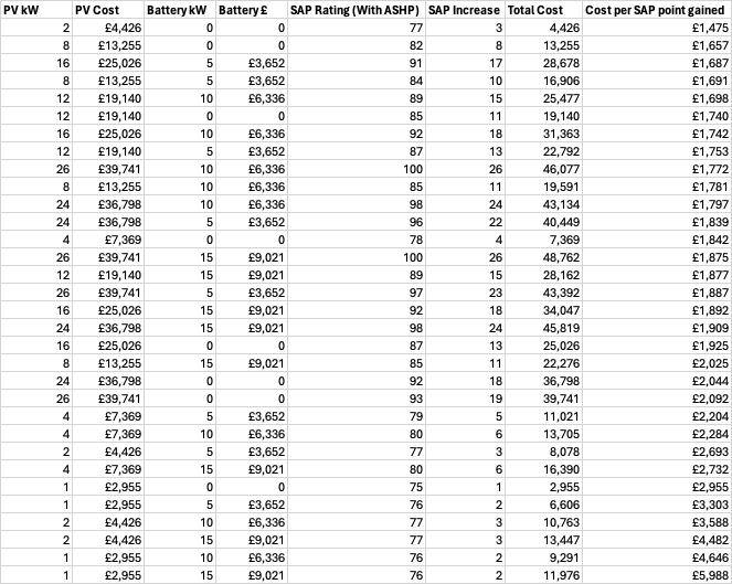

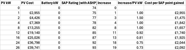

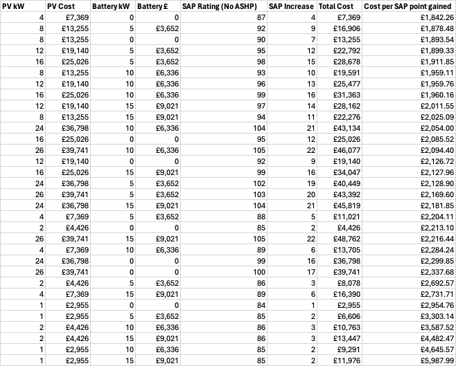

I spent some time putting together the differences battery size makes when paired with different PV systems. It varies quite a lot on the PV kWp and also whether or not you have an ASHP.
Figures used for PV/Battery costs are from here
1. This shows the gain from PV with no battery and no ASHP
2. PV, no battery, with ASHP
3. Battery sizes (5, 10 and 15 kW) paired with different PV kWp. No ASHP
4. Battery sizes (5, 10 and 15 kW) paired with different PV kWp. With ASHP
5. Ranked by cheapest cost (total cost of PV + Battery) per SAP point gained. No ASHP
6. Ranked by cheapest cost (total cost of PV + Battery) per SAP point gained. With ASHP

Would be interesting to see the last charts by Battery kW, then cost per SAP point.  In terms of our thinking, 5kW of battery wasn't going to achieve a lot but then deciding whether to go 10 or 15 was.   Same goes, I guess, for PV. The costs of installing 2kWp would be crazy and that shows I think in the earlier sheets.
