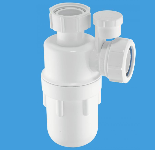

That’s fine then - it’s venting the sewer. You may get some sink gurgling when a toilet in the extension is flushed but otherwise that is to regs. If it’s a problem then fit a couple of 32 or 40mm AAVs or anti siphon wastes to the basins.

Sewer gas is a very old concept and much less common these days. AAV/SVP are normally about stopping suction of water traps in WCs, showers and basins and the associated 'gurgling' you get as air is drawn through the water traps. These can be simply fixed by either using an inline AAV on a waste under a sink, or an AAV trap.
