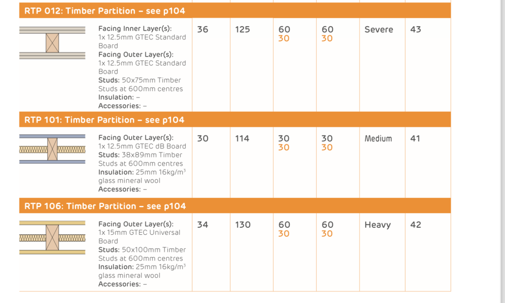

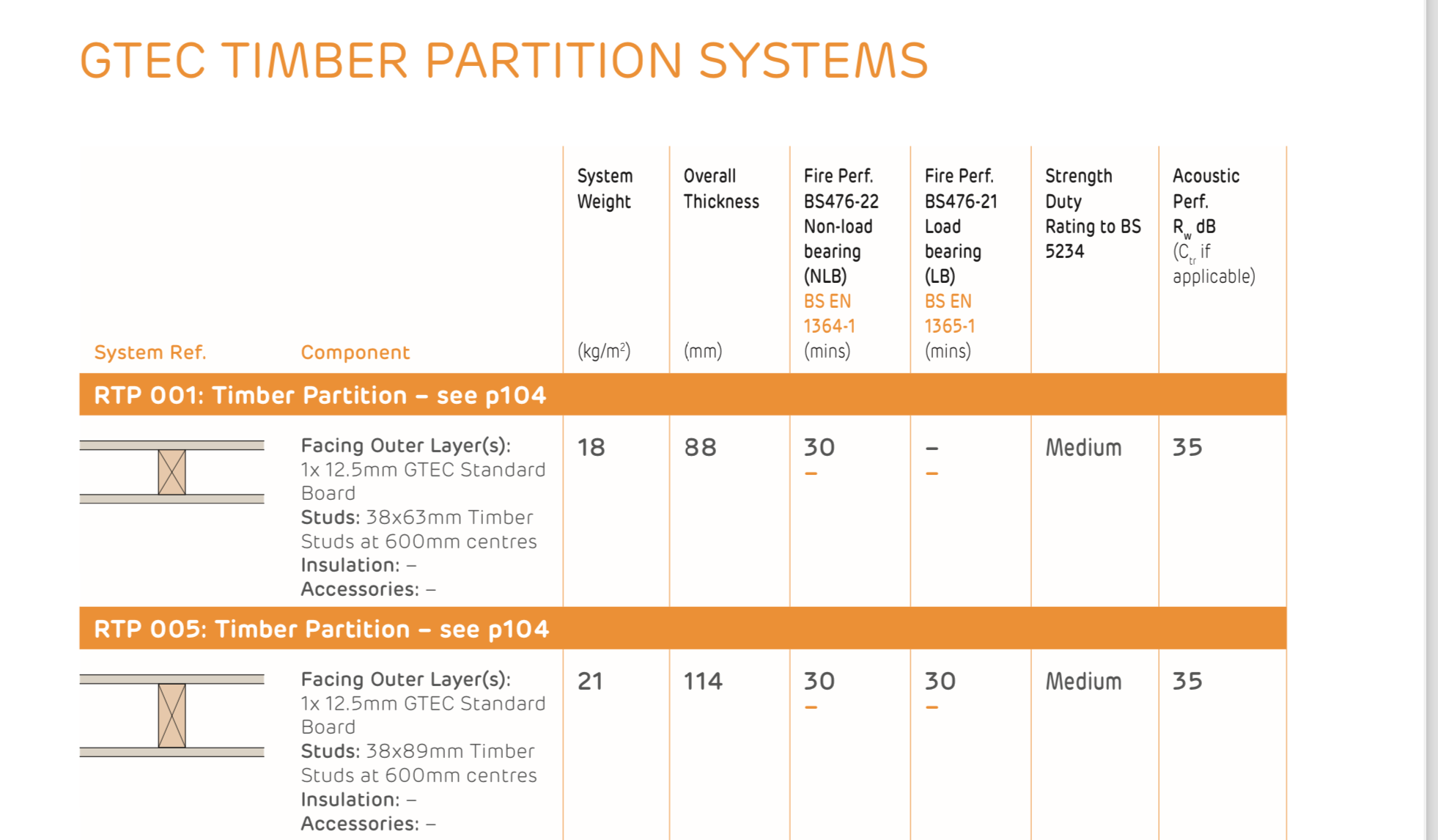

You need to look at the performance tables from British Gypsum or Siniat GTEC, etc.
This picture shows the acoustic performance of a simple 12.5mm timber stud wall, 35 is the key number.

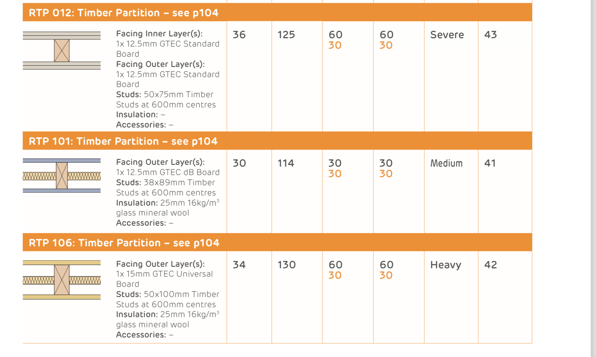

Next picture shows more variables, double boarding or insulation 16km/m3. Number now is higher than 35, this is better.
You can find these performance tables from most plasterboard manufacturers, sometimes in a document called the White Book.

Thanks so much for all the info, particularly the picture, very interesting and informative.  We're going to try and insulate as best as possible as have two elderly relatives living with us who have their TV very loud!
