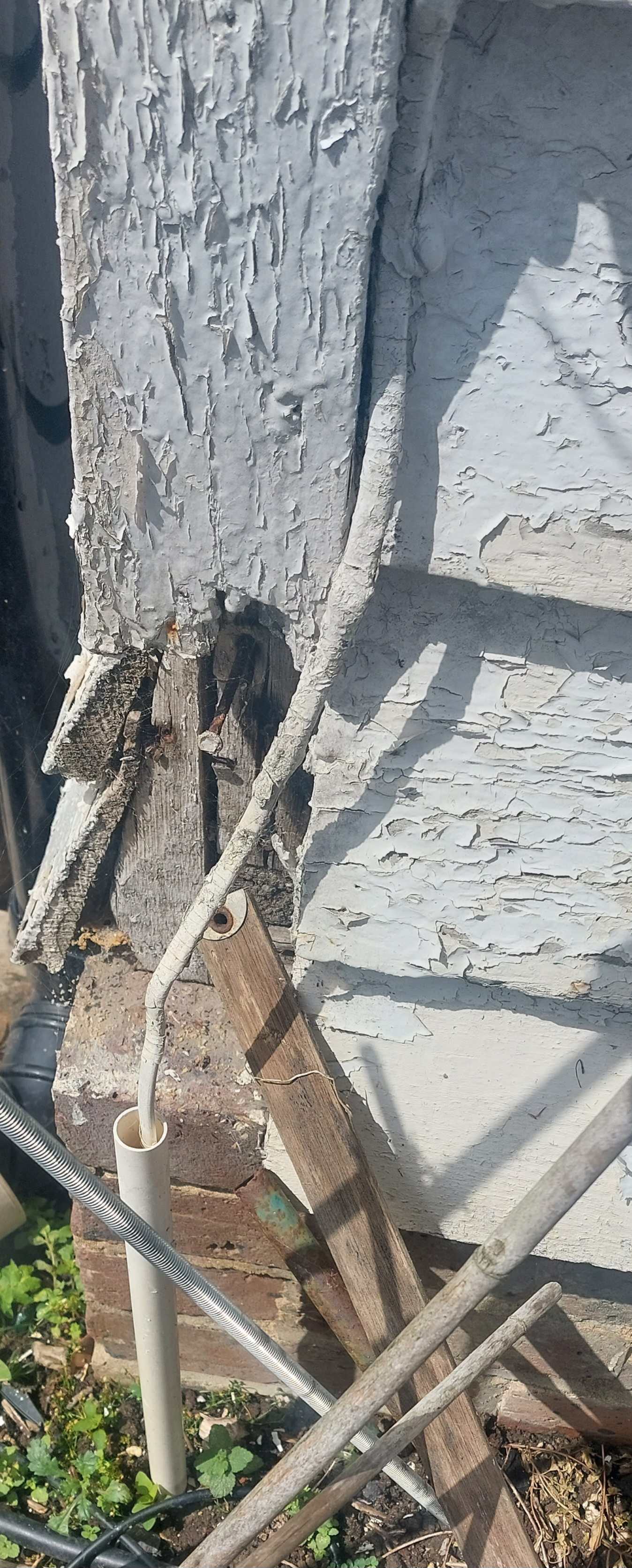

saveasteading Posted July 7, 2025 Author Posted July 7, 2025 Thanks. And you even anticipate the reason for doing this. There appears to be a fault in the underground cable as it fails in wet weather. It must be 30 years old and prob put in by ultra-amateurs / as cheap as possible. It used to work a 250W floodlight but is only about 30W now with a replaced light. I suspect the underground cable is domestic, indoor, 3 core, so intend to replace it with armoured from the post that has the light, to the house wall. Here I will put the new switch. Perhaps good practice also dictates a junction box? I could just join the existing cable but it has been in the sun and weather for decades. So I then intend to take a 2.5mm domestic cable into the house and there make a new connection (it is in the attic so easy to access and adapt.) I would encase that outside cable in ducting. Tracing the existing indoor cable back to the indoor switch is likely to be very convoluted and messy. It is a 3 gang switch at the front door, operating the lobby, an adjacent outdoor wall light and the distant light which is the issue. Just one of these

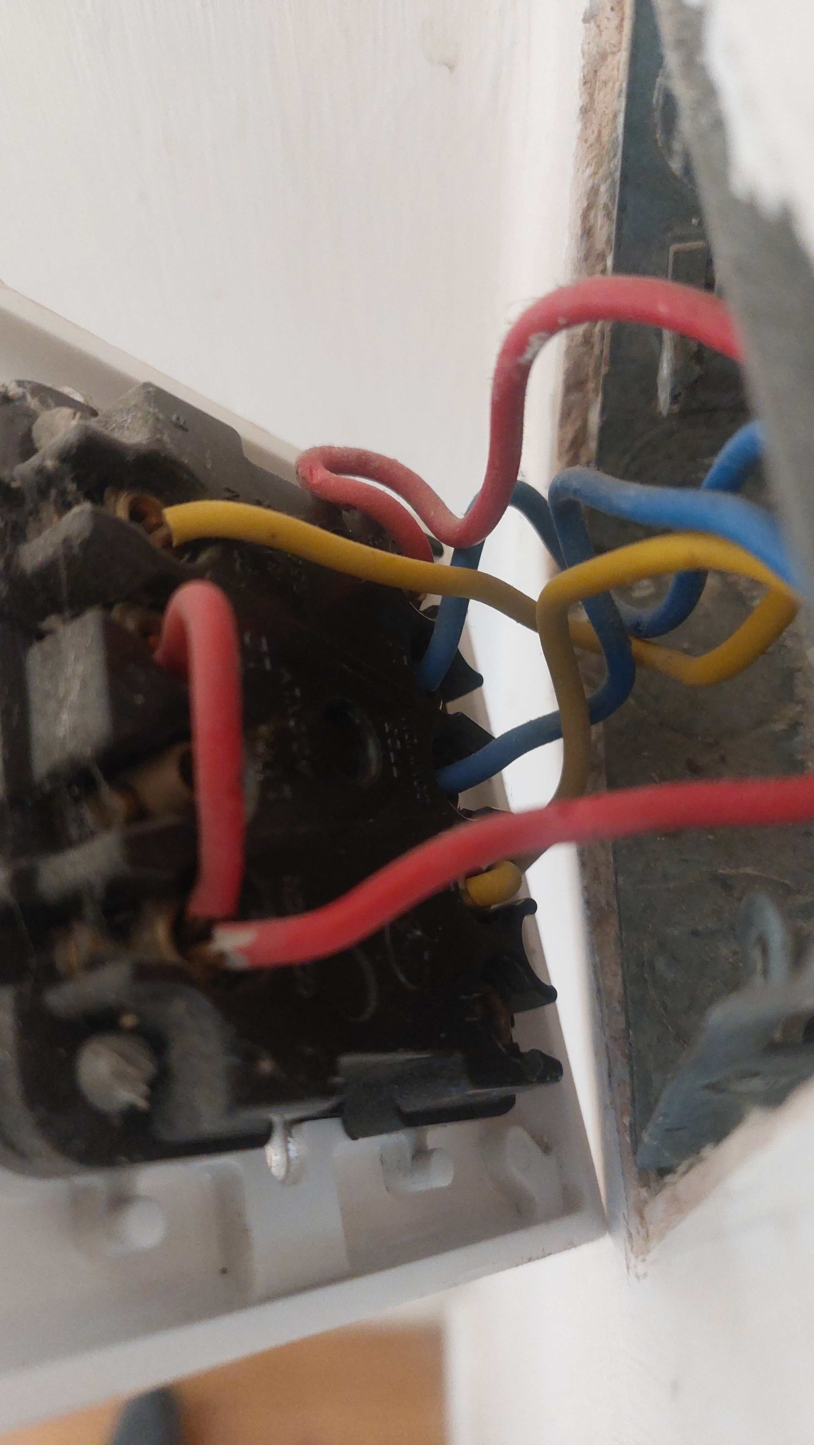

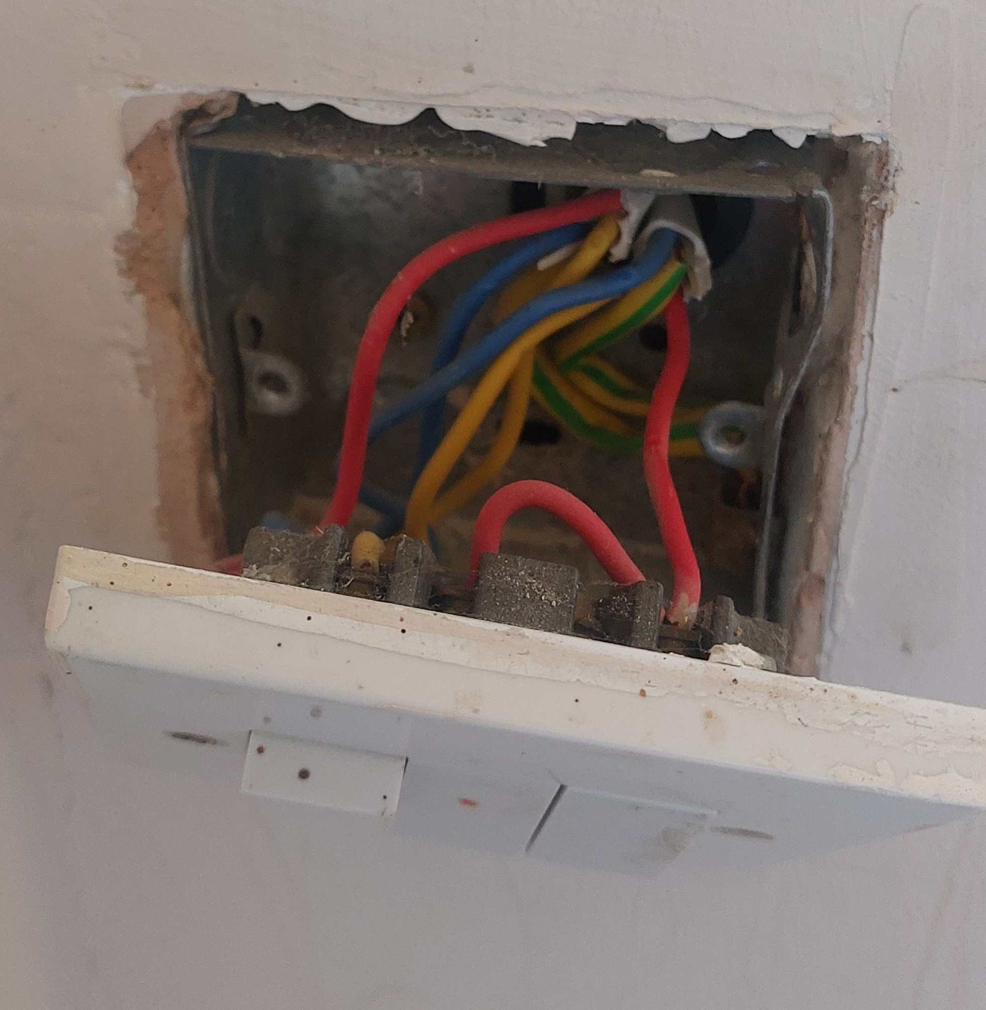

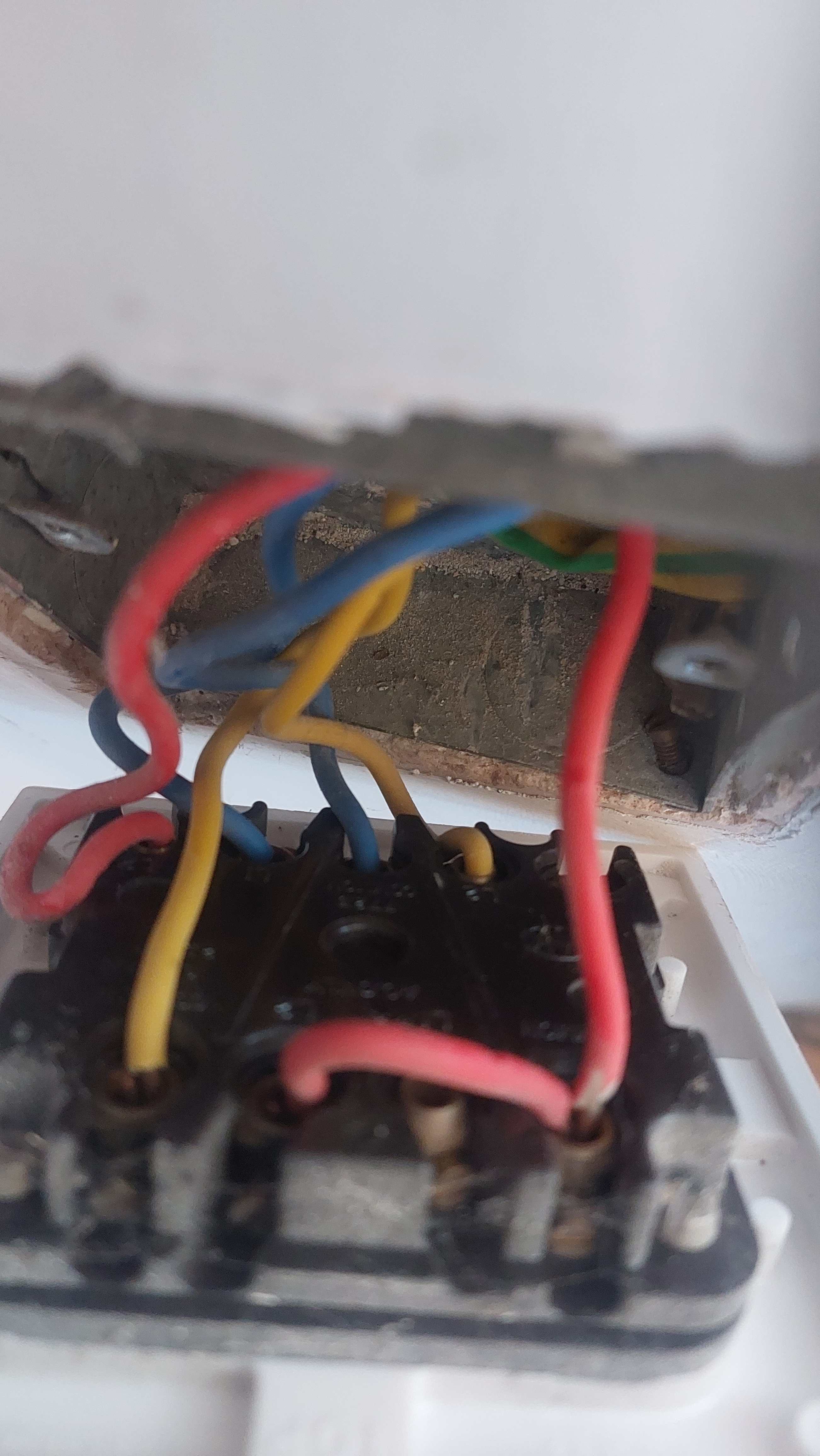

saveasteading Posted July 7, 2025 Author Posted July 7, 2025 Here is the existing treble switch. Very congested, so I hope you can "read" it. To complicate it, the left hand switch is 2 way. AND in turning off fuses i find that the right hand switch, the one that does the floodlight in question is on a different circuit to the other 2 switches. And yet I only see 2 cables.... over to you Mr Electrician.
ProDave Posted July 7, 2025 Posted July 7, 2025 The left hand switch is definitely wired for 2 way, Red, yellow blue of one cable. That may well be on a different circuit. The middle and right switch are on the same circuit and connected to the second cable. Red is live feed looped to middle and right switches, blue is switched output from middle switch, yellow is switched output from right switch. The complexity of your alteration has just gone up somewhat. There are no junctions at the switch so it is either wired "loop at light" or quite likely spider fashion where everything goes to one great big junction box often in an unknown location. Apart from locating that junction box, your biggest issue is no spare cores in the existing cables to use for the 2 way switching of the outside light. At this point I suggest you find an electrician, this might be beyond remote diagnosis on a forum. Somehow you are going to have to get an extra cable to that switch and it looks to be plastered brick or block so that means chasing a new cable into the wall and the re plastering and decorating afterwards. If you choose to proceed I would install a new cable and wire the entire outside light as a complete new circuit.
saveasteading Posted July 7, 2025 Author Posted July 7, 2025 OK thanks. Understood. But if I have a cable that clearly works, including the switch, can't I simply find a nice condition part of it in the attic and join a new cable to it? I appreciate it's not perfect or professional, but will be much better than what is here now, for the interim. And circumstances do not permit pulling down walls and ceilings at present. I have spoken to a couple of really sound electricians and they want to spend thousands on exploratories, tests and rewiring. And of course I'll still end up putting the swa in. My interim switch idea was partly so that I can do this diy bit, while ensuring it is ready for a proper job when funds and circumstances allow. ie new swa cable 25m fixed to post and wall. Switch. Short (7m) cable from switch into house, joining to the existing in a new junction box indoors. That will be much easier to handle too than 32m swa. Then later the link from there can be surveyed and completed. Which doesn't resolve my original question ..what is the outdoor switch called? 3 wires in, 3 wires out I assumed. Or it is live in and out of the switch, and join the neutral ends within the box? I've looked at screwfix and other specs, and instructions within the switches I have already, and indeed they throw around the terms switch/gang/ way/ pole as if they are interchangeable. @joth thanks to you too. The circuit you show doesn’t apply as my existing is a simple switch. But I think you havd provided the beginnings of an inkling of how L1 to Com works and doesn't go bang.

saveasteading Posted July 8, 2025 Author Posted July 8, 2025 9 hours ago, ProDave said: continue using the cable going through the house That was the plan. I should have explained better at the start... in series. @-rick- the issue is with thd power cable being faulty. The fuse trips afteg heavy rain. I'm still none the wiser about what outside switch to buy. This is top of the search from screwfix. Same words as @ProDave used earlier. British General IP66 20A 1-Gang 2-Way Weatherproof Outdoor Switch with Neon (54649) Will I need to tie the neutrals together inside it? What is one if those wind- on plastic caps called? Presumably this switch is OK for swa. One more question. 1.5mm2 swa costs £43 for 25m . 2.5mm2 costs £53. Any reason not to invest that £10 in case of future upgrades?
