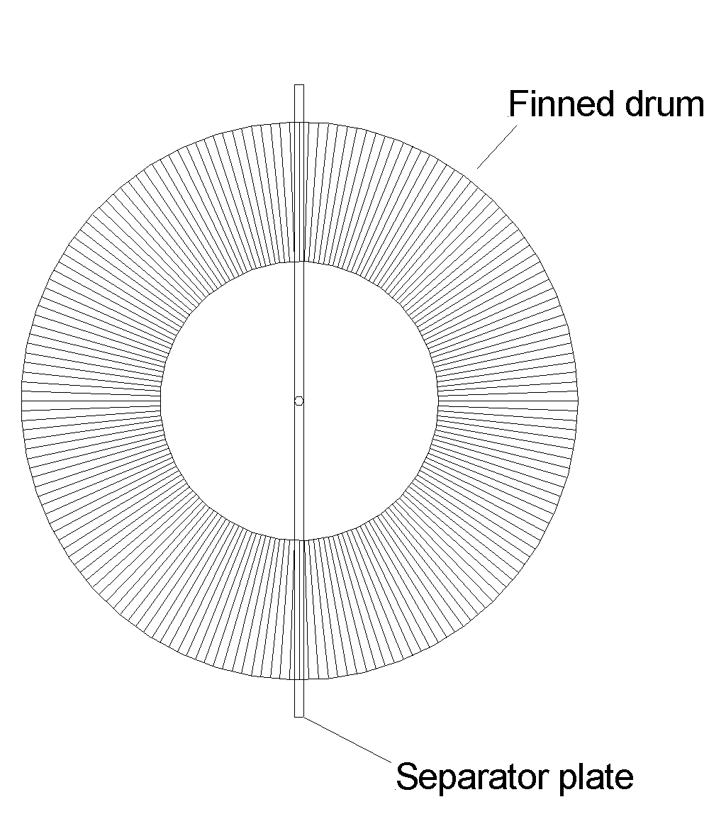

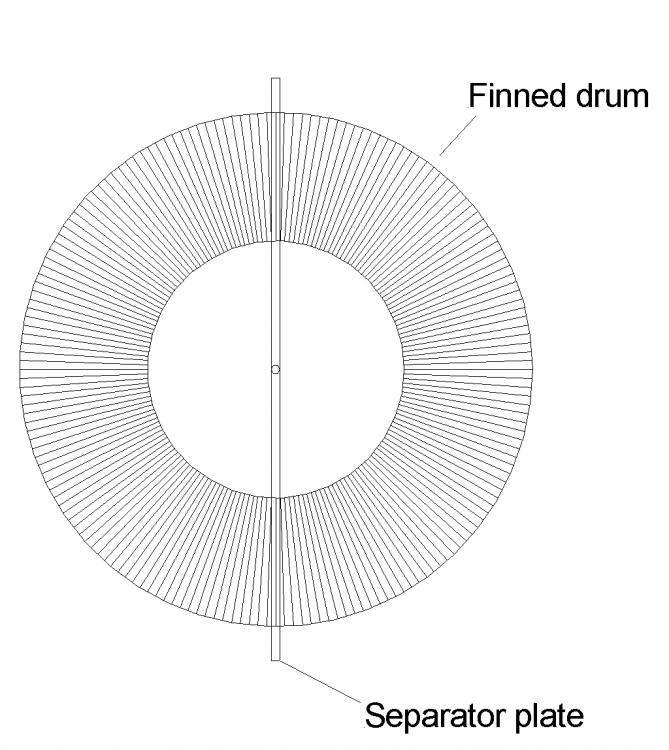

The ones we had on the roof our the new lab building had drums a bit like this inside (a very quick and dirty sketch):
The drum rotates very slowly, with warm, extracted, air passing through one side of the separator plate and warming up the aluminium fins.  When these rotated around to the fresh air input side, they gave up their heat to the incoming fresh air.  There are two basic topologies, the radial design like this, which is easier to seal, or a design made from a stack of thin discs, with seals between each disc.  I've seen both and from a DIY perspective I doubt there's much to choose between either.  You can make the disc type physically smaller to get the same heat exchange capacity, as you don't need such a big hub, and you may well be able to find a company that will cut out discs with central holes pretty cheaply.  Something like thin brush seals would work between the discs; the friction losses would be small because of the low speed.  You may even get away with just thin barriers not actually touching the discs and relying on the low pressure differential to adequately seal.
The key is to adjust the speed so that just as the drum rotates past the separator plate (and not before) the fin/disc is as close as possible to the temperature of the extracted air, that then ensures that the unit operates at the best possible efficiency.  This has to be balanced with the airflow to ensure that just as the fresh air side fin/disc crosses the separator plate it has given up as much heat as it can, i.e. there's a very small Δt between the air going to the rooms and the fin/disc temperature at that point.

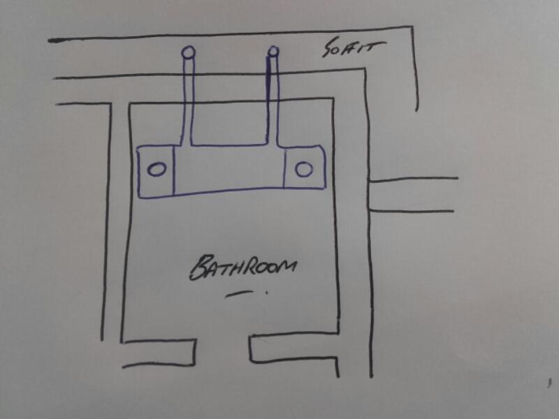

What would be the advantage of using your stuff over say soil pipe fittings for the outer tube, drain pipe up the centre and encasing the lot in "insulation". I'm thinking whether I could do a hairpin or otherwise cranked design up in the loft. NO idea btw where to start!

3 minutes ago, PeterW said:
Drain pipe has 1.5mm plastic wall -  heat transfer would be negligable.
So you need a thinner wall?  Just edited my post btw with more info.
The room has a minimum fan size / extraction for building regs and you have that big F/O body fan that will over power anything in that room ...
I can’t see any value adding any MVHR to the setup currently, other than a basic wall mounted one that will have much greater efficiency in a smaller box.
Air to air heat exchanger membranes are measured in microns not millimeters for good reason - to maximise heat transfers.  Thick pipes would be ok with a water to water heat exchanger but still, it’s not ideal.

Just to confirm, we're talking about the housing for something like this:
Heat exchange is via the internal pipes, which would likely be the size of drinking straws.
110mm drain pipe was actually my first thought for the housing, and has a few additional advantages including the availability of fittings and the fact that it won't retain any condensation that might lead to mould. My initial thought was that it wouldn't be big enough, hence my suggestion of something larger, but now that I think about it, it's only for a single room, so I expect drain pipe would be fine.
That said, I agree with @PeterW that this is a solution looking for a problem. You'll need a lot of ductwork (two full paths: in and out), plus two fans, and somewhere to drain condensate to. Seems like overkill for a single room.
So a structure of drinking straws inside I now get, but how you would support and seal that whilst still maintaining flow would be a challenge. I’ve built a couple of contraflow copper heat exchangers and they are hard enough as you can pressure test them to find leaks ..!
When do I ever listen? :)
Any excuse to play with the junk I've got here!
Would 15mm copper pipe do for the "drinking straws"? Appreciate they're a bit bigger! The layout and runs maybe work?
It'd be dead simple:
Soffit is close by, easy condensate run to.
Have I got the shell & tube inlet/outlets in the right position?
Is it ok having the inlet and outlet in the same room? Could drop straight through the ceiling from the main tube.
I could load it with sensors to try and gauge the efficiency.
