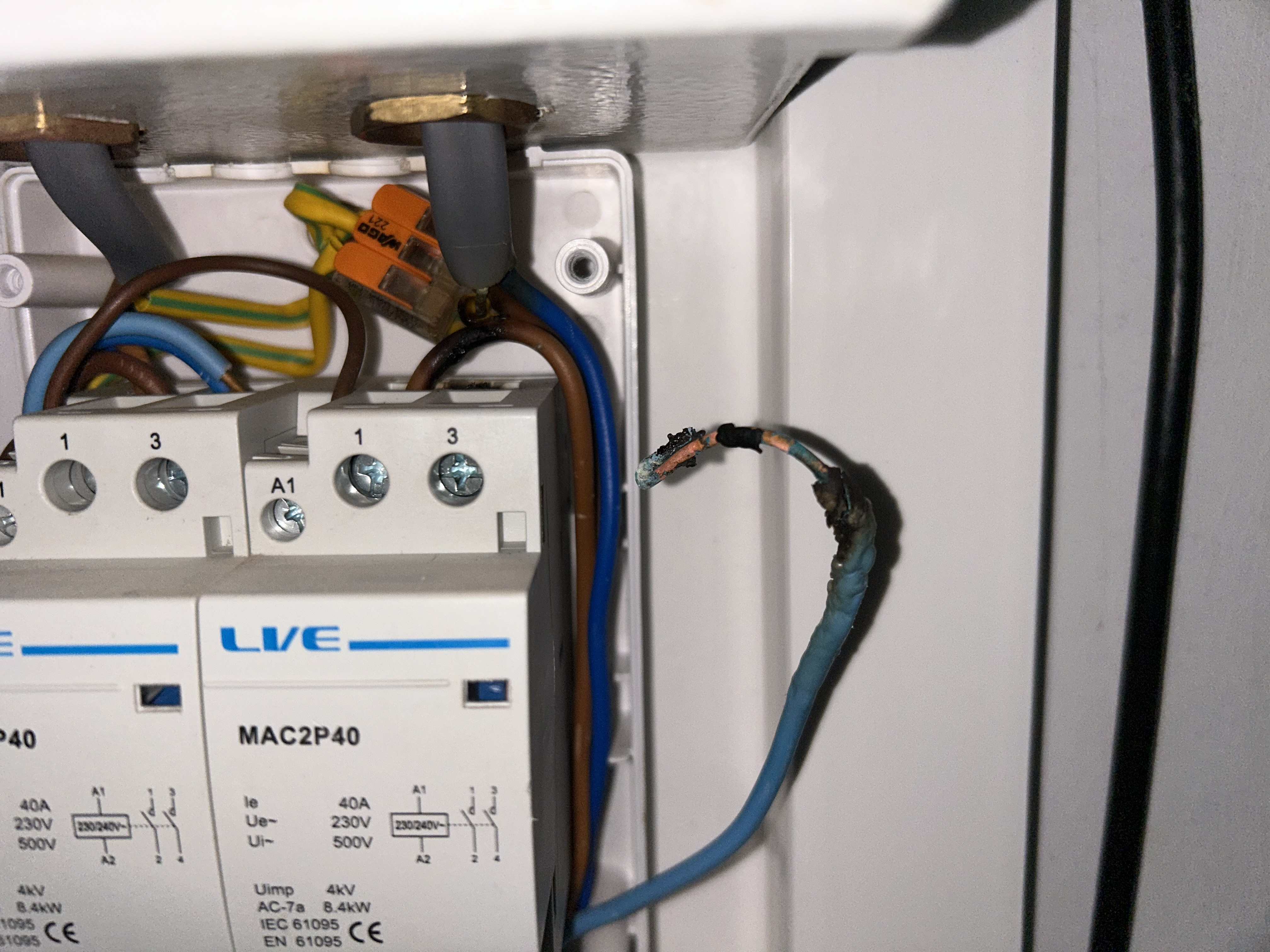

Loose wire - bullet dodged.

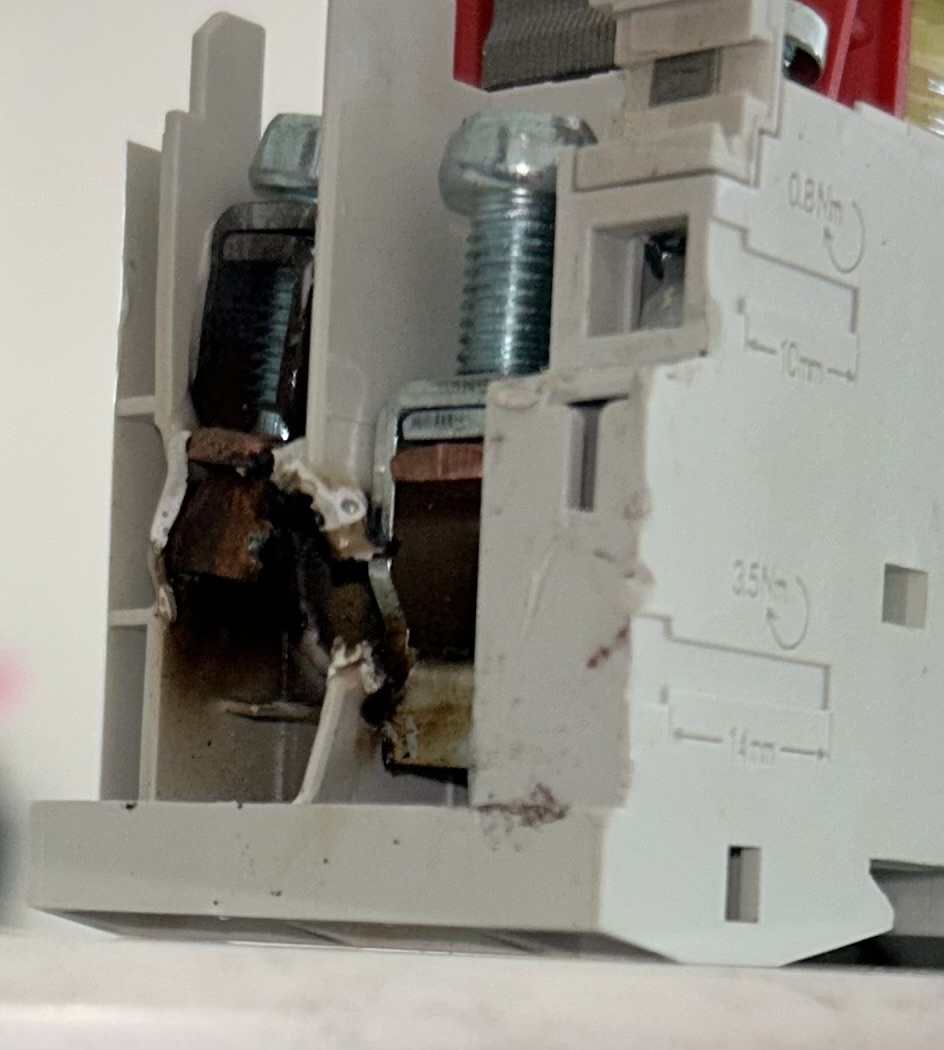

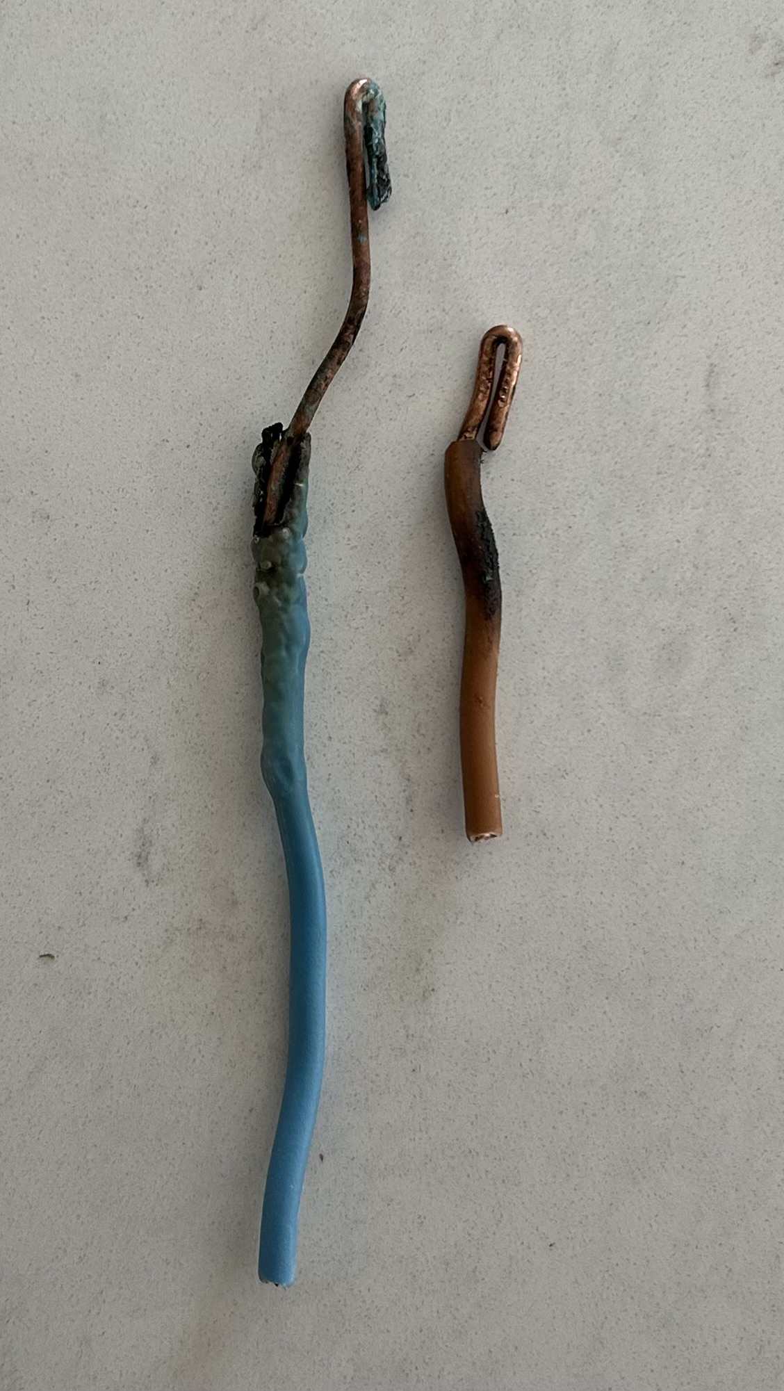

During my mid year service of the house it turns out that the second Willis Heater we hardly ever use doesn’t work anyway. After a bit of investigation it became pretty clear why that was.

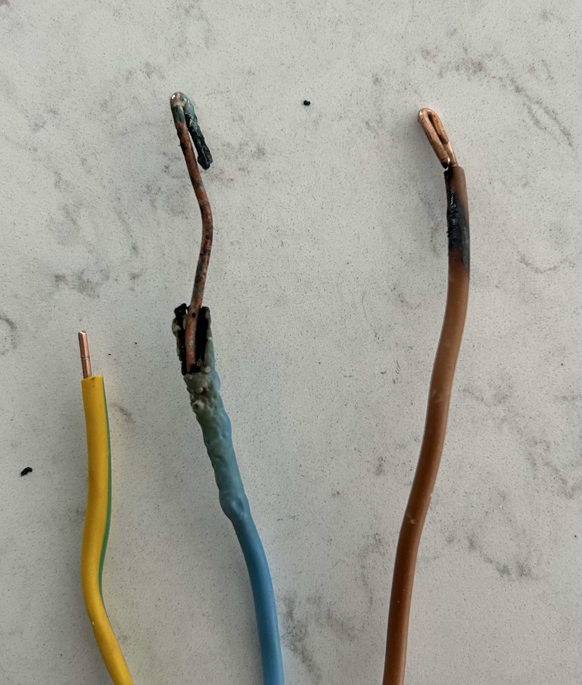

The neutral from the Willis Heaters fused spur into the contactor was trying to catch fire, it had actually melted and stuck to the outer casing of the junction box.
The neutral was in the right hand No.3 terminal - kinda.
I found that pretty disturbing, especially as there was no indication of when this had happened (nothing tripped off, no smoke alarm) or how long ago it happened.
On closer inspection I think it’s clear what has happened, the terminal screw seems to be cross threaded so I guess it felt like it was done up tight but clearly it wasn’t.
Stuff clearly needs replacing, like the contactor and the Wago.
The obviously burnt twin and earth needs replacing, can I just cut out the burnt sections and splice in new cable with these?
Or should I replace the whole length to the fused spur?
The T&E appearing above the contactor is directly from the distribution board and looks slightly heat damaged, I guess that all needs replacing as well?

If you can replace the whole length why wouldn’t you do that?
Good point, I’ve not had a good look at what that would entail, replacing the T&E from the contactor to the fused spur, but I suspect I could do that with relative ease.

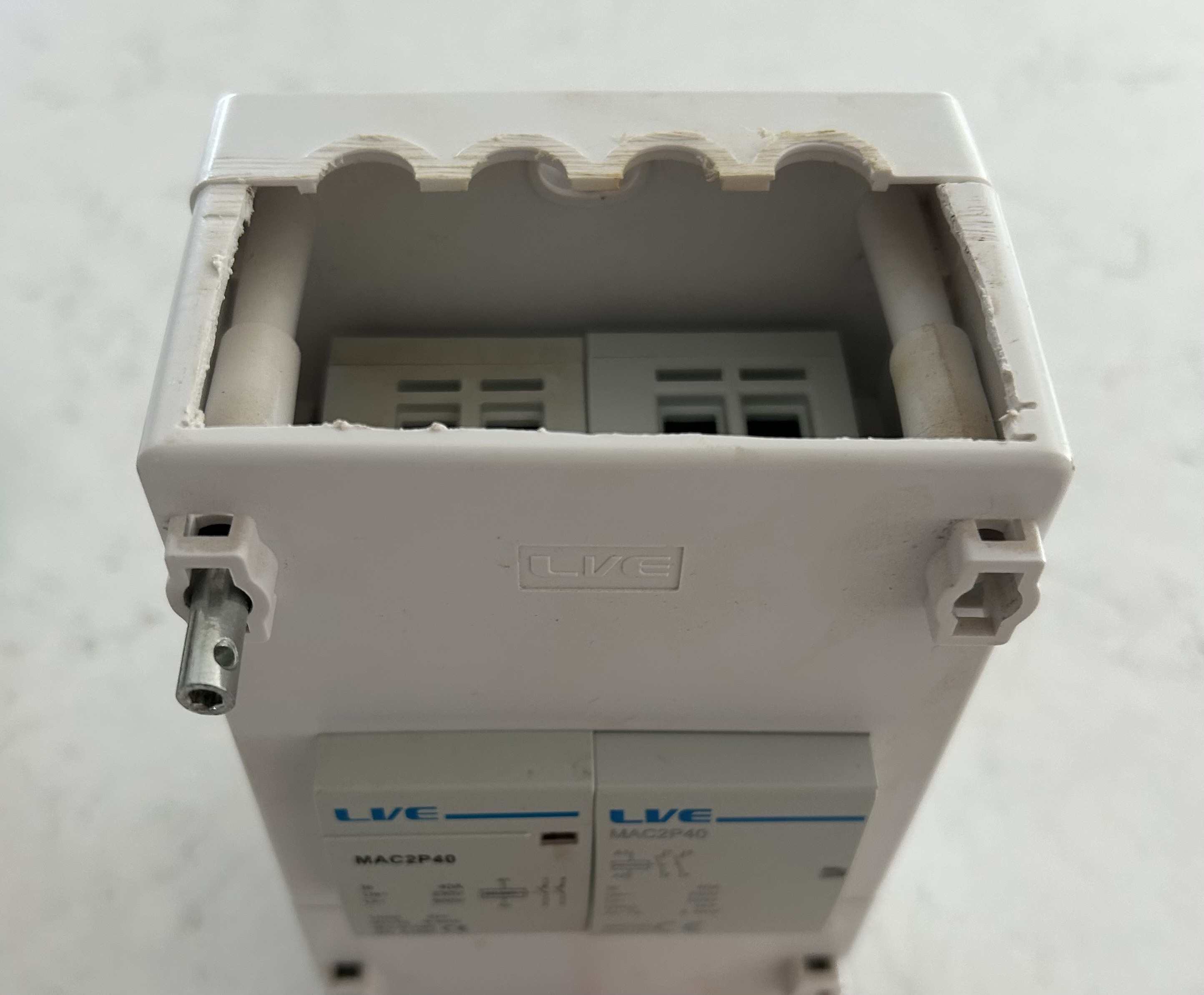

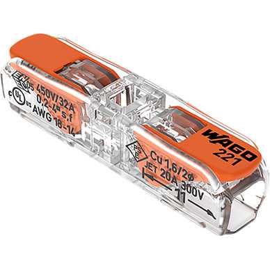

I would not hesitate having a junction inside the contactor box.
Just so I’m clear on that advice you say the Wago would be fine?

If you are replacing the damaged contactor (bad screw) - you're doing that! - then replace the whole T&E at the same time.

Don't be too afraid.
Photograph what you are going to replace, particularly connections.
Turn everything off, then check nothing is live.
Replace the cable.
Replace the connector.
Make the connections (refer ro earlier photos)
Tighten and tug test.
Apply volts.
You got this

That contactor did get really hot. How come nothing tripped off? Is that indicative of other problems?

The terminal screw is at such a jaunty angle I can’t even get a screwdriver on it. The electrician must have been aware what was happening. Surely?

The contactor and wire got hot because the connection was not secure so created a resistance.  Current passing through a resistance creates heat.  The total current flowing would be less than if the connection was perfect so no chance of over current trip operating.  The current still flowed Live to Neutral so no chance of tripping an RCD.
The only thing that might have detected that is an Arc Fault Detection Device.  Their uses has been discussed but not presently a requirement.  Lots of th discussion has been on false trips, i.e. they are not regarded as reliable devices.
Normally one's nose detects these things, if you smell and odd smell go looking for it's source.

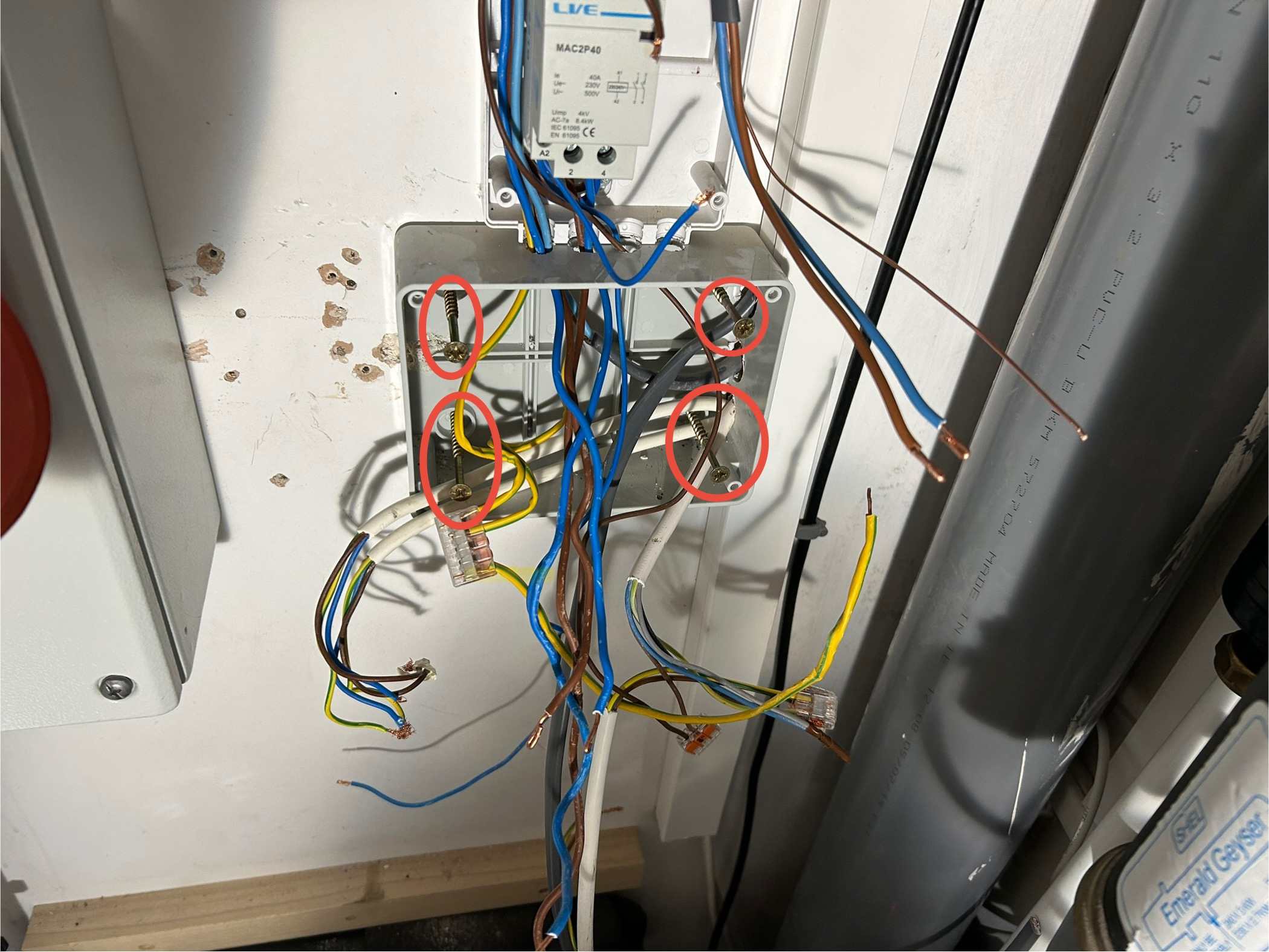

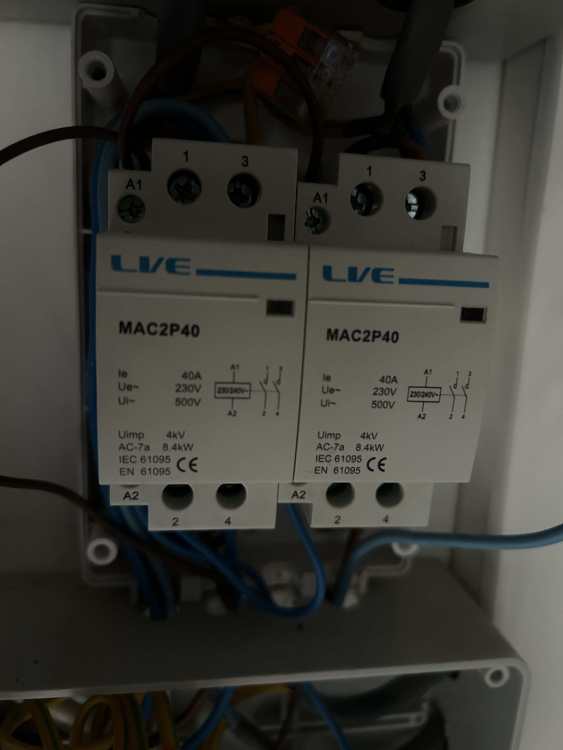

I thought I’d try and tidy up the numerous cables in and around the contactor whilst I await the arrival of the replacement.
It looks like the electrician used a machine gun to attach a couple of back boxes to the plasterboard during the original installation and then used some bloody great big screws to attach the junction box. At 70mm those screws are just the right length to go straight into the airtight layer. Nice.
None of the above is the end of the world but on top
of the poor/dangerous contactor installation it is mildly annoying.
Anyway, all the heat damaged T&E is now replaced so I’m pleased about that.

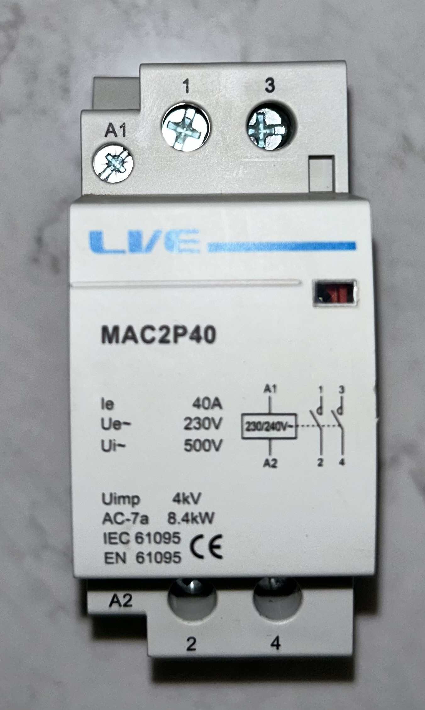

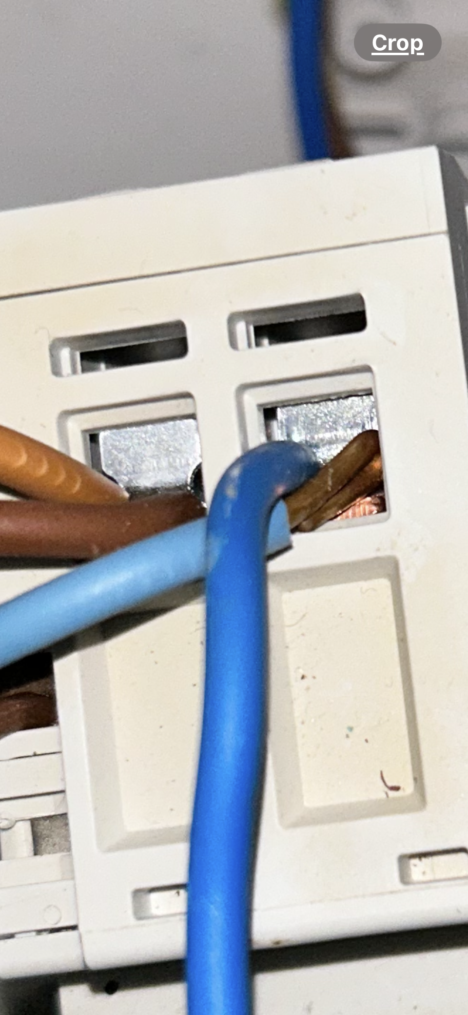

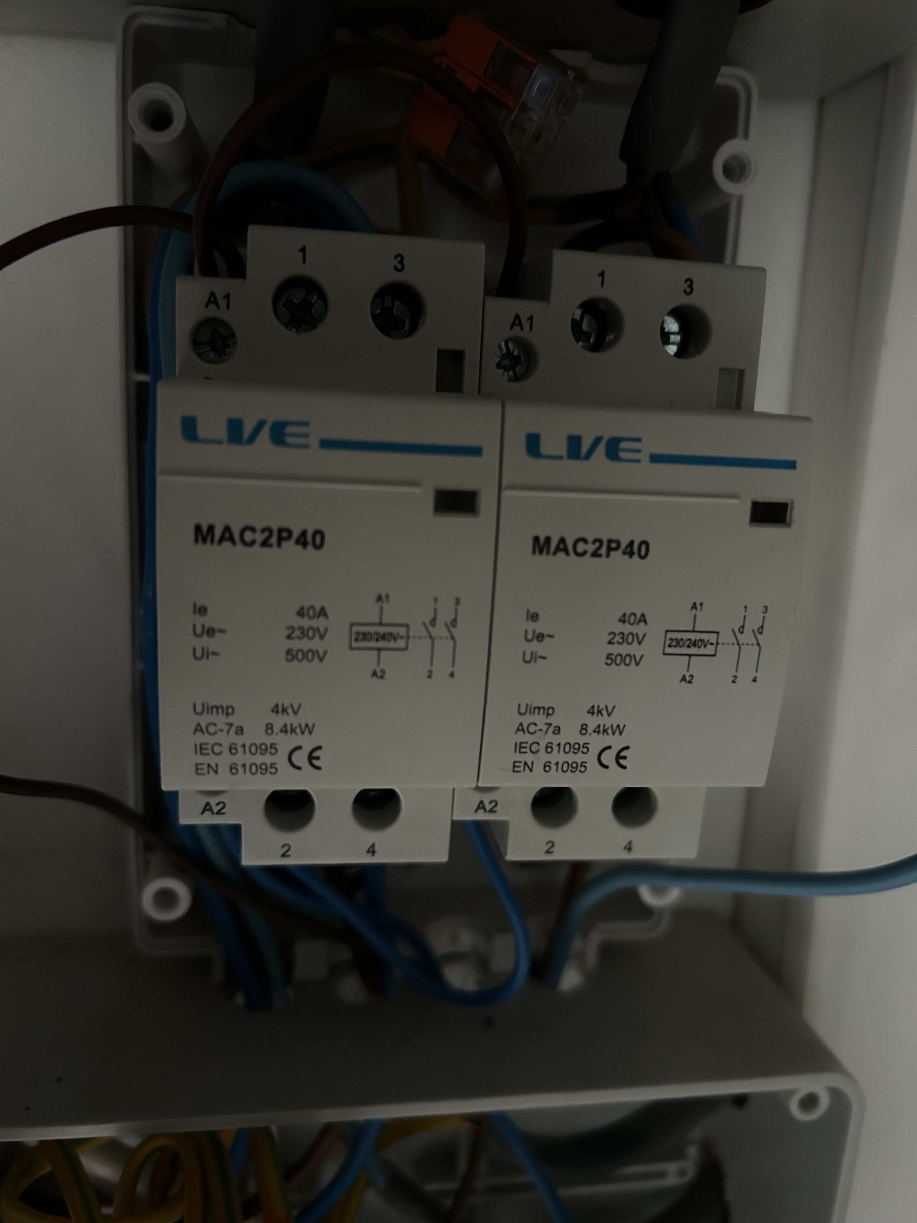

I’m amazed and confused. I’ve just removed the good contactor and was stunned to find the neutral for the Willis heater did not appear to be connected at all, and this is the one we normally use.
I thought I may have dislodged it but looking back at a photo from a week or so ago, despite the shadow I think it’s fairly clear to see that the neutral is not properly inserted into the terminal.
How on earth did this Willis heater work?
I guess the neutral must have been just inside the terminal and just tight enough to stop overheating but not tight enough to stop it coming out completely when I removed the contactor?
The holes are where he went probing to try and find a stud, and the long screws are because he didn't have any plasterboard fixings.  All speculation of course.
That folded back neutral, sat against the terminal...
IMG_5852.thumb.png.b9f447e44d36bc8edd37b411b777524c.png.c9e3905b68ebbd84b105e79365a5799a.png
Can't get much "looser" than that. The epitome of a high resistance joint. I would have expected to see it seriously burnt and crispy. But it's not...doesn't add up.
I had some MK light switches that were terrible for binding up.
Likewise, I’m confused.

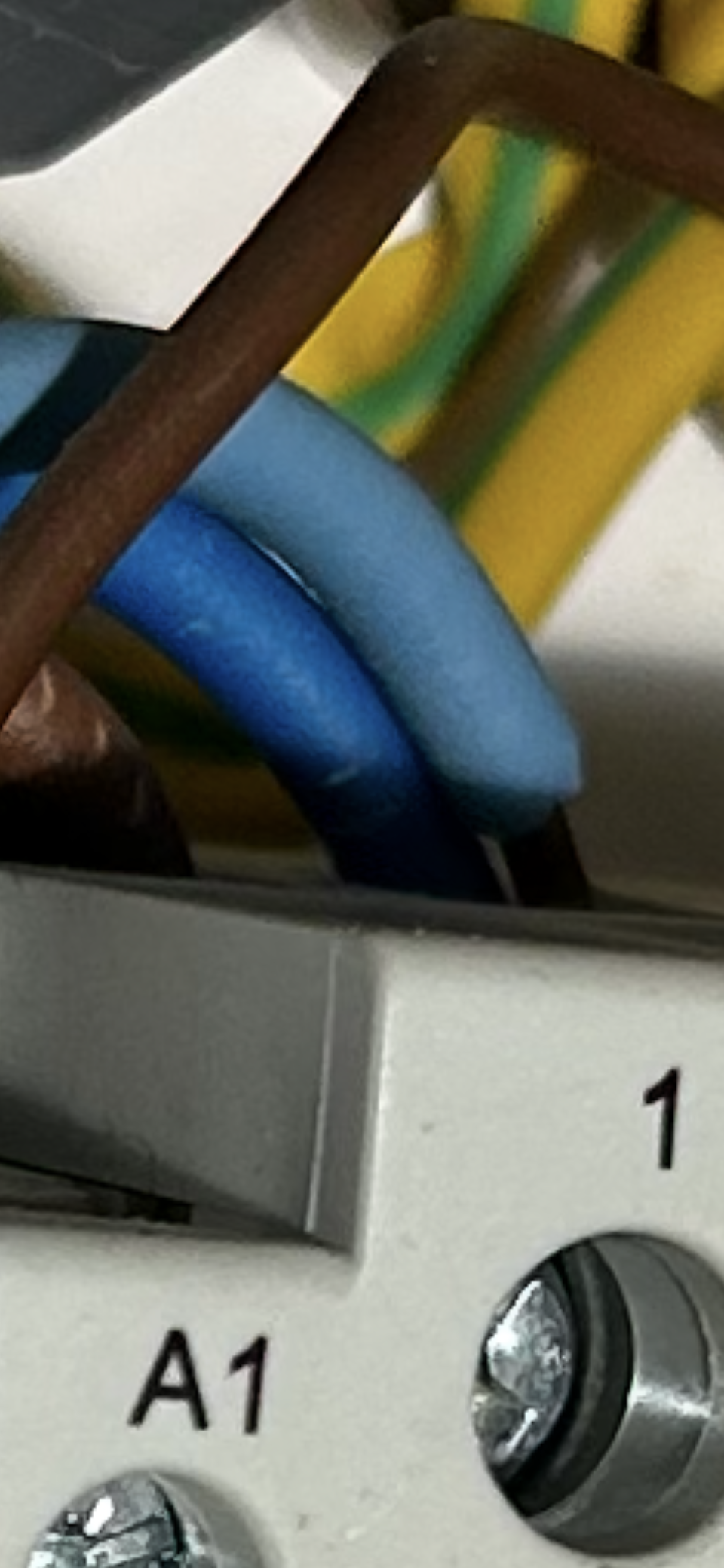

Something I hadn’t spotted before, in the first picture I posted on this thread ⬆️ where I was concerned with the overheating on the right hand contactor you can clearly see the light blue neutral into the left hand contactor is definitely not properly inserted.
I can’t understand how the Willis heater was working and, as you say, why that left hand neutral wasn’t all burnt and crispy like the right hand neutral?
are you sure the contactors aren't the "other" way round, or their stats set so that the "wrong" one is doing the heavy lifting?
No, I’ve replaced the obviously burn T&E and that ends up at the right hand Willis heater that wasn’t working.
I’ve got the new contactor now but before I start putting it all back together again is it ok that the top of the contactor junction box (for want of a better name) has been cut out?  I was under the impression this shouldn’t happen.
This open end is mounted snug to the distribution board, so it’s not open to the elements/fingers etc.
Well it’s all back together and working, nothing has gone bang and nothing (apart from the Willis heaters!) is getting hot.
I think I’ll chalk that up as a good result.

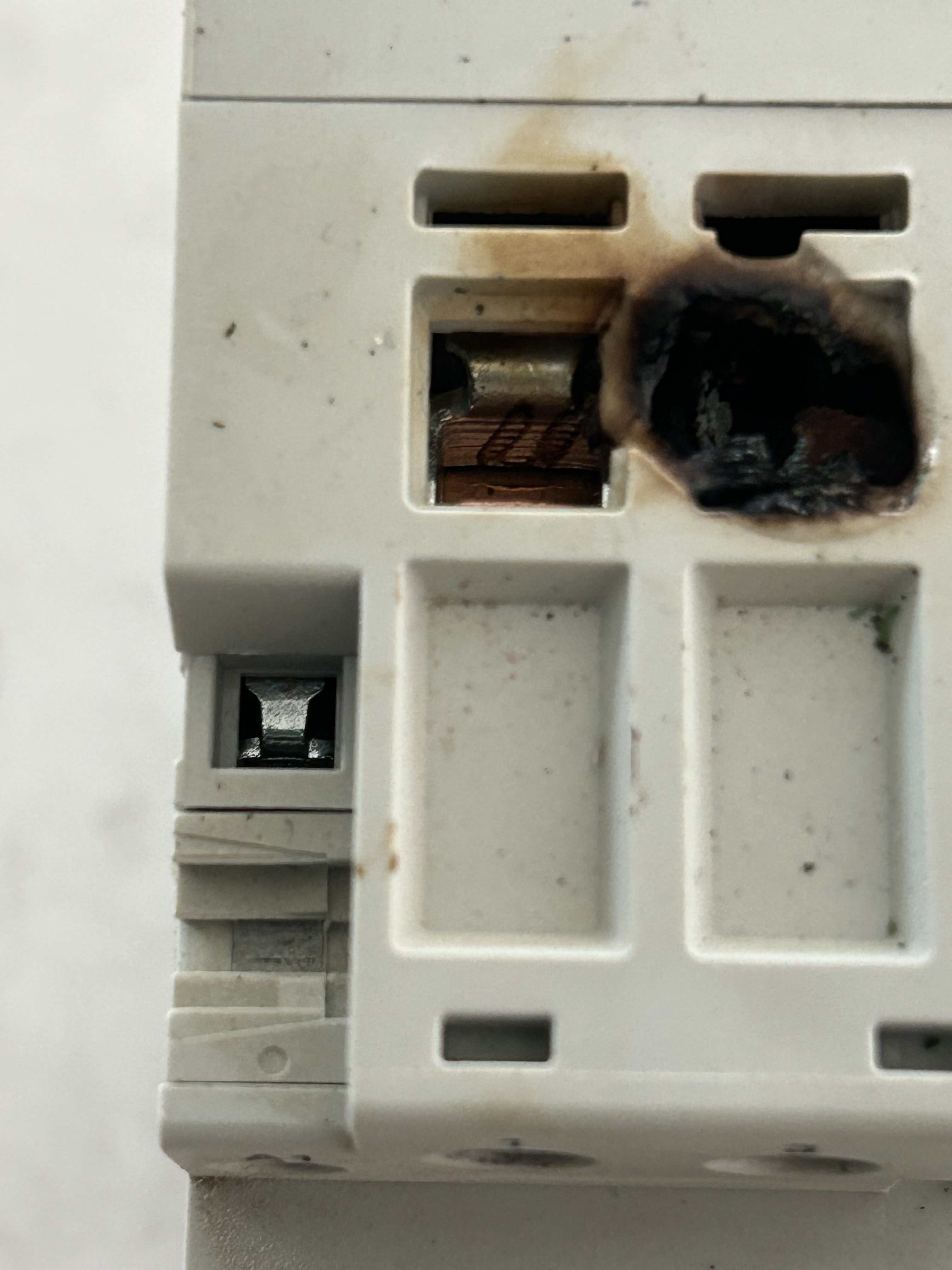

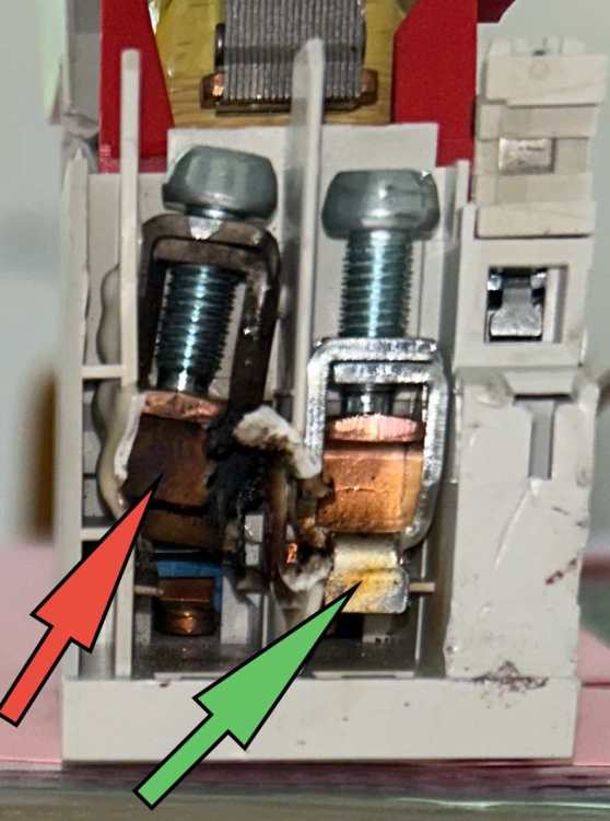

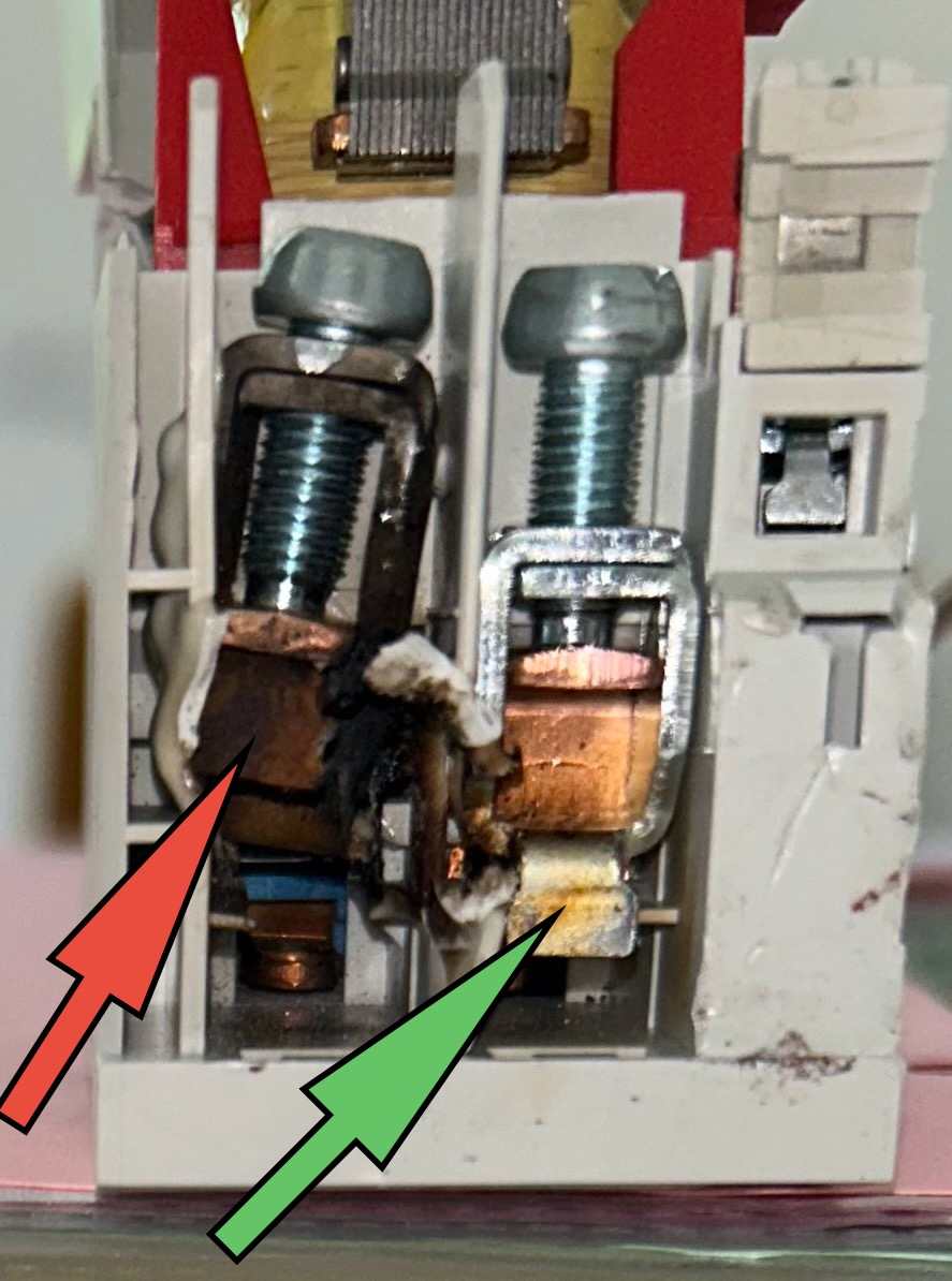

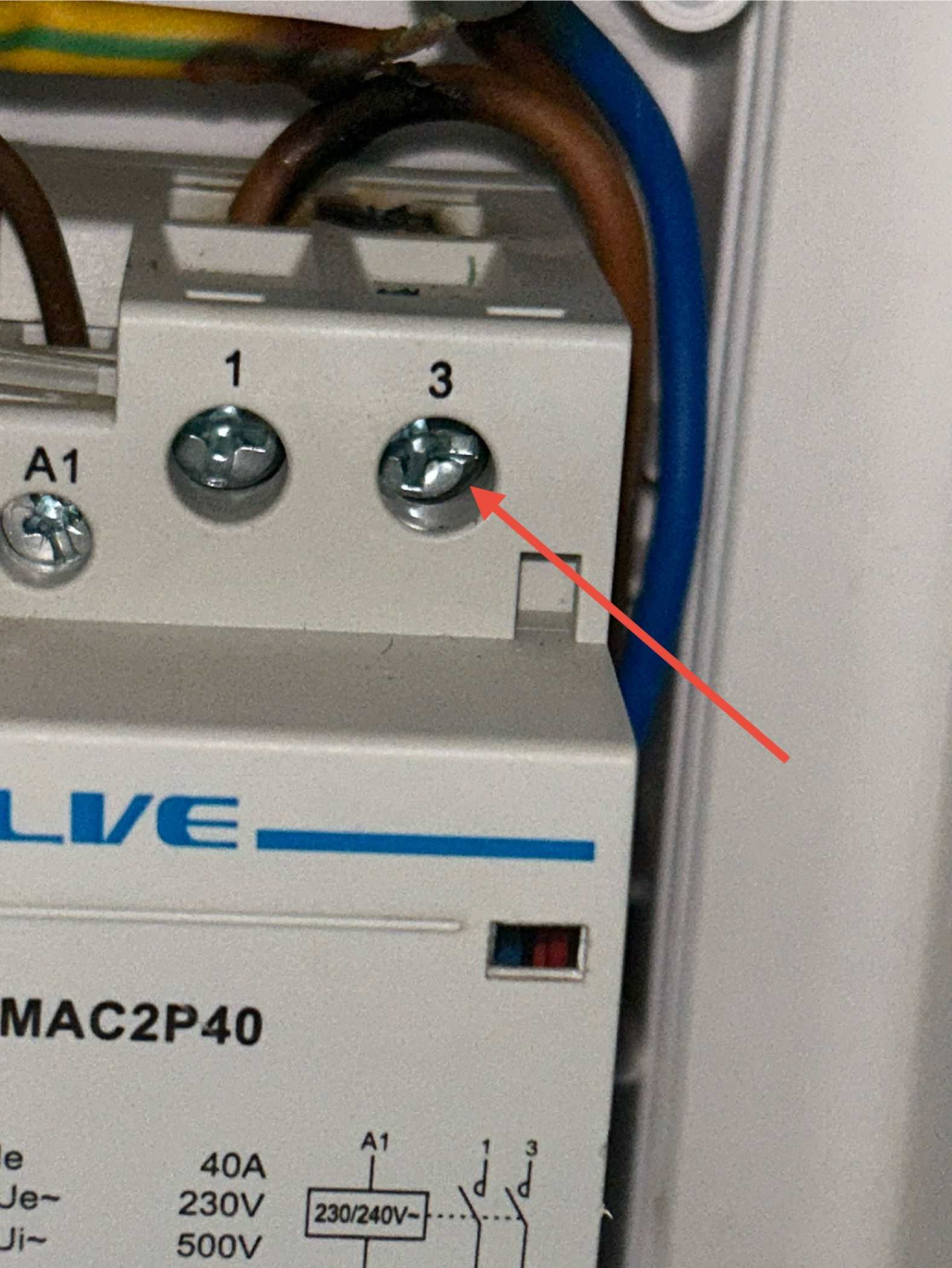

I’ve just pulled the damaged contactor apart, the burnt terminal is done up as tight as a tight thing - there is no way there was ever a cable clamped in there. It must have just been wedged along side or something?
The red arrow is pointing at the heat damaged terminal (obviously!!) in the fully closed position, the green arrow at a fully open terminal (with only minor heat damaged).
