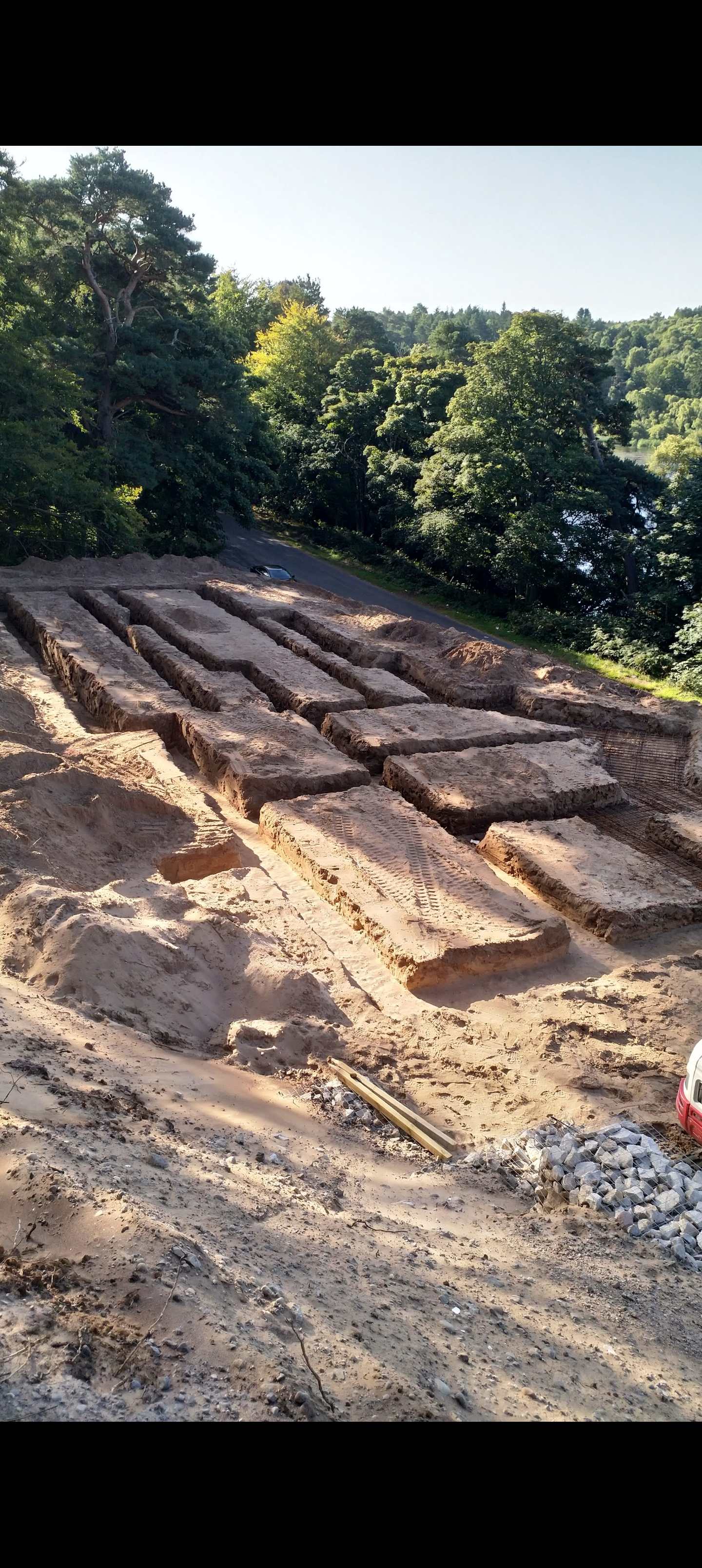

Option 1 is out, so leaves option 2.  Not enough space to move digger about, get some with a digger that knows how to use it. They will step the digger over trenches as they go. You are not going to any more space constrained than our foundation, top of image is a 3m drop to right 6 to 8m drop. All compacted sand. Left of image is a root protection zone digger wasn't allowed to enter.
Screenshot_2025-06-28-08-55-59-34_965bbf4d18d205f782c6b8409c5773a4.thumb.jpg.456f9f231a8b19d6f0779509c0b5546f.jpg

More of the district  trench runs allows the water to find fissures or areas of higher permeability. Eg ancient tree roots. Joiningbtgem all up, in any wat at all, let's it flow all over for temporary storage, thence to soak away.
Remember that gravel is 2/3 stone and 1/3 air or liquid.
Re big areas though, when you flush a toilet and 3 litres goes to digester tank, then 3 litres comes out. That will usually disappear in the first few m of drain and will never reach the middle of a big expanse of gravel.

I'm certain the single rectangular drainage field does not comply with the General Binding Rules or BS 6297.
Might it be permitted by the EA?
I'm not sure!
@Gus Potter and I have been discussing this in detail.
The resolution? Use the appropriate national building reg's and don't mix them. The other documents are guidelines even if better written and used as the basis for the national regs.
Without  checking, don't the GBRs say to work to the building regs?
To my mind, option 1 will work well but not comply. More pipes would make it comply.
Option 2, looks like the book says, except one trench may be too near to the bank.
Should we consider BS 6297 as just a guide when applicable to England and Wales?
There are conflicts - for example undisturbed ground between trenches. BS 6297 says 'equal to or greater than 1 metre'. Part H says 2 metres.

I'm designing for myself in this instance, and there is lots of ground. I'll make up my mind when I see in the trenches and test the porosity. A balance between the codes and my own opinion.
But if I was designing for someone else I would follow the codes , including taking the more cautious options, because
1. I don't want to have to come back to sort it.
2. There is professional liability.
3. What if it didn't work and esp if it overflowed into adjacent property?
With some clients I might explain, and share the risk/ benefit. With others I'd take no chances.
As @Gus Potter and I established, the regs take precedence but as professionals we would see that they had probably miswritten the regs and that the intention is clear.
Also as professionals we can decide on what is best. The regulations are actually the little green bit at the start and the rest is suggestions based on research.
Our drainage field is into what was once commercial orchard. I'm expecting the percolation to be very variable, depending on old drainage and voids created by roots. An average would be meaningless if the percolation numbers are say 40s/mm and 120s/mm.
What I expect to do is put in the smaller area of trench but have scope to extend it.
