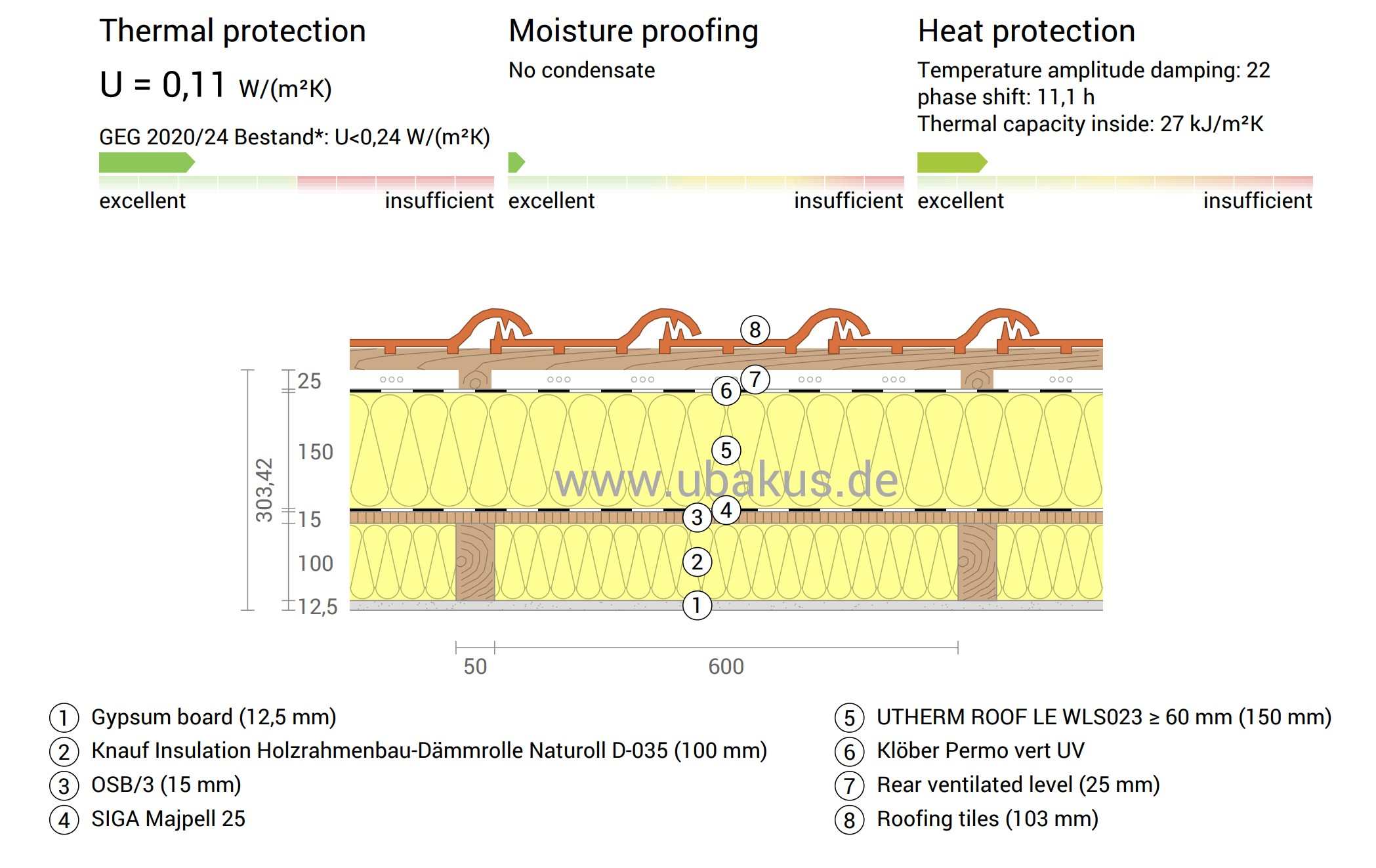

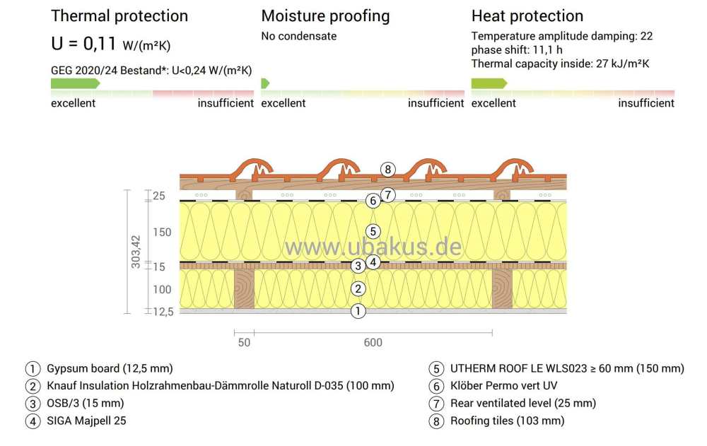

  1. Anyone with any success producing irregular shaped fields for awkward sites?
