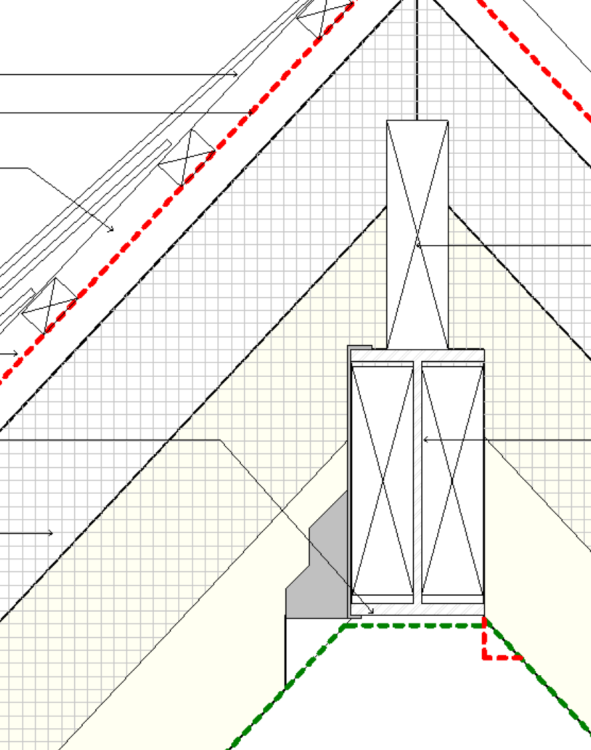

GEO-PAR Posted June 26, 2025 Posted June 26, 2025 Hi guys, I have a cut roof (ridge steel with timber fixed inside the flange, then rafters fixed to these timbers). I have just been told by S.E I cannot fix my rafters into the timbers inside the steels using 'skew nailing' and that it needs to be joist hung. Looking online, these varying pitch joist hangers seem crazy money? Like £5 plus per hanger? I found this product at a sensible price but it only goes to 30 degrees, whereas I have a 47 degree pitch roof: https://www.strongtie.co.uk/en-UK/products/ridge-rafter-connector-rr Anyone have any ideas? Cheers

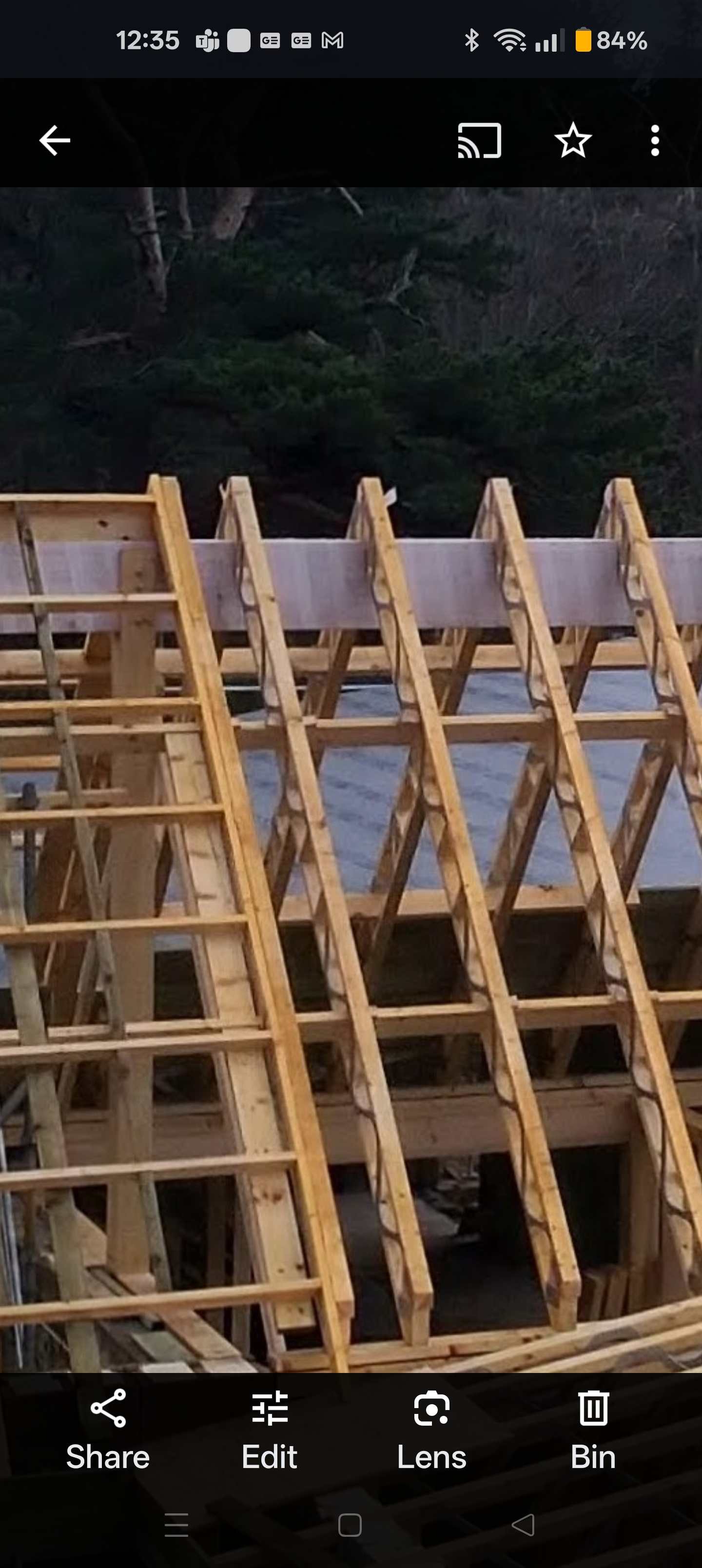

JohnMo Posted June 26, 2025 Posted June 26, 2025 Just looked at the photo of our roof our rafters go above the ridge beam. No hangers were needed.

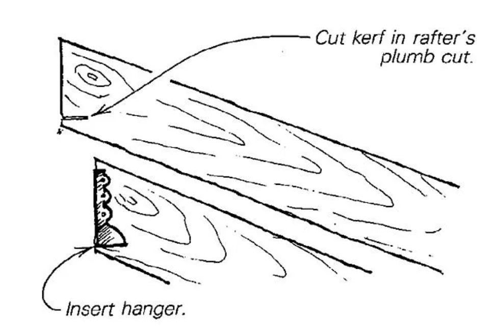

GEO-PAR Posted June 26, 2025 Author Posted June 26, 2025 (edited) Anyone's thoughts on doing this? Just using regular joist hangers and putting a cut in to the rafter? I guess it's one for S.E Edited June 26, 2025 by GEO-PAR

Temp Posted June 27, 2025 Posted June 27, 2025 22 hours ago, GEO-PAR said: Anyone's thoughts on doing this? Just using regular joist hangers and putting a cut in to the rafter? I guess it's one for S.E No don't do that. Some of the load tends to pull the rafter away from the ridge beam. Check with your SE.
GEO-PAR Posted June 28, 2025 Author Posted June 28, 2025 I sent this as a sketch to my S.E and he said it was fine to birdsmouth it to sit in the hanger? Yellow is the timber rafter.

SBMS Posted September 28, 2025 Posted September 28, 2025 On 26/06/2025 at 12:37, JohnMo said: Just looked at the photo of our roof our rafters go above the ridge beam. No hangers were needed. We had same roof design as you but roof manufacturer also specified hangers. Where were your rafters fixed into the ridge beam?
JohnMo Posted September 28, 2025 Posted September 28, 2025 1 hour ago, SBMS said: We had same roof design as you but roof manufacturer also specified hangers. Where were your rafters fixed into the ridge beam? They are a bird mouth at the ridge beam. Would have to go back through the structural drawings but believe they are angled nails.
SBMS Posted September 28, 2025 Posted September 28, 2025 23 minutes ago, JohnMo said: They are a bird mouth at the ridge beam. Would have to go back through the structural drawings but believe they are angled nails. Ah - We had the same birds mouth at ridge but pasquill insist on hangers as well! Think they did both in the end 🙄
JohnMo Posted September 28, 2025 Posted September 28, 2025 Had a look at the notes and they were held in place with framing anchors. Thinking back we were supplied with enough to build several houses. 1
