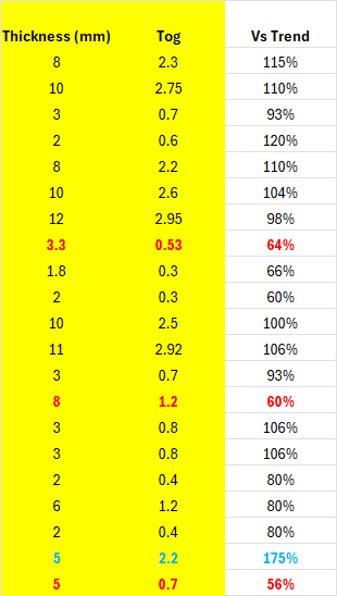

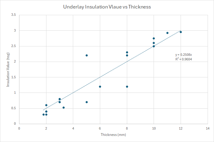

MortarThePoint Posted June 24, 2025 Posted June 24, 2025 We have some rooms with laminate (8mm or 10mm I think) over concrete screed with UFH pipes in so we want to have as little insulating effect from the underlay as possible. I found a useful table of underlay options [1] and have crunched the numbers to look for outliers that have below the trend tog values for their thickness. Graph below. The winners (QA TimberTech2 Gold 3.3mm x 0.53tog and QA TimberTech2 Acoustic Plus 5mm x 0.7tog) are both rubber. For those interested, the highest insulating outlier was unsurprisingly the Polystyrene one (QA FineFloor TechniBoard 5mm x 2.2tog). Not in the table, but Vitex Premium is commonly available (e.g. Toolstation) and pretty insulating at 5mm x 2tog so not good for me unfortunately. I'm nervous of something too thin as then it won't take out any small lumps and bumps in my screed which is pretty flat but does have the odd lump (max about 2mm high). Feels like 5mm would be a good option (thoughts?). For reference, the laminate itself is 0.73tog and 0.83tog for 8mm and 10mm respectively. This data obviously isn't complete so if anyone has a good suggestion I'd be grateful. [1] https://flooringwarehousedirect.co.uk/info-guides-advice/underlay-comparison-guide/

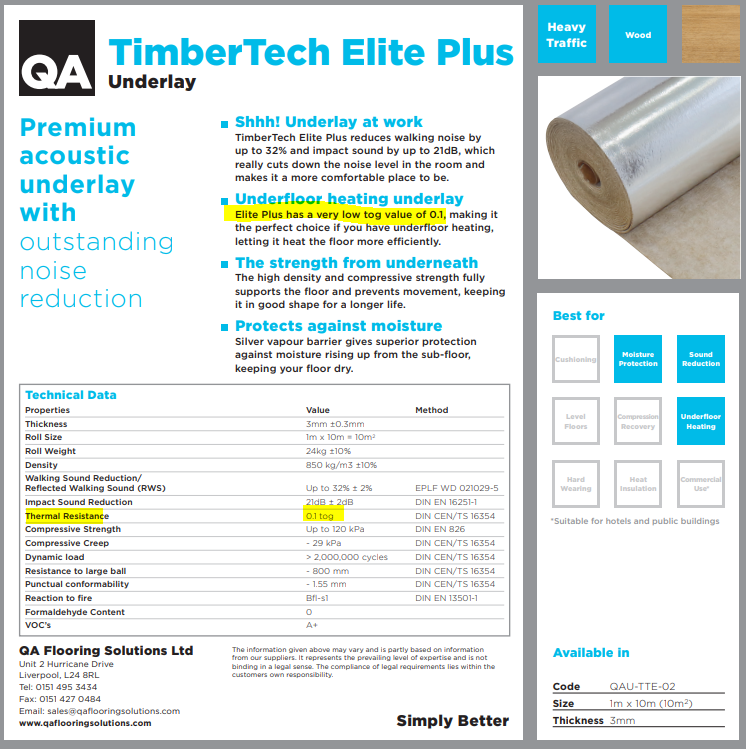

MortarThePoint Posted June 24, 2025 Author Posted June 24, 2025 This option is in the table but without a tog value. Looking at its datasheet it is a very good outlier (3mm, 0.1tog): https://flooringwarehousedirect.co.uk/product/timbertech-elite-silver-plus-foil-wood-underlay-10m-x-1m-x-3mm-10m2/
Nickfromwales Posted June 24, 2025 Posted June 24, 2025 59 minutes ago, MortarThePoint said: The painter is on site with his long handle wall sander. I wonder if he'd be game to give it a try? Expect a punch in the face....followed by 2 - 3 more. He may also go for a swifty to the nut-sack. I'd just shoot you for suggesting it. But yes, go ask him, I am keen to hear his response 2
Nickfromwales Posted June 24, 2025 Posted June 24, 2025 1 hour ago, MortarThePoint said: This option is in the table but without a tog value. Looking at its datasheet it is a very good outlier (3mm, 0.1tog): https://flooringwarehousedirect.co.uk/product/timbertech-elite-silver-plus-foil-wood-underlay-10m-x-1m-x-3mm-10m2/ No. No. And thrice, No. Just NO. You have UFH!!
MortarThePoint Posted June 25, 2025 Author Posted June 25, 2025 7 hours ago, Nickfromwales said: No. No. And thrice, No. Just NO. You have UFH!! Oh, are you suggesting I have no underlay and use something that can be glued straight to the screed (or feathered) surface? If it's to be believed, 0.1 tog is the difference between 8mm and 10mm laminate, so wouldn't rob much heat. Anything that could be bonded is likely to be thicker. As an example, 14mm engineered oak is 1.13tog. that's the same as 10mm laminate plus 0.3tog underlay. Or are you suggesting something like glue down LVT would be a better choice?

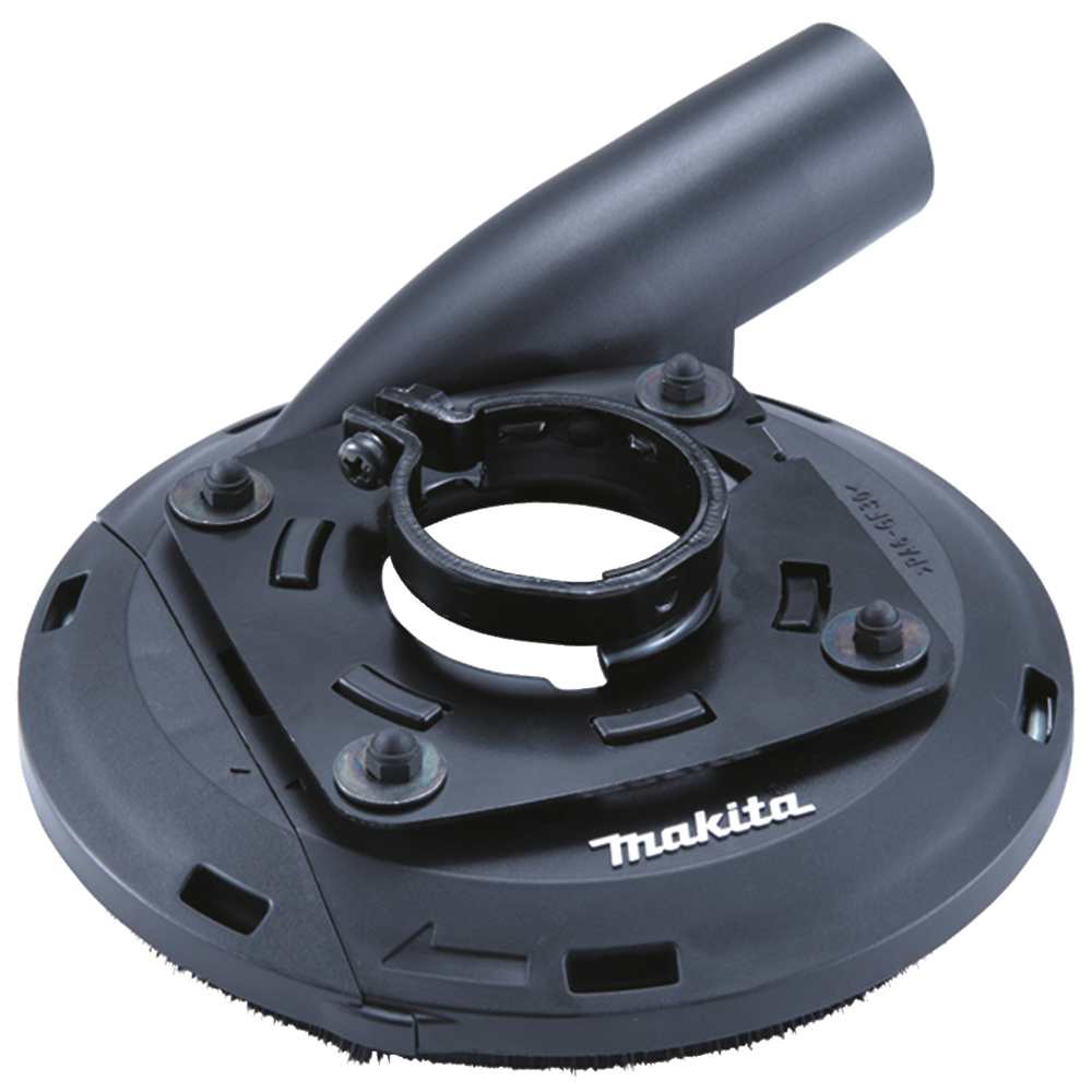

Nick Laslett Posted June 25, 2025 Posted June 25, 2025 Just a point about the grinder. I have the dust attachment, which greatly increases its stability. There are brushes and a spring, so the disc does not touch the concrete until you apply some pressure. 2
