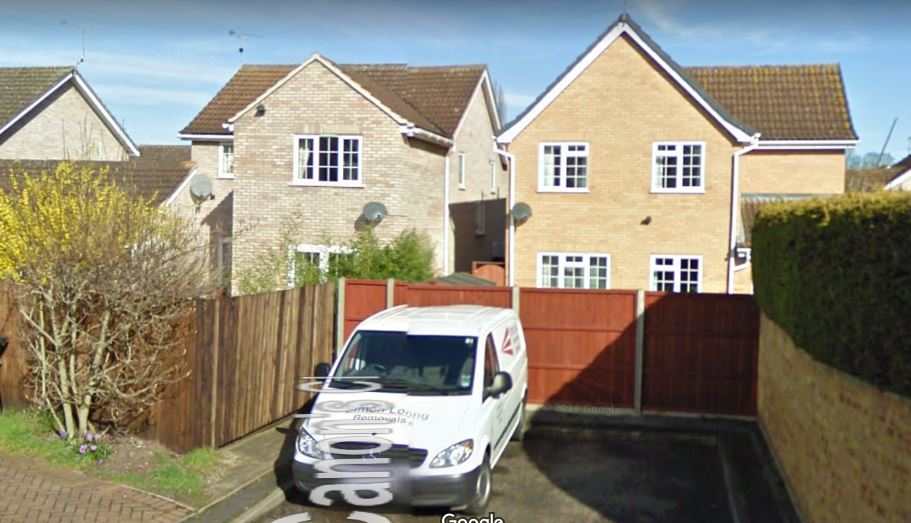

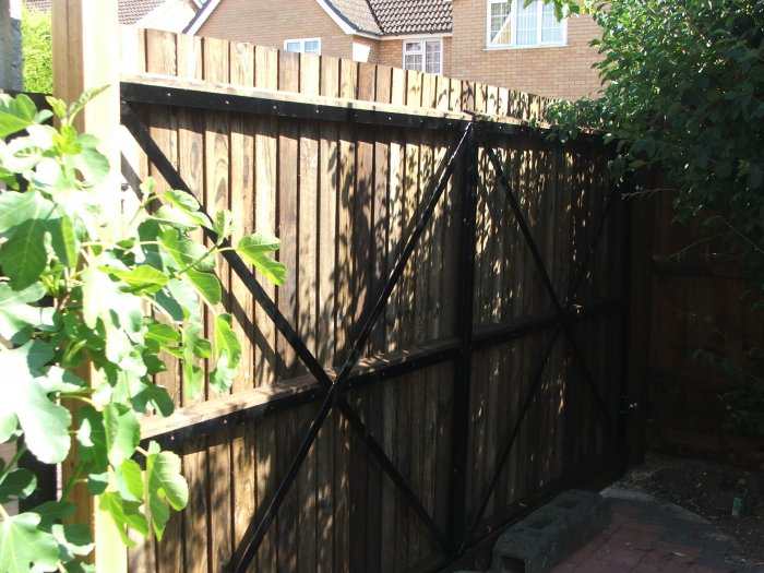

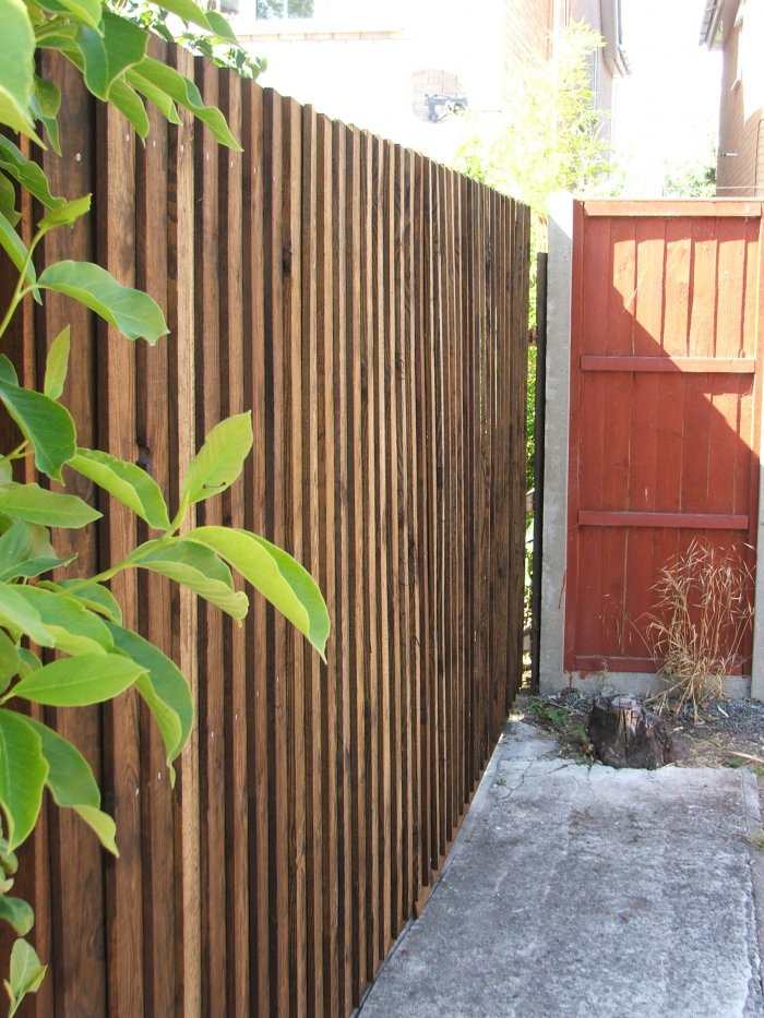

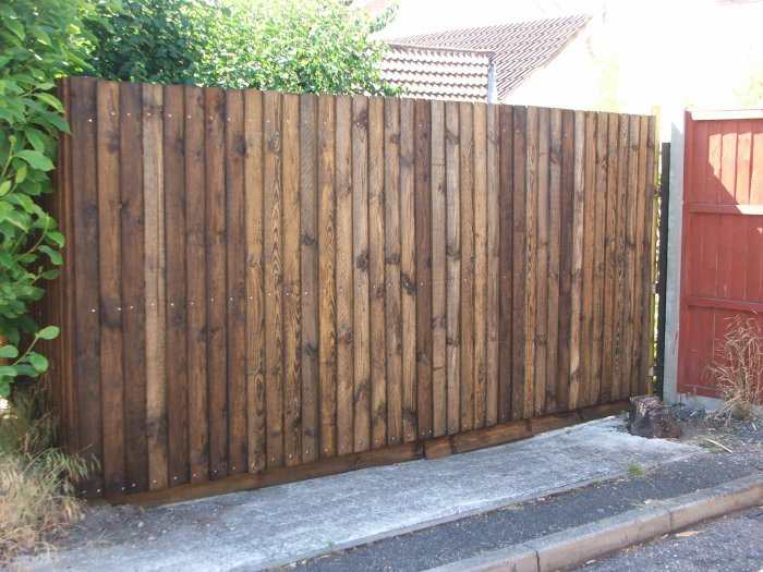

I bloody hate council idiots had enough experience of them in the past
I applied to extend house 2 storey extension on the back to replace a horrible single glazed glass conservatory that could be used for maybe 2 days a year most of spring summer and autumn too bloody hot and rest of the year too damn cold and got planning permission granted.
I had a back fence (usual 6 ft cant rail with featherboard) backing on to a turn round/visitor packing space in the cul-d-sac behind - Fence was 25 years old and rotten - I took a 10 ft section down to allow building materials to be delivered to the back of the property and used some heras fencing as a temp security measure.
I got a council complaint that the heras fencing was taller than 6 ft (alongside a highway) and could potentially restrict visibility (I sh*t you not - it's bloody open mesh!!!)
I dug a hole for the rubber feet and dropped the height to 6 ft - wrote them a letter and said all sorted fence is 6 ft now job done
All went quiet - I finished the building works and started re-instating the fence to be served with a notice that the fence cannot be more than 3 ft high due to proximity of the highway (Turn round space/visitor parking in a cul d sac remember)
I wrote back saying original fence installed by the builders was 6 ft - I'm just re-instating that and they were applying a rule regarding highway to my fence but not the two other gardens that also back on to this "highway"
I got another letter saying in the nicest council language that they did NGAS - because I had removed the 6ft fence now 3ft was the highest fence I could install (Making my garden very easy to access for any local toerag.)
So I did this which isn't a 6 ft fence
Honestly it's not
The council demanded a face to face meeting to discuss urgent resolution and I agreed to their request
Came round and we walked round the cul-d-sac together and measured it with me pointing out again it was not compliant
So I opened it
I'd already unlatched the other side
Because it wasn't a fence at all it was a feather board clad double gate and I said should anyone using the turn around / parking space find that their visibility is impaired I've had a sign made to say call at house XX and I'll open the gates................
Council lass clearly very very pissed about it but I never heard another more.
