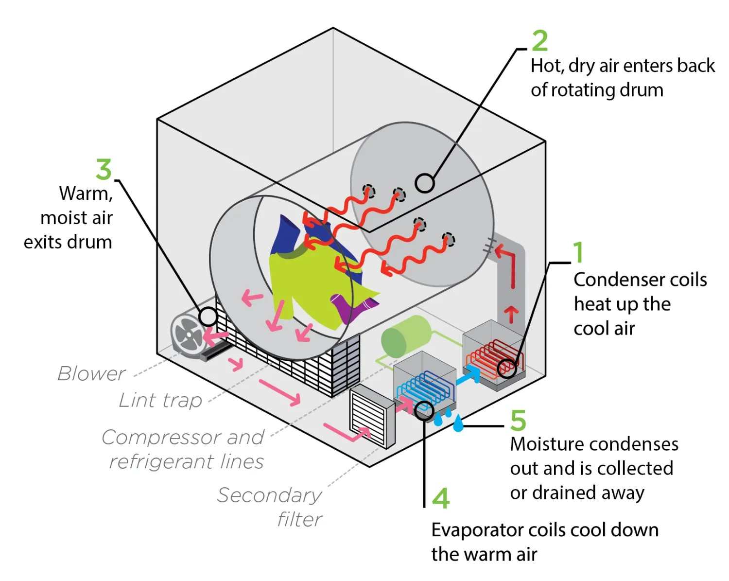

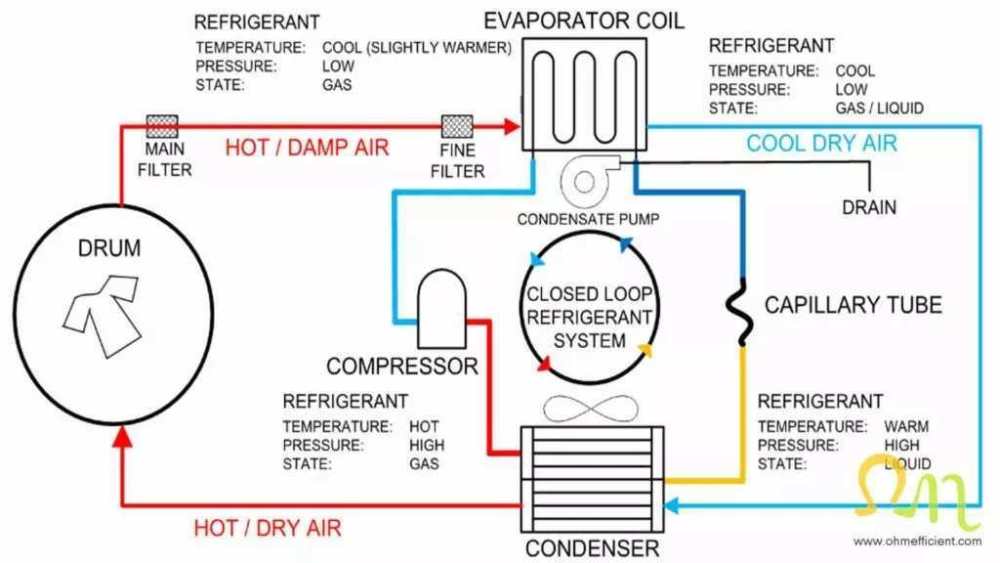

JohnMo Posted June 30, 2025 Posted June 30, 2025 Sorry to throw a spanner in the works. A heat pump dryer does not take or give air to the room. It a self contained system. Look here for a simple explanation https://goclean.masscec.com/article/how-heat-pump-clothes-dryers-work/
JohnMo Posted June 30, 2025 Posted June 30, 2025 43 minutes ago, LnP said: The guy in the linked YouTube video isn't a fan of HP dryers and agrees with what @Nickfromwales says about drying times ... link. Watched the video to the half way point, sorry it's rubbish. He really has no idea how the heat pump side works. Testing with a dry drum is nonsense. The moist air condensing will be playing a major role.

JohnMo Posted June 30, 2025 Posted June 30, 2025 26 minutes ago, Dave Jones said: it helps that the 'outide' air the dryer is using to drive the heatpump is allways around 21 so its not working hard. asked the mrs and she said a full load of towels is an hour tops. Outside the dryer air isn't used on the cycle at all, once you close the door. Not sure where @jack gets the interaction with room air?
JohnMo Posted June 30, 2025 Posted June 30, 2025 1 hour ago, LnP said: . If your tumble dryer has a 2.5 kW heater, all the 2.5 kW ends up in your house I know a lot more about tumble dryers now 😀. Not sure you do know a lot more? Our HP dryer adds almost no heat to the room, a little radiated from the door but not much. 2.5kW is enough to heat the whole house at about -4 degs. Room temp would be about 50 degs if the dryer worked as described up thread.

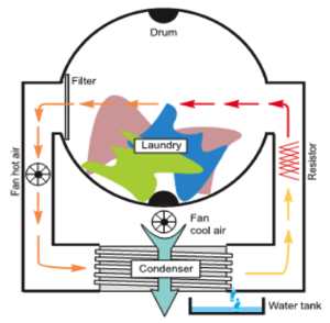

LnP Posted June 30, 2025 Posted June 30, 2025 48 minutes ago, JohnMo said: Not sure you do know a lot more? Our HP dryer adds almost no heat to the room, a little radiated from the door but not much. 2.5kW is enough to heat the whole house at about -4 degs. Room temp would be about 50 degs if the dryer worked as described up thread. Well, I think I know that you didn't read my post. I was talking about condenser dryers. The ~ 2.5 kW heat from a condenser dryer all ends up in the room .... well tbh all the heat from your heat pump dryer's compressor motor ends up in your room as well, however much that is 😉.
LnP Posted June 30, 2025 Posted June 30, 2025 (edited) 1 hour ago, JohnMo said: Outside the dryer air isn't used on the cycle at all, once you close the door. Not sure where @jack gets the interaction with room air? Catch up! He was talking about condenser dryers 😀. ... about which I didn't know much until this voyage of discovery. Edited June 30, 2025 by LnP 1
SteamyTea Posted June 30, 2025 Posted June 30, 2025 I had a condensing washer dryer, can't remember if it was a Hotpoint or a Candy, but I seem to remember that it used the cold water feed to condense the moist air.
jack Posted June 30, 2025 Posted June 30, 2025 2 hours ago, JohnMo said: Outside the dryer air isn't used on the cycle at all, once you close the door. Not sure where @jack gets the interaction with room air? I was talking about ordinary condenser dryers (like the one I have), not heat pump condenser dryers. Non heat pump versions definitely use room air to cool the condenser: 1
