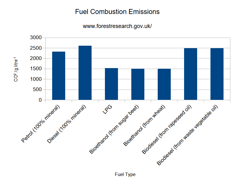

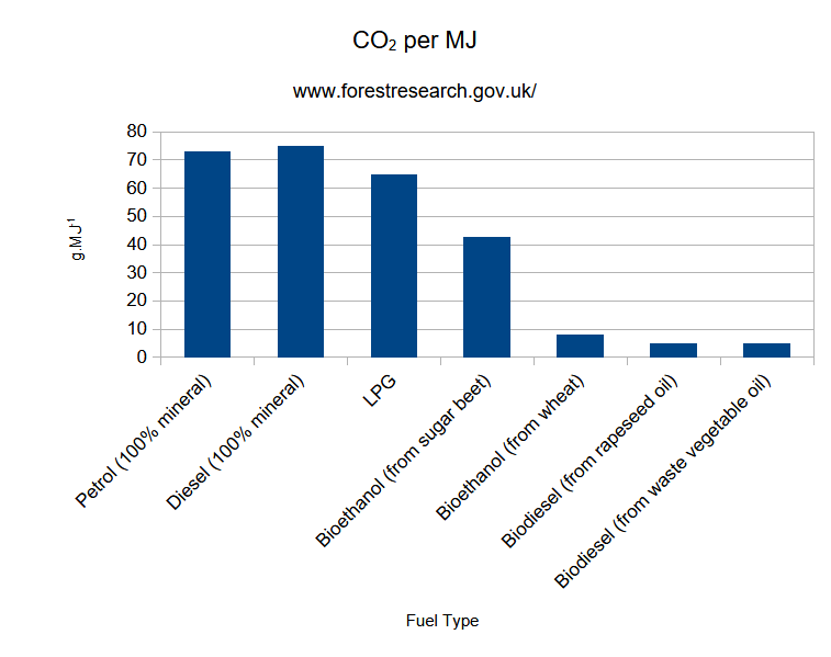

SteamyTea Posted Sunday at 07:50 Posted Sunday at 07:50 9 minutes ago, JohnMo said: The circulation pump on Totem generator/heater was huge. They dis day that it was oversized for the application. As FIAT (Fix It And Try) made the unit, not a surprise that it never caught on. I still think that CHP units are a good idea for off grid applications. If run on LPG, which is probably the only real option for off grid, then the CO2 emissions are not too bad on a fuel volume basis. But not so great when looking at emissions per MJ. But that does show that running on regular diesel or gasolene is not much worse. Once thermal losses are taken into account, and assuming the thermal and electrical elements is used directly i.e. not running an HP or stored in batteries. The emissions will be about 470 g.kWh-1 which is pretty dreadful, so not an environmental solution. 1
JohnMo Posted Sunday at 08:32 Posted Sunday at 08:32 41 minutes ago, SteamyTea said: FIAT (Fix It And Try) made the unit, not a surprise that it never caught on. They are still being sold
JohnMo Posted Sunday at 08:36 Posted Sunday at 08:36 43 minutes ago, SteamyTea said: But not so great when looking at emissions per MJ Interesting, but all the bio stuff takes credit for CO2 sucked up during growing, they still chuck it out of the tailpipe. Still produce NOx, CO, particulates etc
