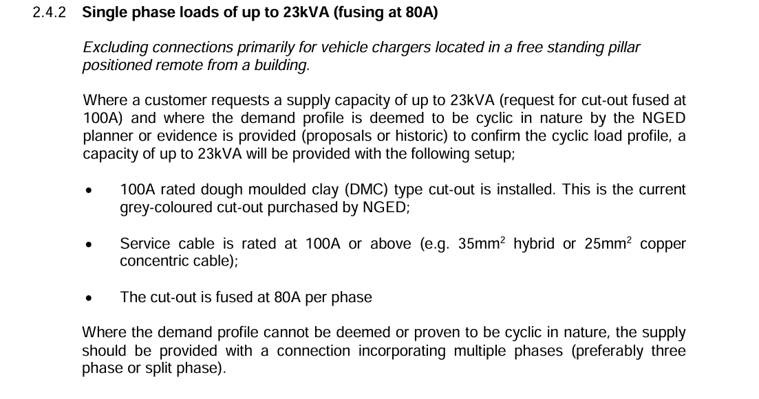

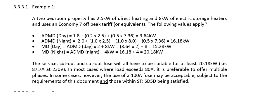

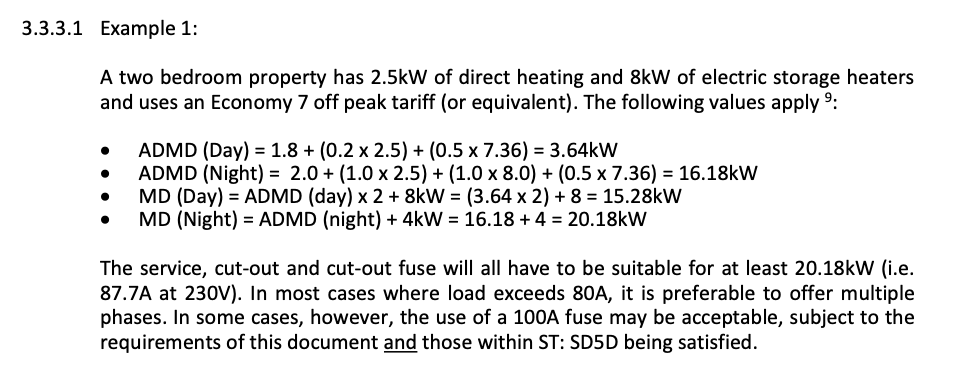

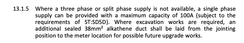

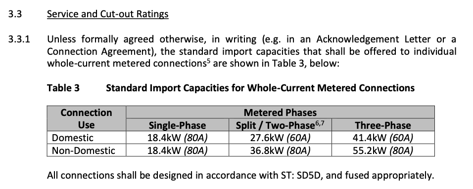

garrymartin Posted June 23, 2025 Posted June 23, 2025 National Grid can provide 100A on a single-phase in some circumstances, but 80A is standard. There are notes somewhere that an 80A fuse can cope with a 100A load for 4 hours, so they don't generally do 100A on a single-phase, but would look to do 60A on three-phase instead where possible. Lots of NG documents refer to this including SD5A_6 and SD5G_5Part 1 (where the images below come from). What are your specific requirements for 100A? Do they meet the conditions specified in those documents and in SD5D?
Nickfromwales Posted June 24, 2025 Posted June 24, 2025 11 hours ago, Roger440 said: They will give me 80, but not 100 If you don't average higher than the 80, and peak at 100/110, the HRC fuses will just run close to molten and cope with peak demand. It's only if you know you will have sustained 3x100a consumption, which is huge, does this become a problem. I expect the 3x 80a would be more than ample for most things? Welding sets prob worst, and shunt resistance from compressors etc will cause spikes, but then settle down when constant. Welding is in sporadic bursts so again maybe not such a problem.
Roger440 Posted June 24, 2025 Posted June 24, 2025 12 hours ago, garrymartin said: National Grid can provide 100A on a single-phase in some circumstances, but 80A is standard. There are notes somewhere that an 80A fuse can cope with a 100A load for 4 hours, so they don't generally do 100A on a single-phase, but would look to do 60A on three-phase instead where possible. Lots of NG documents refer to this including SD5A_6 and SD5G_5Part 1 (where the images below come from). What are your specific requirements for 100A? Do they meet the conditions specified in those documents and in SD5D? As per my thoughts elsewhere, i wanted a 3 phase supply for my workshop as i have some three phase equipment, and ideally, need a bigger compressor, which would be better three phase. Probably 7 to 10kw. However, their position on this is i have to pay for all the network re-inforcement unless there were three houses off the same transformer. But theres only 2. Theres simply no way im going to pay that much for a connection from a pole in my own field. Whilst im still debating this with them, i need to look at other options. Realistically, i have 2. Install a genset (with batteries), or upgrade the existing 240v supply from the existing 60 amp one to 100amp. I "might" get away with 80amp. but i might have to apply some selector switch so i cant run the compressor at the same time as other loads. The house has an electric shower and eloectric cooker, both on 30amp breakers before you even consider the workshop. With regard to the criteria you refer to (thanks for that) its a bit grey as its the workshop that tips it over. Its a workshop at home, for my own use, so "domestic" in nature, but obviously, has electrical demands beyond what most would consider "normal". So, i guess do NOT fall within the requirements. Would an EV charger pull it in to the requirements? Where are you finding these documents? Ive not found them.

Roger440 Posted June 24, 2025 Posted June 24, 2025 54 minutes ago, garrymartin said: https://www.nationalgrid.co.uk/documents/tech-info/design-standards/low-voltage?page=4 Thanks, most useful The below seems to be they key point. ie, 100A may be acceptable.................... Depending on if one can take workshop loads into account, depends which side of the line you fall. With an EV charger, a heat pump, cooker, shower, plus my workshopn inc compressor, one could easily calculate accordingly for a 100A supply. But i dont currently have all those thngs. Because i dont have a supply. I shall have to try and see if i can make progress on the single phase side of things. All that said, its probably acedemic as the supply cable almost certainly isnt big enough if we take the below into account. The supply id suggest is no more than 10mm2 cable. Its all rather complicated for the layman to challenge.
