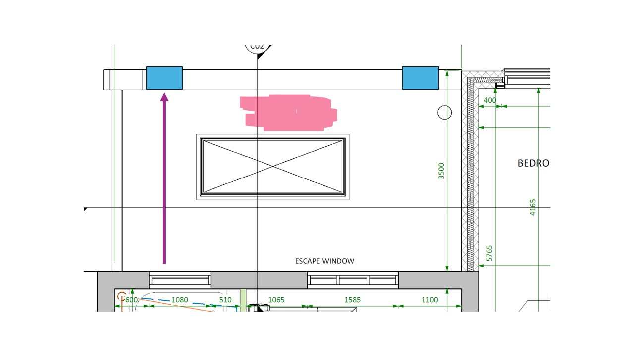

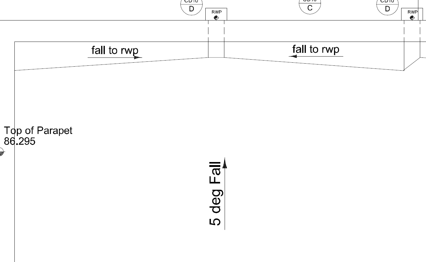

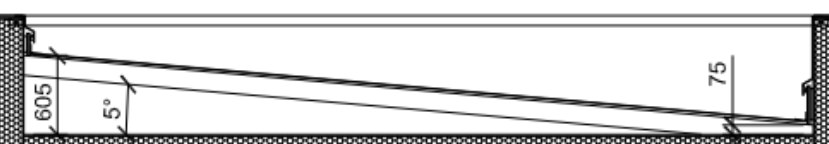

Hi Folks,
Just trying to get my head round drawings from my architect for a single storey rear extension 3.5m with a warm flat roof (GRP) and parapet wall detail all around. He has specified furring strips from the old house out to the rear (purple arrow) with 2 parapet wall rainwater outlets (marked in blue). Surely the area marked red will collect rainwater, what's encouraging it to move/drain out the water outlets? Ignore roof lantern that is not going to be built we've opted against it.
Thanks
I think if I had been your architect (which I never would be as I am not one!) I might have played with the levels of the majority of the flat roof so that , without diminution of the insulation, I could get a channel in hard against the parapet with the outlets, with a slight fall each way from the middle. The fact that you have chosen GRP makes that easier than with any other covering I can think of. And Robert is your Mother's brother.
From memory on our previous build I had fairings made 70 mil to zero over 5 meters
Outlets same as yours and created a slits bump where you have marked red Keep the outlets low and you will be fine I did ours over five years ago and apart from when leaves block the outlets never collects water

We had a lot of room to play with, and ours dealt with it like this:
As built, we ended up with a parallel-sided channel rather than the complex things the architect drew.
It's important to make sure that there are decent falls all the way to the exit of the outlet into the downpipe. In our case, some of the falls were a little marginal. As the underlying USB has sagged a little over time, there are now places in the gutters where water pools.
The biggest issue I see with these installs is the outlet is formed first, which creates a high point.
Then the main roof material gets laid to them and then that has to climb up over that step, albeit a few mm’s, but that’s enough to cause water to pool in between / around the outlet(s).
On the next one I’m getting in the drivers seat, and the 18mm OSB3 deck will get a load of attention to furring, levels and falls, and then the lot will be getting a second sacrificial layer of 9mm OSB3 which will be cut around 300mm square away from the start of the outlets to create a step down there.
The outlets will be formed to stop short of the step where the 18 meets the upstand edge of the 9, and left to cure, with layers built to lose say 4mm of the 9mm OSB step.
Then the main roof covering will go to the cut out sections, get dressed in over the preformed and cured outlet material, and then be welded / bonded down to have the steps falling down not up.
I’m quite fed up of roofers pacifying me and saying it’s fine, they all just think that standing water and leaves needing to be washed out all the time is fine, as the roofs can handle standing water.
IMO that’s a load of crap, we can do better people!!

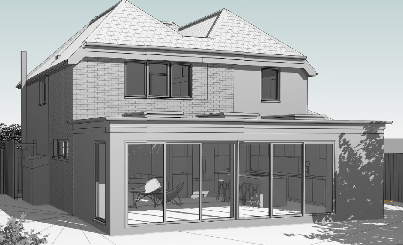

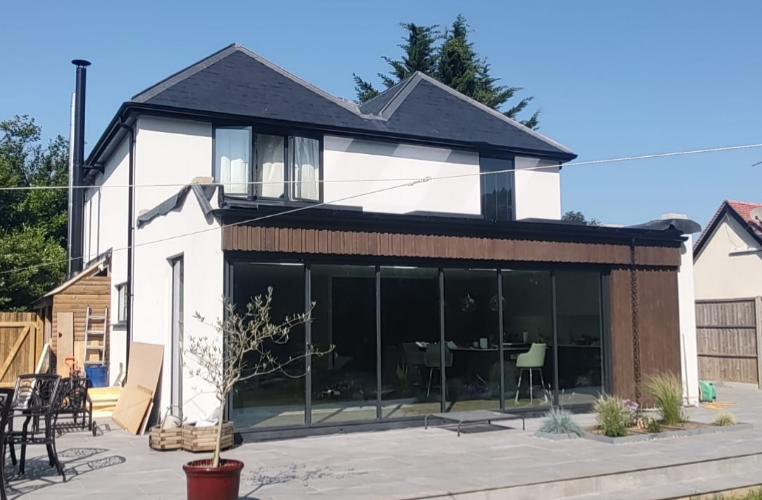

I had a parapet wall specified on my 28sq m extension as I was trying to avoid downpipes on the rear elevation (side scuppers). Apart from the technical challenges you are encountering there is an aesthetic component as well.
My original drawings looked like this:
It turned out to be completely misleading as a warm roof is way thicker than the drawing would indicate and it would have left an enormous space above the patio doors. In the end I kept the side parapets and had a single deepflow gutter with a rain chain as a feature
You can see that if I'd kept the rear parapet the rear wall would have dominated the elevation
