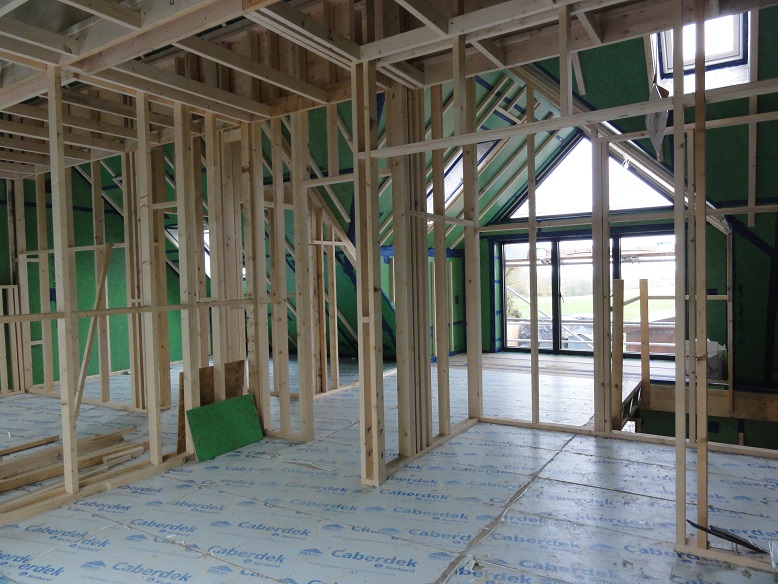

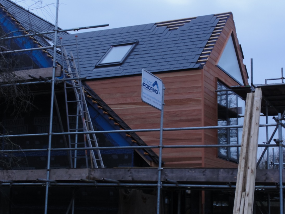

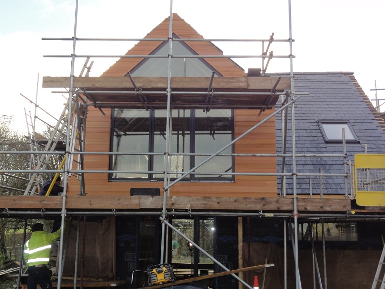

Moira Niedzwiecka Posted December 22, 2017 Posted December 22, 2017 Our windows were installed about 3 weeks ago very badly by our timber frame contractors. 2 of the frames were damaged beyond repair & have had to be re-ordered from Denmark. The 6m sliding patio doors were installed 25mm too low to achieve the finished floor level & many other problems. They have all been taken out & re-installed this week, properly, by one of Ideal combi's registered installers. The guys who did them were very professional & meticulous. Have to say Ideal combi have been very helpful in getting this sorted out for us. The cedar cladding had been started & looks lovely. The weather last week stopped the stonemasons. We are having ironstone & it was too cold for the lime mortar. Ditto the render, has to be dry & above 5 degrees. We are now weather tight & first fix wiring & plumbing booked in for early Jan. The roofers arrived at 8am this morning & will finish the roof as much as they can until the render is done. We are going to spend the Christmas break putting several coats of osmo on the rest of the cedar cladding before it is fitted. The cedar already on has been treated but we might give it another coat, weather permitting. After lots of delays & trauma we now feel that things are coming together. 4

Luckylad Posted December 22, 2017 Posted December 22, 2017 The boarding in the photo looks really good ,but I'm intrigued by the slate verge detail. Can you post a photo when it's completed?

Moira Niedzwiecka Posted December 22, 2017 Author Posted December 22, 2017 @Luckylad We are having an anthracite aluminium dry verge that will just cloak over the top of the cedar. It will be the same on the gable ends with the render. We are also having anthracite aluminium box guttering. @ragg987 I am hoping to pick up some lighting & Sanitary ware in the sales. I have some already.
