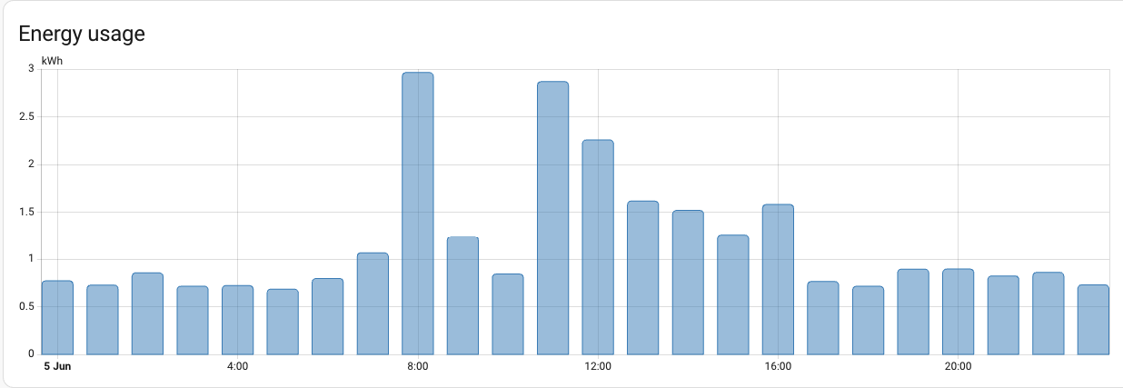

Just finished my build, my typical daily usage looks like this:
(28kwh total in 24h)
I'd like to install solar PV (and perhaps a battery), objective is to maximise ROI.

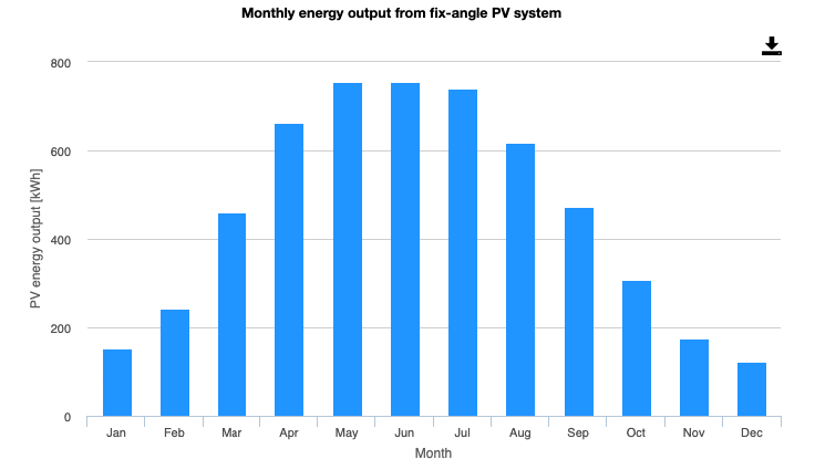

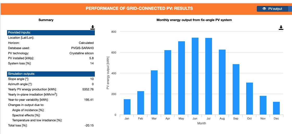

Thanks @SteamyTea - here is my first cut with the 5.8Kwh array.
As you have pointed out, there is huge variability. In the month of July I'd basically generate my daily usage... (739kwh) - or 24kwh per day.
So with this in mind - how big a battery would be optimal ?

I see your lunch time usage is about 2.5kWh, a good summer day a 5kW PV array could be generating 5kW or between 12am and 1pm 5kWh. Great if paid for export, but not so if you are giving it away.

2) Corrected chart for a 5.8Kw array:
3) I now understand that it's ideal to undersize the inverter by ~20% in the UK, so if sizing a 5.8Kw array, then a 5Kw inverter is about perfect.

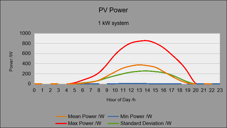

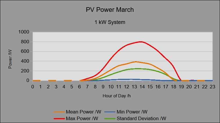

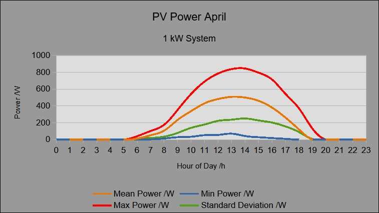

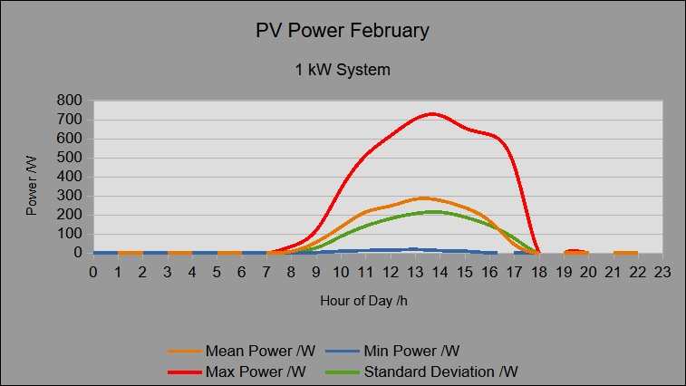

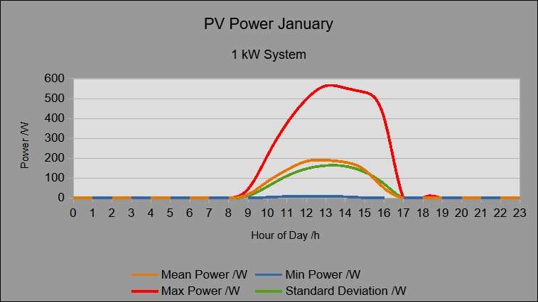

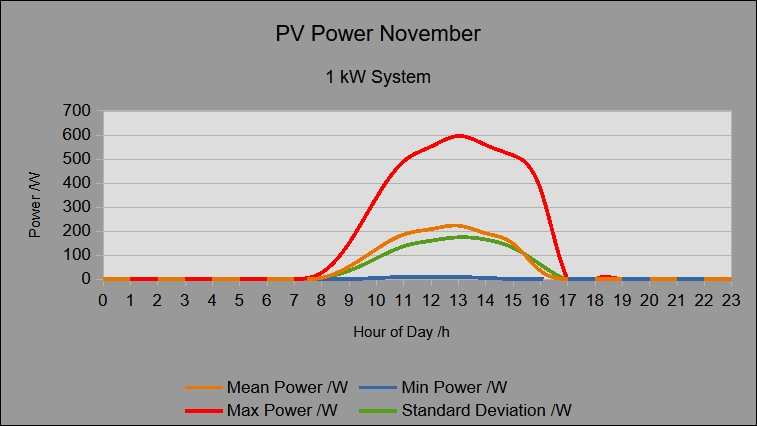

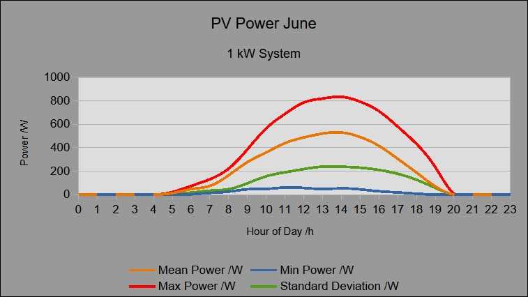

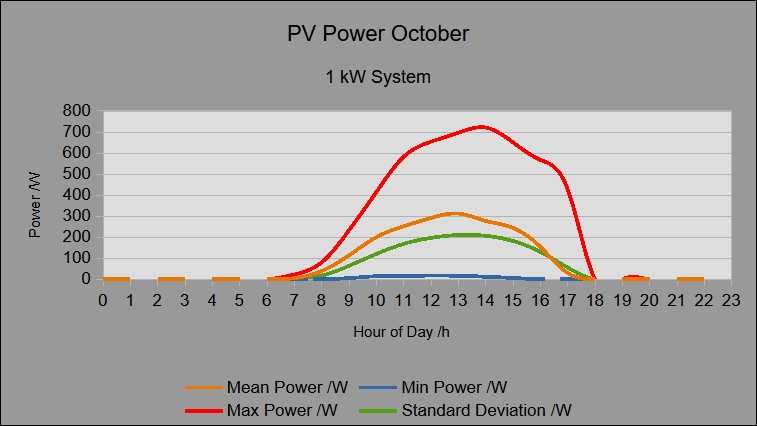

Right, here is a better chart of what really happens.
It shows the mean power, based on 18 years of hourly data, plotted for a whole year (I shall do some monthly charts once I have finished my supper).
It also shows the minimum power, if that power is greater than 0 watts, and maximum power.  The Standard Deviation, in watts, is the middle 68% of the mean power.  This allows you to accurately estimate the usable power.
You will quickly notice that there is a huge difference between maximum power and mean power.

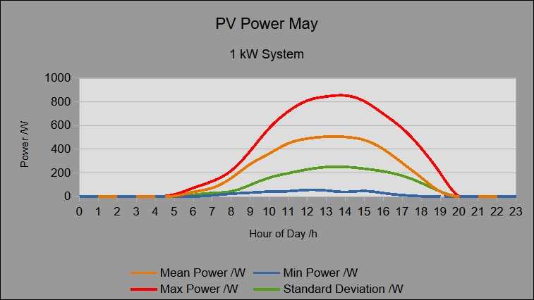

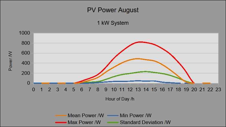

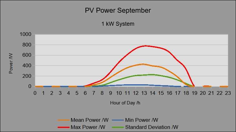

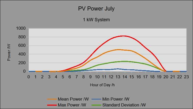

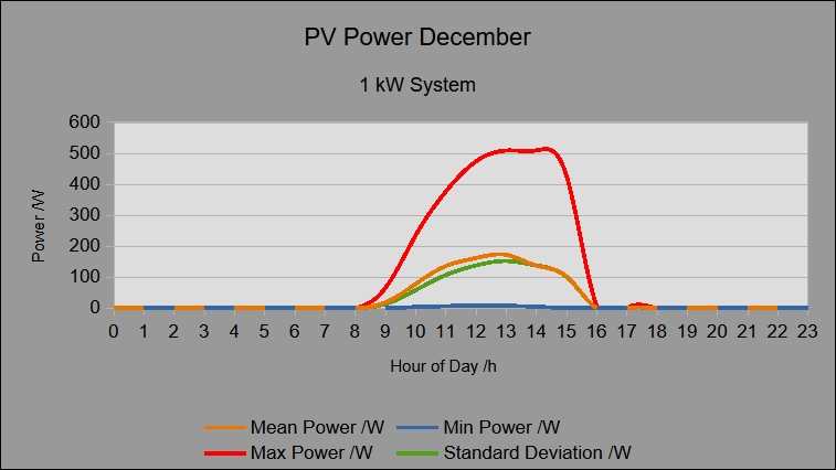

Here are the monthly charts, based on my location, which is a bit better than most people.
