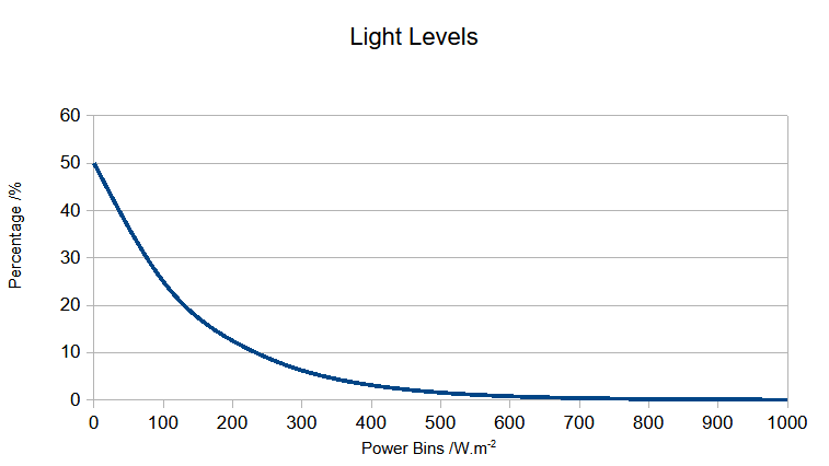

June 9, 20251 yr 56 minutes ago, Dillsue said: As an example, if you extend a 4 kw system by 4kw to give an 8kw system you get paid FIT rates on the original 4kw. That is the way I understand it. You should be able to get a better yield and newer PV modules are more efficient at lower light levels and if the right inverter is chosen, then that can be taken advantage of. Generally, natural daylight follows an inverse square law. So you get a lot of sub 100 W.m-2 light, then half that between 100 and 200 W.m-2, half again between 200 and 300 W.m-1 and so forth. Very little at the greater than 700 W.m-2.
