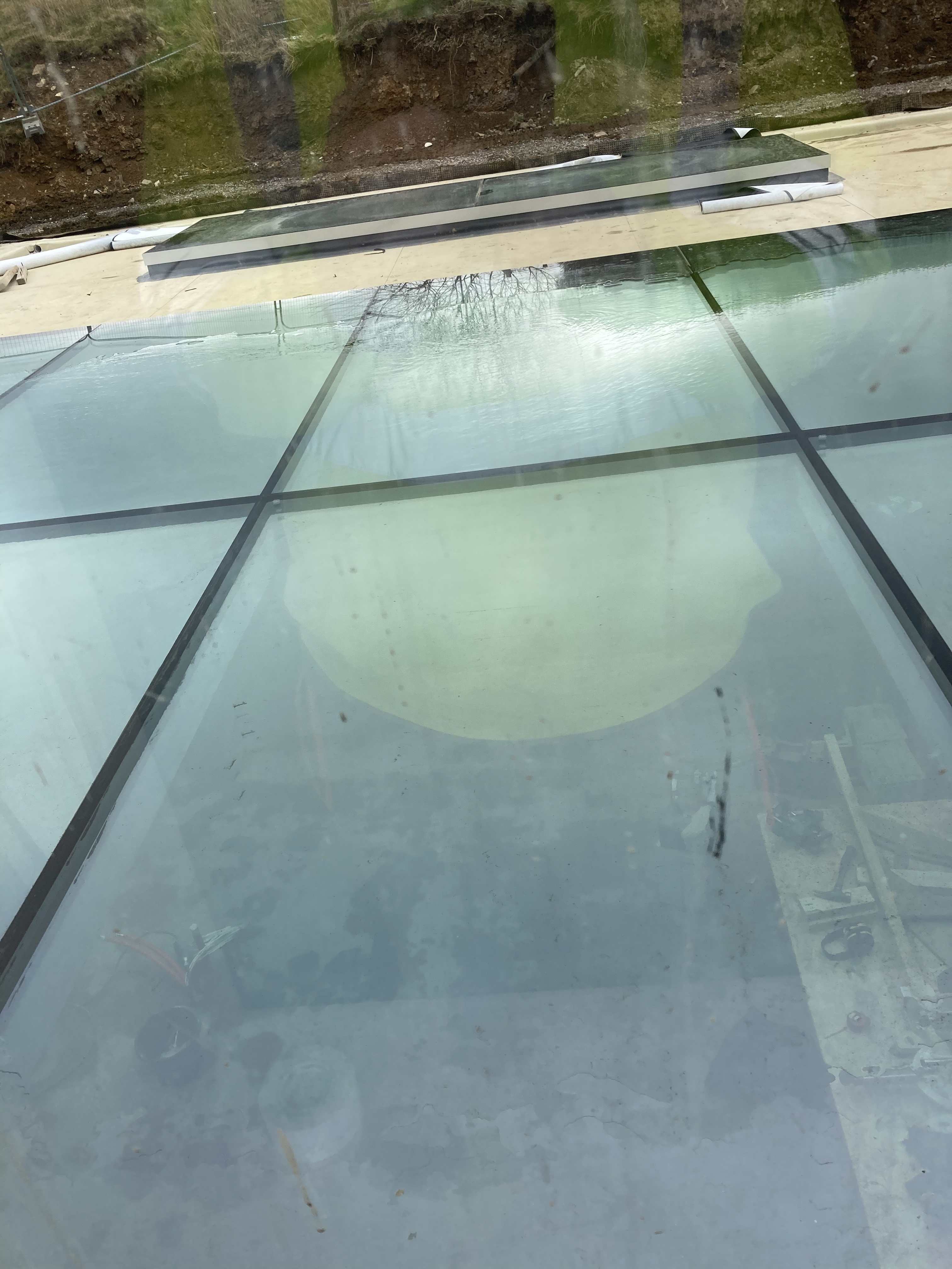

ToughButterCup Posted May 22, 2025 Posted May 22, 2025 In addition to @Russell griffiths point above, it took 7 of us to place this window - and, once placed, fitted it with four strapping lads. 3mm spare all round. I lost more sleep about getting that right than any other single issue. 2
