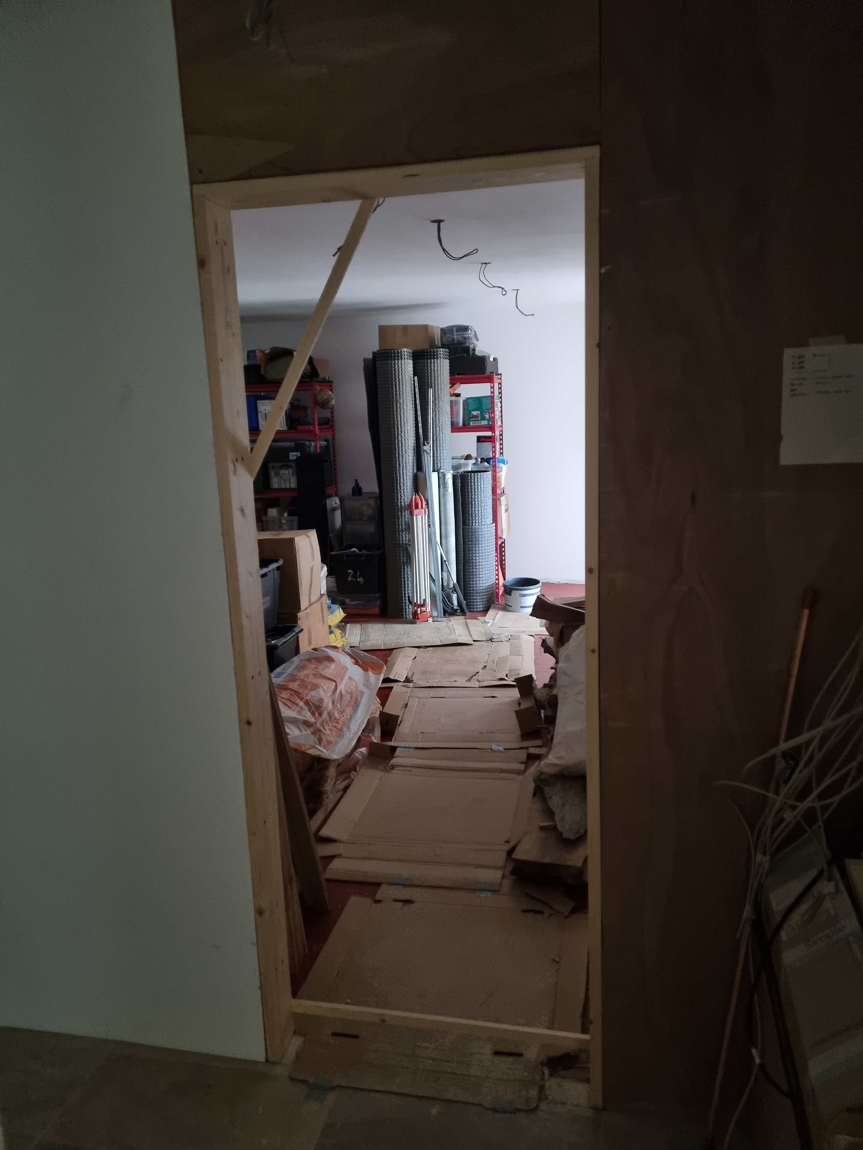

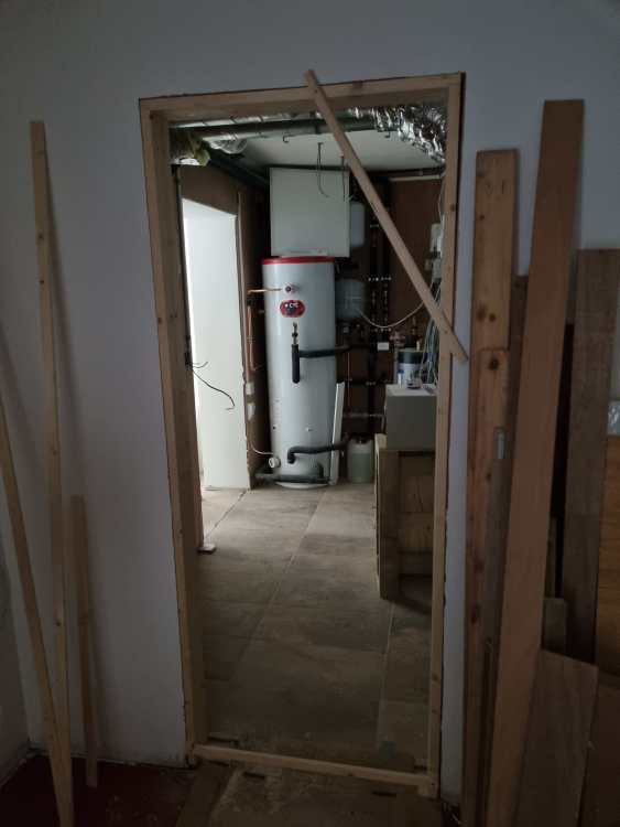

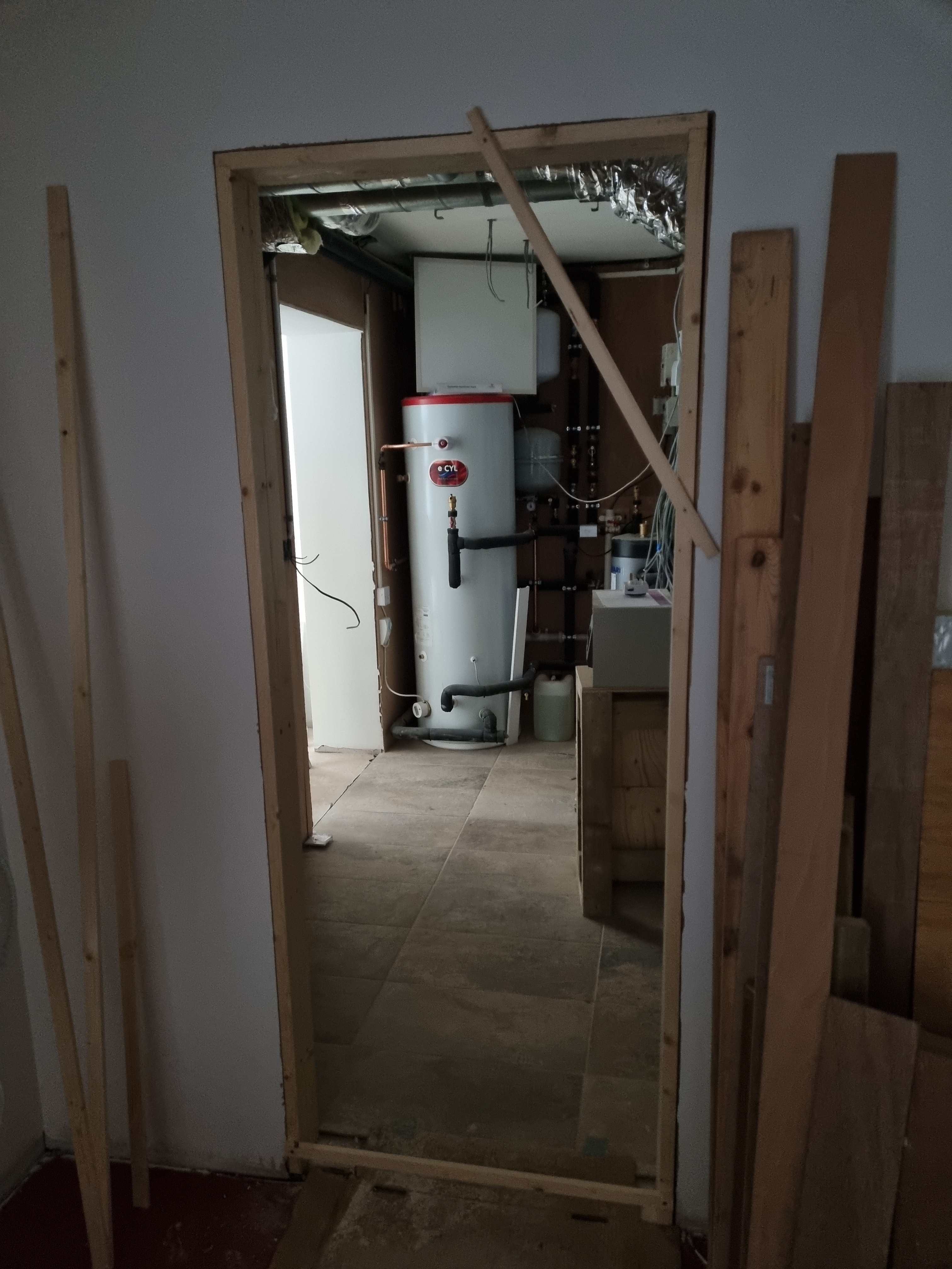

BotusBuild Posted May 21, 2025 Posted May 21, 2025 Following this link https://www.juliancassell.com/2564/fitting-a-door-lining provided by @MortarThePoint in another post I have fitted my first door lining (of 14). Rather pleased with the result. Hopefully the remainder will be as successful 6

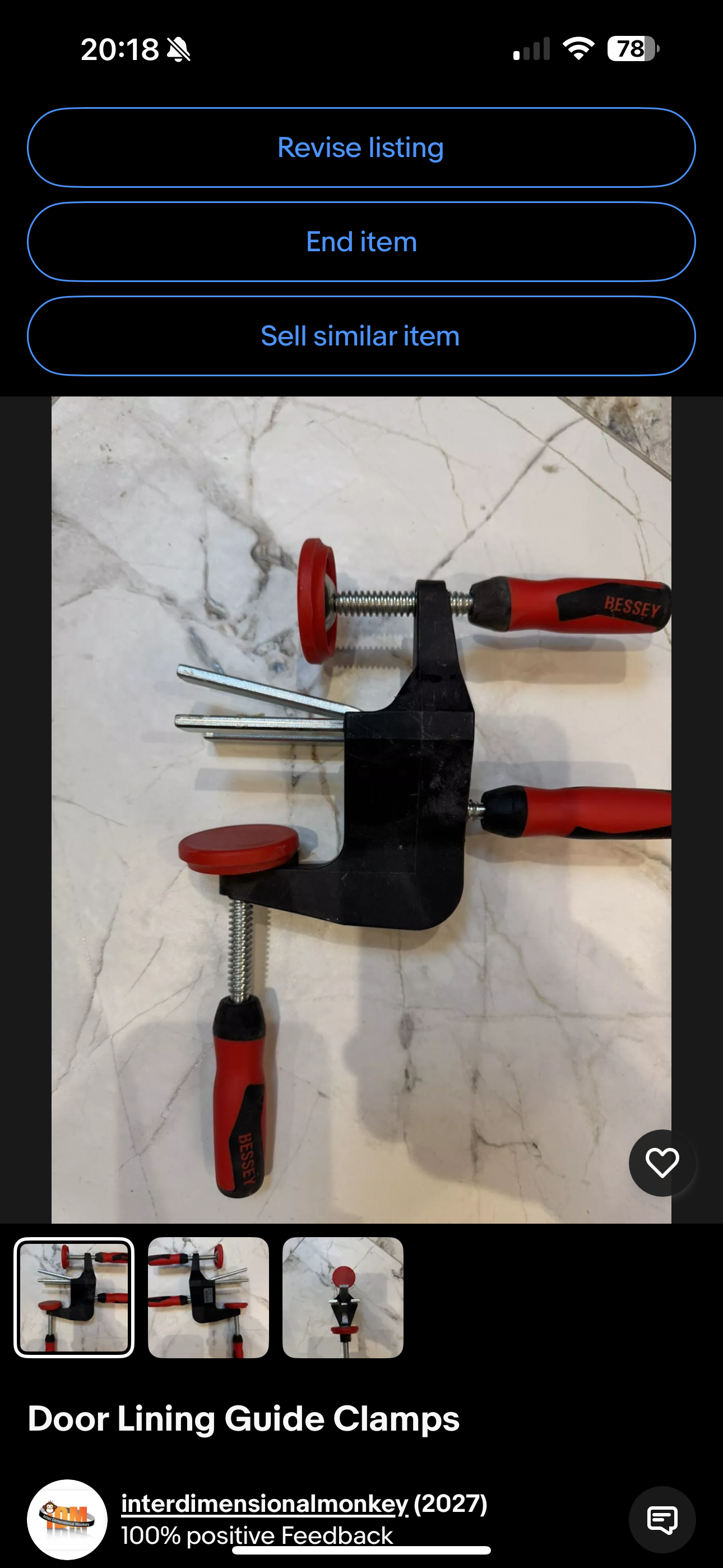

Pocster Posted May 21, 2025 Posted May 21, 2025 (edited) You need my door liner clamps . Perfect for this ! Got 4 of these …. For sale ! Edited May 21, 2025 by Pocster

Pocster Posted May 22, 2025 Posted May 22, 2025 15 minutes ago, Thorfun said: I’m a sucker for new stuff so I already have hinge jig and door stand etc. my router will also do the hinges but I think it doesn’t plunge enough to do the latch but I’ll cross that bridge when I get to it! very kind of you to offer though. I’m sure I’ll be posting nearer the time for more advice on it all though. You need my clamps aswell ! . They are for door linings - makes it much easier to get them level in all axis . 1
Super_Paulie Posted May 22, 2025 Posted May 22, 2025 1 hour ago, Pocster said: You need my clamps aswell ! . They are for door linings - makes it much easier to get them level in all axis . how do these work then? ive got 5 doors i need to switch out this summer after the building settled on the beams and threw the linings out.
Pocster Posted May 22, 2025 Posted May 22, 2025 9 minutes ago, Super_Paulie said: how do these work then? ive got 5 doors i need to switch out this summer after the building settled on the beams and threw the linings out. I think no one gets these . I did 6 door linings with them . 1 at top on each side and one at bottom . Go between the lining and the wall . Allows you to move the lining in all directions to get it perfect . Then I foam around the lining - making sure to protect the clamps so I can remove them . They take a bit of getting use to but make it far simpler and allow you to get it level in all directions so all your doors close nice 😊
Thorfun Posted May 22, 2025 Posted May 22, 2025 1 hour ago, Pocster said: I think no one gets these . I did 6 door linings with them . 1 at top on each side and one at bottom . Go between the lining and the wall . Allows you to move the lining in all directions to get it perfect . Then I foam around the lining - making sure to protect the clamps so I can remove them . They take a bit of getting use to but make it far simpler and allow you to get it level in all directions so all your doors close nice 😊 can you not do the same thing with packers though? 1
Pocster Posted May 22, 2025 Posted May 22, 2025 Just now, Thorfun said: can you not do the same thing with packers though? Of course . These are much easier . Effectively acting like packers but you can adjust as you level the frame . Much easier with these . 1

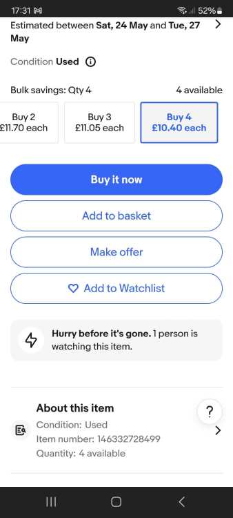

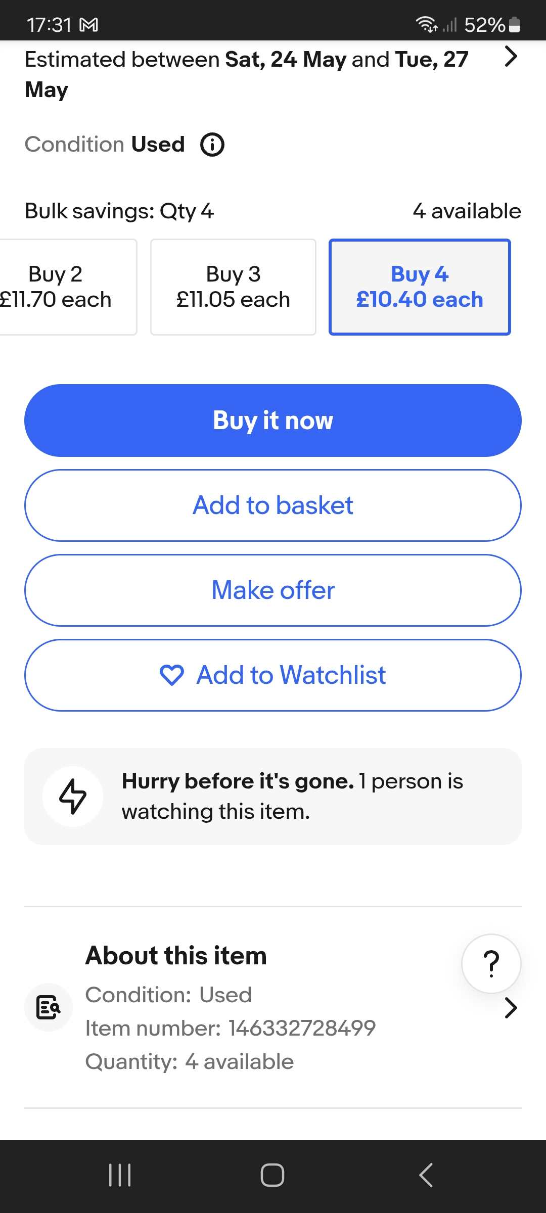

BotusBuild Posted May 22, 2025 Author Posted May 22, 2025 4 hours ago, Pocster said: So someone needs to buy them ! Not expensive !! Biting. Will you take £20? 1
Pocster Posted May 22, 2025 Posted May 22, 2025 5 minutes ago, BotusBuild said: Biting. Will you take £20? 20 each with free postage ? you will need all 4
BotusBuild Posted May 22, 2025 Author Posted May 22, 2025 😂 Not when I can get them for a tenner and free postage off fleabay. Nice try. £20 for all 4 is the offer
Pocster Posted May 22, 2025 Posted May 22, 2025 8 minutes ago, BotusBuild said: 😂 Not when I can get them for a tenner and free postage off fleabay. Nice try. £20 for all 4 is the offer Only ones on eBay I can see are mine at £13 each … Show me your bargain for a tenner on eBay ? 1
Pocster Posted May 22, 2025 Posted May 22, 2025 10 minutes ago, BotusBuild said: I'll carry on with wedges Yeah awesome . A link to mine ! - and yes if you buy all 4 they are about a tenner each !
BotusBuild Posted July 12, 2025 Author Posted July 12, 2025 A quick follow up and another door lining question. All the door linings I bought were kits and the headrail had grooves cut in it for the legs/jambs to fit into, which I ended up having to reposition because of the opening widths. Could I just buy planed timber and make up linings? Yes, probably. Do I need the grooves in the headrail?
Russell griffiths Posted July 12, 2025 Posted July 12, 2025 Just buy solid timber no need to trench the heads, glue and screw before fitting, get in the habit of pre knotting the timber and giving it a coat of primer before fitting, far better than your painter doing only the front face afterwards. 1
BotusBuild Posted July 12, 2025 Author Posted July 12, 2025 48 minutes ago, Russell griffiths said: get in the habit of pre knotting the timber and giving it a coat of primer before fitting Will do for the last 10 🙂
