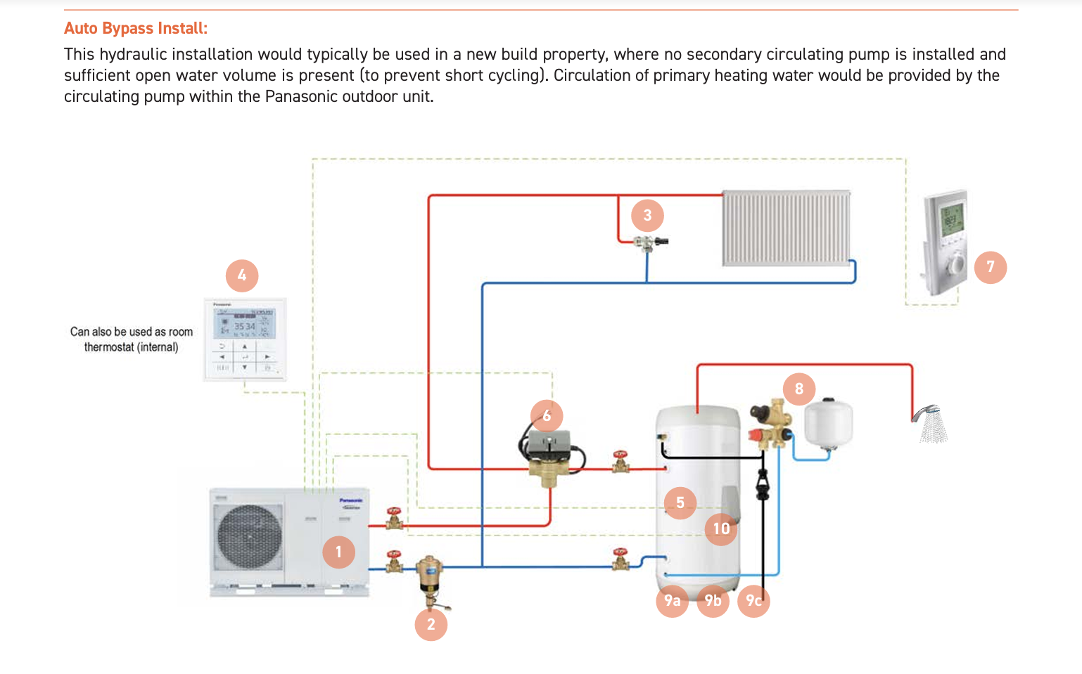

Nick Laslett Posted Saturday at 08:37 Posted Saturday at 08:37 (edited) 11 hours ago, JohnMo said: Just buy yourself a Panasonic to suit your heat needs about £3.5k, cylinder2go heat pump cylinder about £1200 from memory. Find a plumber to join it together with a 28mm 3 port diverter valve between cylinder UFH. If only UFH no need for mixer or pump. Expansion vessel and relieve valve after tee from cylinder return and a filling loop and a strainer. That's about all you need. So where these rip off merchants get the prices no idea. I just did myself, I paid £1300 (ASHP), £1000 for cylinder and another £600ish for stuff. Spent a few days installing. Got electrician to do wiring hook up. Zero faff, bought what I wanted, no justification about sizing etc. @zzPaulzz, like JohnMo, I did my install myself. Electrician connected it up. I went with Sunamp, to avoid G3. But a pre-plumbed UVC is easy for a G3 registered plumber to fit. Just a days work. We had a UVC fitted in our rental to replace the gravity fed system and it took the plumber a day. Secon Renewables have all the guides to most major brands. https://www.seconrenewables.com/heat-pump-technical-manuals-962-c.asp I went with Panasonic because at the time I thought their install guide was the easiest to understand. For a new build, you will be designing in the requirements for the ASHP. I can appreciate with retrofit there is more value a heating engineer can add. Questions like heat loss, water volume, etc, you should be able to answer, so spec of ASHP is much easier. You will also control how all this stuff comes together, so UFH manifold, UVC will all be in same place. The ASHP is only 2 pipes, 2 power cables and a control cable. Edited Saturday at 08:39 by Nick Laslett 1

zzPaulzz Posted Saturday at 09:00 Author Posted Saturday at 09:00 21 minutes ago, Nick Laslett said: For a new build, you will be designing in the requirements for the ASHP. I can appreciate with retrofit there is more value a heating engineer can add. Questions like heat loss, water volume, etc, you should be able to answer, so spec of ASHP is much easier. You will also control how all this stuff comes together, so UFH manifold, UVC will all be in same place. The ASHP is only 2 pipes, 2 power cables and a control cable. Exactly!
