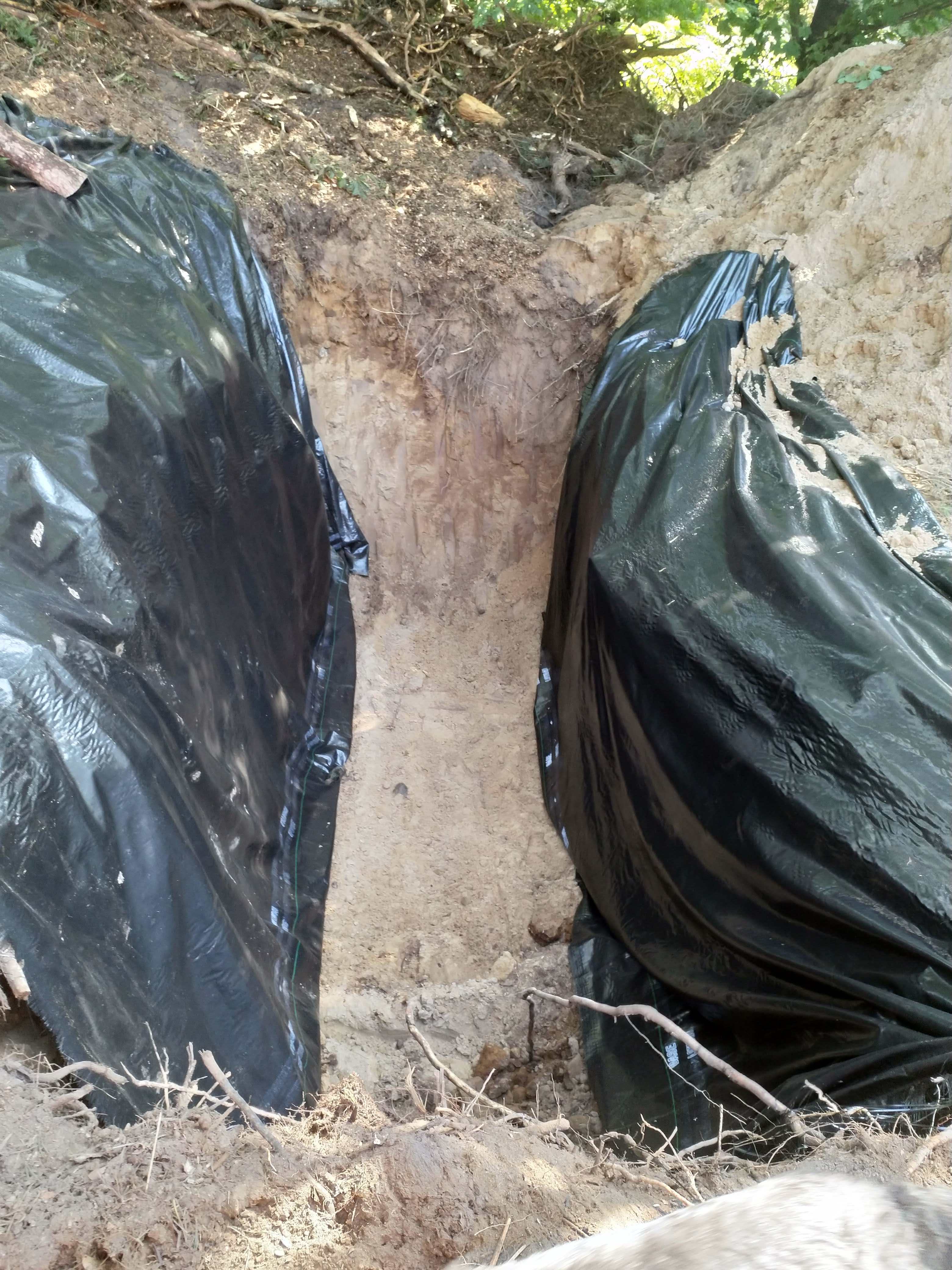

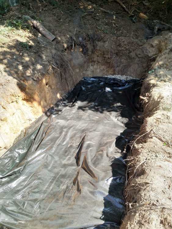

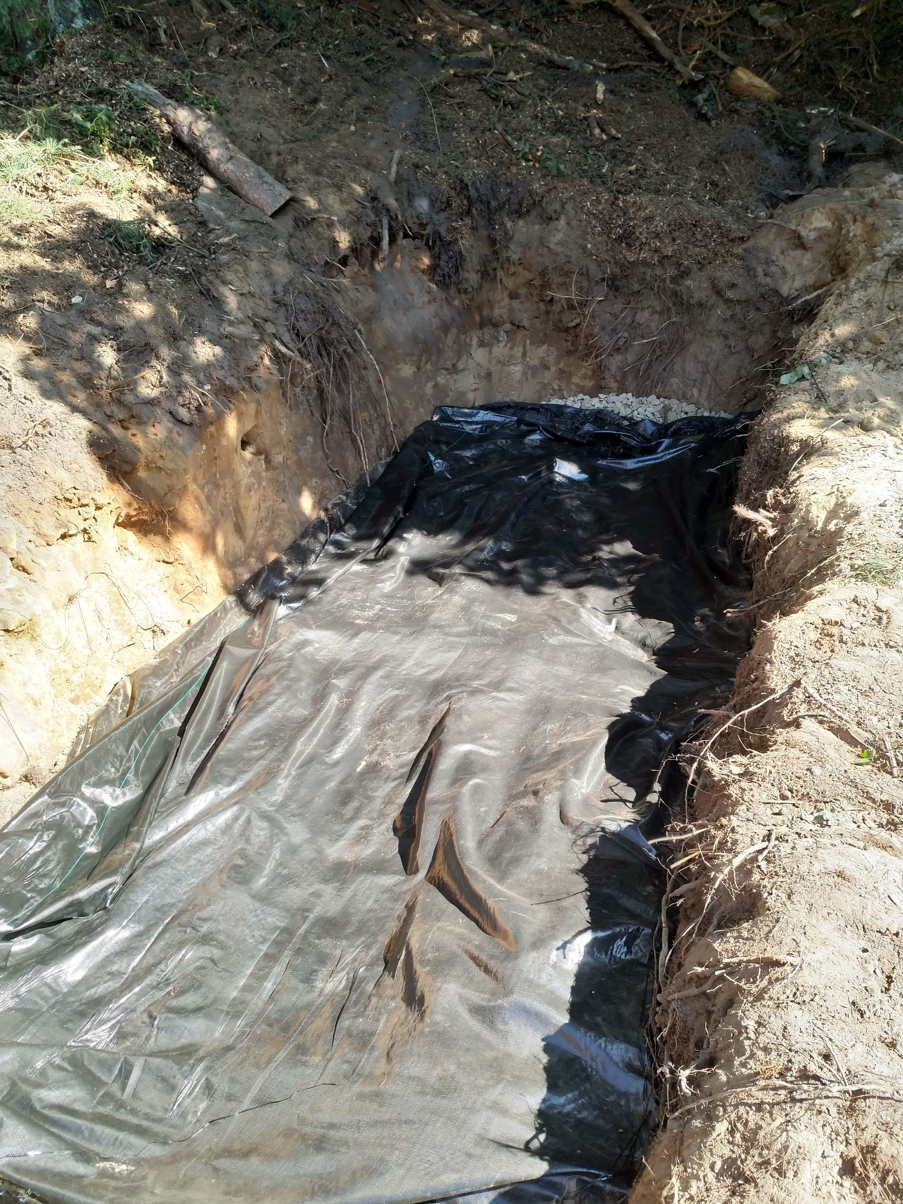

JohnMo Posted Thursday at 11:21 Posted Thursday at 11:21 (edited) 15 minutes ago, Post and beam said: pipes from my gutters say half way down the slope and let the rainwater soak away naturally I doubt building control would be happy. Why does a rain water soak away from have to be big or expensive. In it's simplest form it's a hole lined with membrane a 110mm pipe has slots cut in the bottom and it's back filled with crushed rock. You don't even need crates. We ended up with 2 and they took half a day each - one man and a digger. Ours before and after filling for 250m² of roof. Edited Thursday at 11:24 by JohnMo 1
crispy_wafer Posted Thursday at 11:23 Posted Thursday at 11:23 1 minute ago, JohnMo said: I doubt building control would be happy. Why does a rain water soak away from have to be big or expensive. In it's simplest form it's a hole lined with membrane a 110mm pipe has slots cut in the bottom and it's back filled with crushed rock. We ended up with 2 and they took half a day each - one man and a digger. yep this, like most things, would these days cost more in labour than materials.
