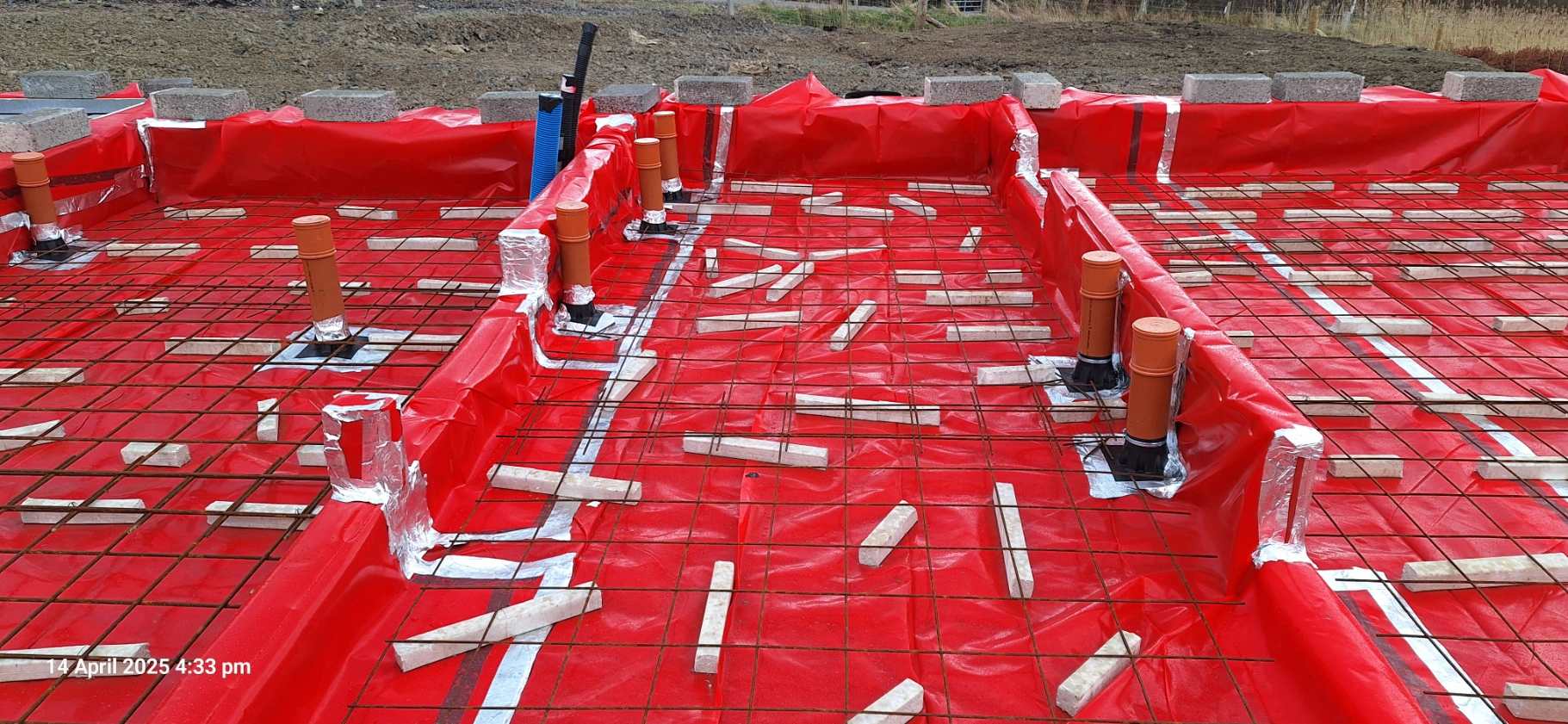

Dunc Posted April 15, 2025 Posted April 15, 2025 I noticed that my groundworker has provided the soil pipe penetrations of the slab with a male end up-over (currently covered with a female blank). I had expected to have female ends up as I presume it's usual to have flow from a male end to a female to reduce risk of leakage...is what he's done normal? (am I worrying about nothing prior to setting all this "in stone" 😉) 1
BadgerBodger Posted April 15, 2025 Posted April 15, 2025 It’s common to see pretty much all arrangements. If you’re using clay or cast pipe you don’t generally get female/male ends, only straight union couplers. It works fine. Same goes for twin wall. I like it when the builder leaves a coupler as you see there with a blanking plate left flush with the slab surface. Nigh guarantees you won’t damage the pipe through construction. 1
Nickfromwales Posted April 15, 2025 Posted April 15, 2025 2 hours ago, Dunc said: I noticed that my groundworker has provided the soil pipe penetrations of the slab with a male end up-over (currently covered with a female blank). I had expected to have female ends up as I presume it's usual to have flow from a male end to a female to reduce risk of leakage...is what he's done normal? (am I worrying about nothing prior to setting all this "in stone" 😉) You should thank your guys, they’re doing a very good job there. The female up theory is not ever what happens, and open pipe always gets cut and then a fitting placed on to it to carry on above the slab. Stand back and enjoy as the magic happens, and buy them a few slabs of beer as a thank you. Seems to be very meticulous work compared to some of the muppets I’ve encountered out there 1 1
BadgerBodger Posted April 15, 2025 Posted April 15, 2025 Agreed. Not often you actually see the double tape and top hats being used! 2
Nick Laslett Posted April 15, 2025 Posted April 15, 2025 @Dunc, looks great. You should be pleased with the results. The “mars bars” are much better than the “rebar chairs”. I had a mix with my SVP stacks of female coupler and just male ends, all protected with gaffa tape. No idea why I had both. You just use a slip coupler to start the new run from the FFL. 1

saveasteading Posted July 21, 2025 Posted July 21, 2025 On 15/04/2025 at 22:11, Nick Laslett said: "mars bars” are much better than the “rebar chairs”. In what way please I'm interested to learn? My comments after yours.
-rick- Posted July 21, 2025 Posted July 21, 2025 17 minutes ago, saveasteading said: In what way please I'm interested to learn? My comments after yours. Butting in where not asked but I thought the idea was its the same material. Less likely to get a path for water to get to the rebar and cause rust problems. Whether that really matters on a slab wrapped in plastic like @Duncs I've no idea.
saveasteading Posted July 21, 2025 Posted July 21, 2025 38 minutes ago, -rick- said: thought the idea was its the same material. Not really. The main purpose is that the reinforcement is at the intended position. When the slab tries to bend under load, the steel goes into tension and takes the load. It needs concrete all around it and so be off the bottom. The supports can be concrete as shown, or butterfly shapes, or can be plastic usually in wheel shapes. For a ground bearing floor slab it isn't going to matter. Pre-guessing @Nick Laslett likes the convenience. And that lots, as shown, allows walking over the mesh. 1
