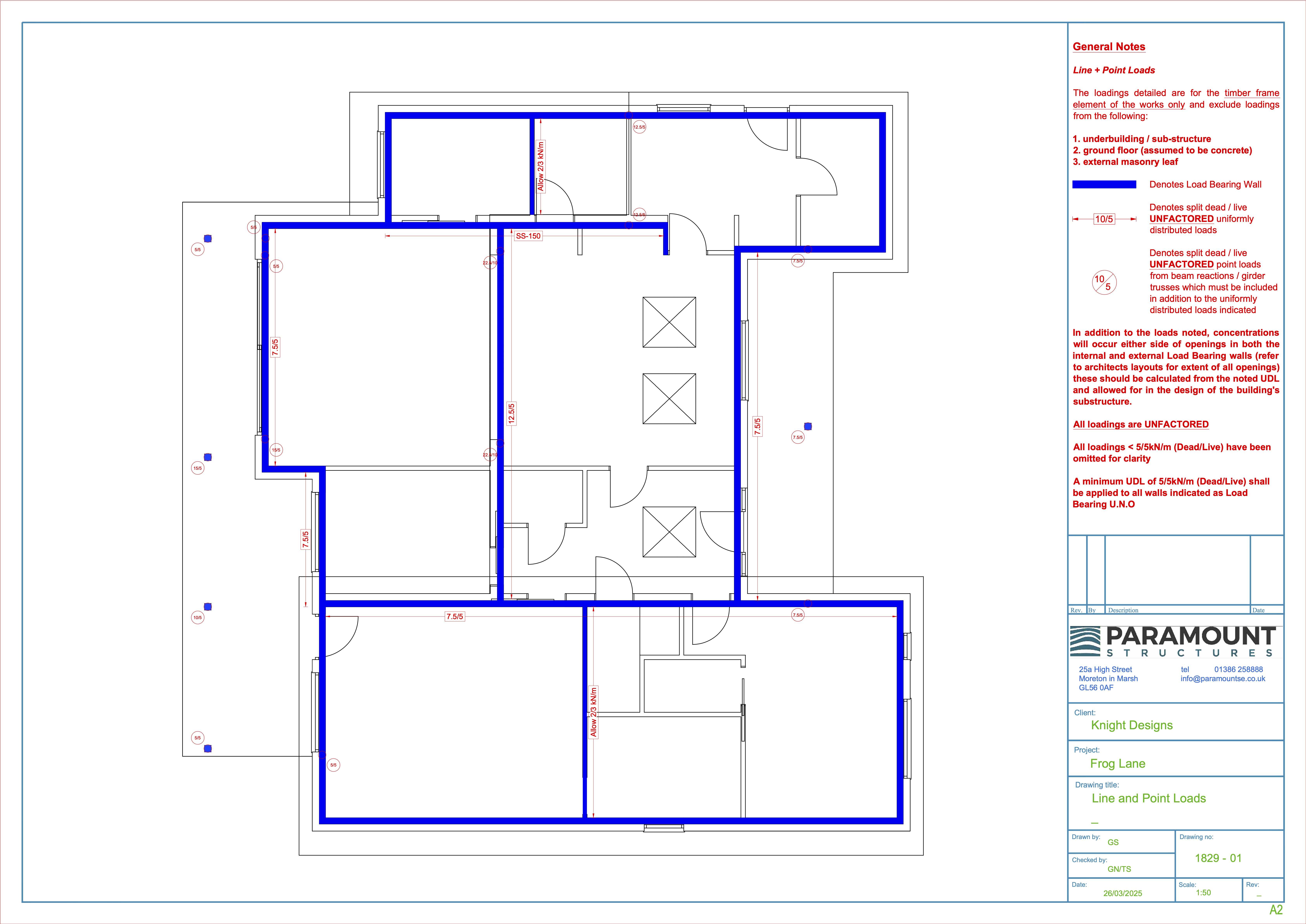

Benpointer Posted April 11, 2025 Posted April 11, 2025 Hi all, I have this from our TF co's designers, which will presumably dictate the foundation depths. Can anyone help me decipher it? I don't absolutely need to know but as part of our self-build journey, I'd like to understand it if at all possible. Presumably "15/5" "12.5/5" etc. means something important but what? I assume the loadings are all quite light, at it's a single storey TF construction clad in a combination of timber and render/cement panels. Thanks in advance for enlightening me! 1829 - 01 Frog Lane-LP.pdf

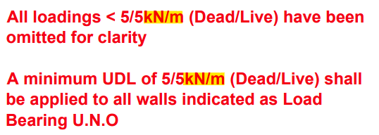

IanR Posted April 11, 2025 Posted April 11, 2025 23 minutes ago, Benpointer said: , I'd like to understand it if at all possible. Presumably "15/5" "12.5/5" etc. means something important but what? The drawing Key helps you here: First figure is dead load, second is live, the units will be kN/m. 2 1

Alan Ambrose Posted April 11, 2025 Posted April 11, 2025 Unfactored, if I remember rightly, means no safety factor applied i.e. the actual calculated numbers. (Because, you only want one safety factor applied - if the timber frame guy applies a 2.5x safety factor and the foundation person applies 2.5x also, then you soon end up with something much stronger / heavier / more expensive than you need. ‘Dead’ is loading of construction materials, ‘live’ is assumed load from people, furniture, dancing, your grand piano etc - usually taken from NHBC assumptions. There’s also wind load, not listed there. 2
SteamyTea Posted April 12, 2025 Posted April 12, 2025 20 hours ago, IanR said: units will be kN/m. Should that be kN/m²? If I remember correctly, N is a newton, which is mass in kg multiplied by acceleration. So a 100 kg sitting on the ground is: 100 (kg) x 9.81 (m.s-2) =981 N. Spread that over an area of 0.25 m² and you get 3924, so with a bit of rounding, 4kN.m-2. 1
IanR Posted April 12, 2025 Posted April 12, 2025 (edited) 1 hour ago, SteamyTea said: Should that be kN/m²? Nope, line loads are used to calculate the loads the walls put into the foundation. ie. 10kN/m = just over 1 Tonne-force per meter length of wall. Edited to add: From the Drawing Edited April 12, 2025 by IanR 1

saveasteading Posted April 12, 2025 Posted April 12, 2025 31 minutes ago, IanR said: line loads are used to calculate the loads Because the walls are linear. Then the width of the footing will turn it into /m2. Safety factors...different factors are applied to dead/live/wind in a realistic way. As the chance of everything being at maximum*, plus 1m of snow on the roof plus a hurricane at the same time is low. * the building weight is known. Then you allow for a reasonable amount of furnishing and people. Not grand pianos everywhere and dancing. These figures are standard and published, but are changed by purpose if it is e.g. a fitness room. There are other safety factors built into the structure itself, for inferior materials or workmanship. The other thing the SE looks at is proximity of trees and the effect on the ground. 1
