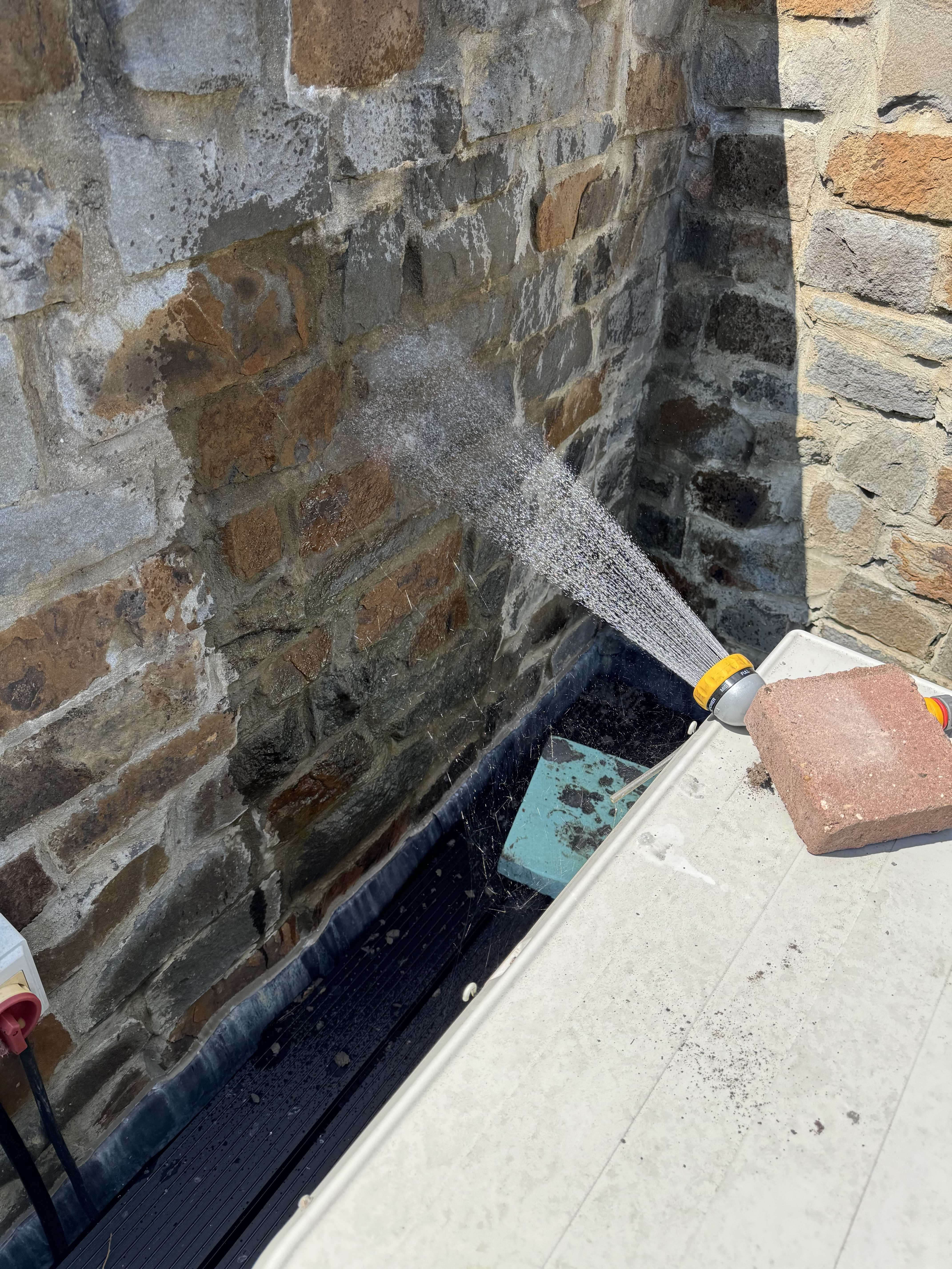

Pocster Posted May 16, 2025 Author Posted May 16, 2025 23 minutes ago, MPH243 said: You might find 2 minutes is not enough to get a small amount of water to get where you want it, maybe 10 min on spray. Try to replicate rain as splash zone will be included. I am sure you will get this eventually. Yeah I did think that . How much is ‘enough ‘ ……
MPH243 Posted May 16, 2025 Posted May 16, 2025 If I lived nearer I could send one of the kids over to do it, but they would just spray everything including inside🤣. How about modifying a sprinkler to spray a limited area. (not sure how to though)
Pocster Posted May 17, 2025 Author Posted May 17, 2025 Hosed that front wall today for a change . Nothing ….
Pocster Posted May 20, 2025 Author Posted May 20, 2025 Have now hosed all the walls - nothing . Looks like we’re due heavy rain tomorrow- so the ultimate test !!!

MPH243 Posted May 21, 2025 Posted May 21, 2025 That's a shame, I think you need to just spray your water over areas further away than where you think it is. Use your 10min over 3 or 4 foot area. That's what you get for living in a cave🤣. 1
Pocster Posted May 22, 2025 Author Posted May 22, 2025 I made the (expletive deleted)er leak !!!! Been hosing various areas all day long with no joy . So can’t be certain of which bit tbh - but all areas tested today in the same area !! 1

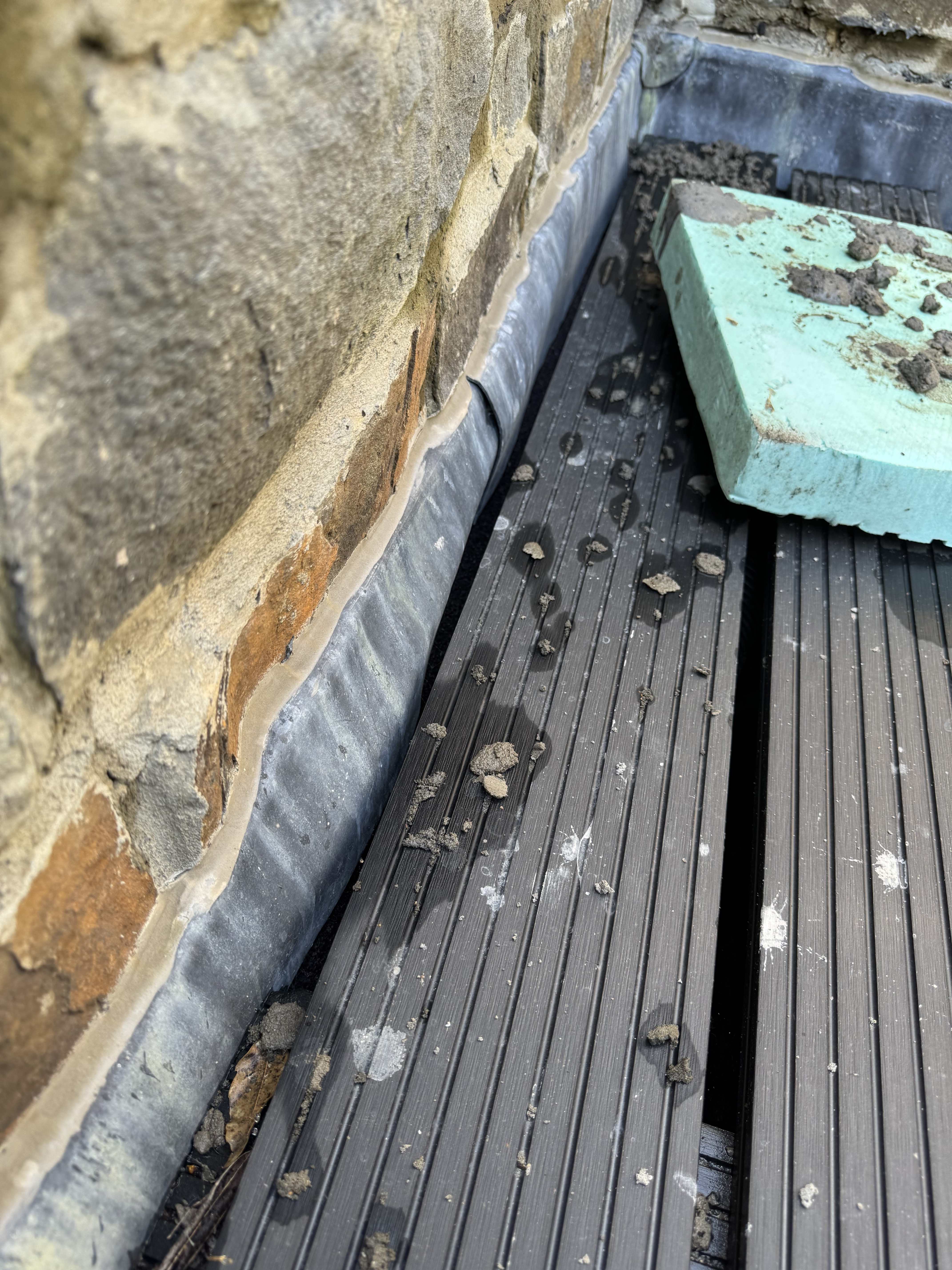

Pocster Posted May 22, 2025 Author Posted May 22, 2025 Ok ! This area . Jet on it for 15 mins - leaks It could be the flat roof damaged underneath the decking . But , that flashing seam looks like a possible candidate!!
Pocster Posted May 22, 2025 Author Posted May 22, 2025 Assume that seams the issue . Just fill with ct1 ? Notice the roofers ‘gunk’ where the seam goes into the angle grinded wall slot is slightly recessed compared to the rest ….
Pocster Posted May 22, 2025 Author Posted May 22, 2025 4 minutes ago, Andehh said: That looks suspicious to me, Yep - what to fill it with though ? - I guess it probably doesn’t matter ….???
Andeh Posted May 22, 2025 Posted May 22, 2025 Clean as deep as you can with builders wipes, let it dry then Ct1 or equivalent, slightly warmed and pushed in deep! Smooth to finish. 1
Pocster Posted May 22, 2025 Author Posted May 22, 2025 12 minutes ago, Onoff said: Overlapping lead flashing joint? Yep

Pocster Posted May 22, 2025 Author Posted May 22, 2025 2 minutes ago, MPH243 said: Thank goodness you have found a likely place. This could of gone on for years😁 I’ve got a feeling it’s always been like that ! So the roofers error ! . Anyway , need to fix it 1st - hose it forever , then celebrate if no leak ! 😊
MPH243 Posted May 22, 2025 Posted May 22, 2025 Are you taking that piece of decking up as well to check what is below?
Pocster Posted May 22, 2025 Author Posted May 22, 2025 Just now, MPH243 said: Are you taking that piece of decking up as well to check what is below? Yeah . I’ll take that area up anyway .
