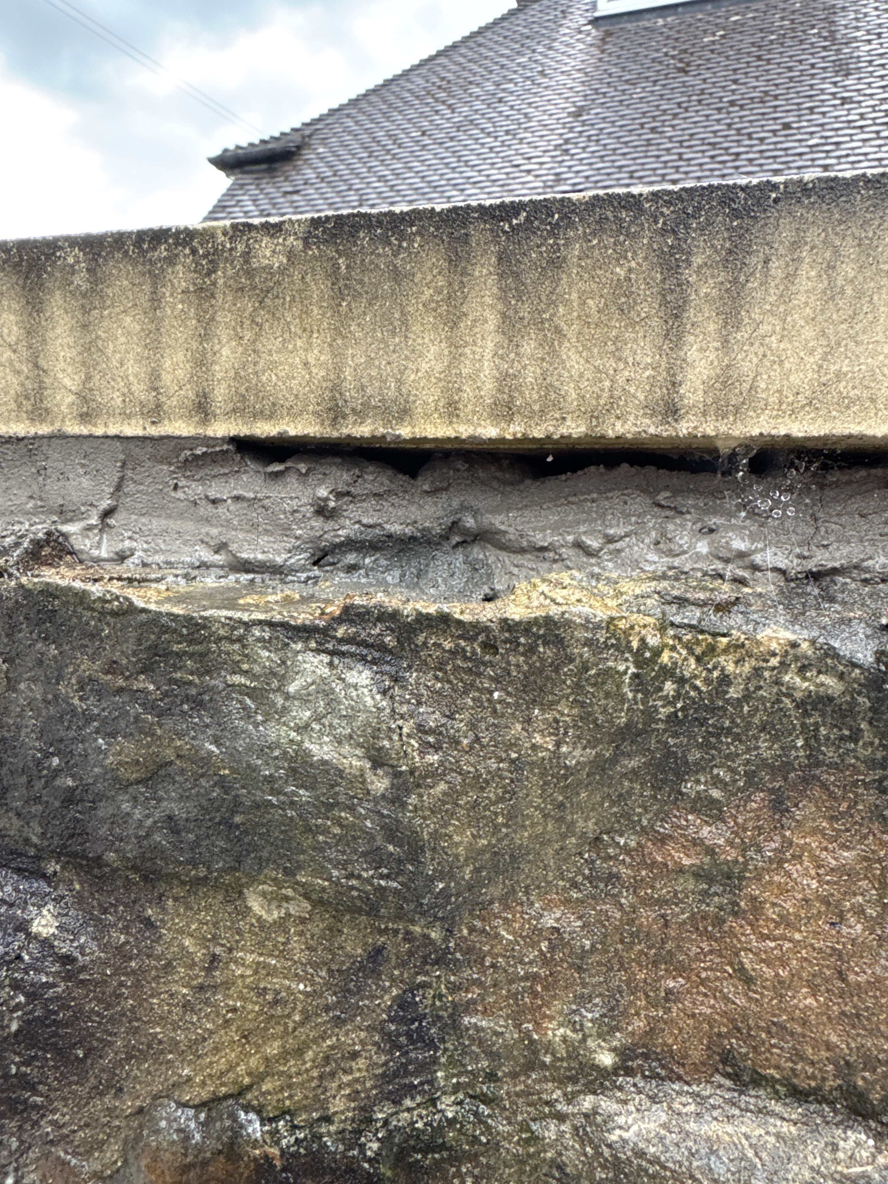

Pocster Posted April 30, 2025 Author Posted April 30, 2025 Was touch clammy on the leak spots this morning . So decided to tip carefully 2 watering cans of water over just the roof seams . Hour later no evidence of a drip . Hosed just the bottom 25cm of the render - so testing that stone joint and the roof seams again . Hour later no evidence of additional water ingress …. Going to try hosing the entire corner but not over the coping stone . Potentially as the coping stone is twice weathered water could run off in both directions .
Pocster Posted April 30, 2025 Author Posted April 30, 2025 Zero water ingress as far as I can tell . So … need to look at that coping stone - the other side !

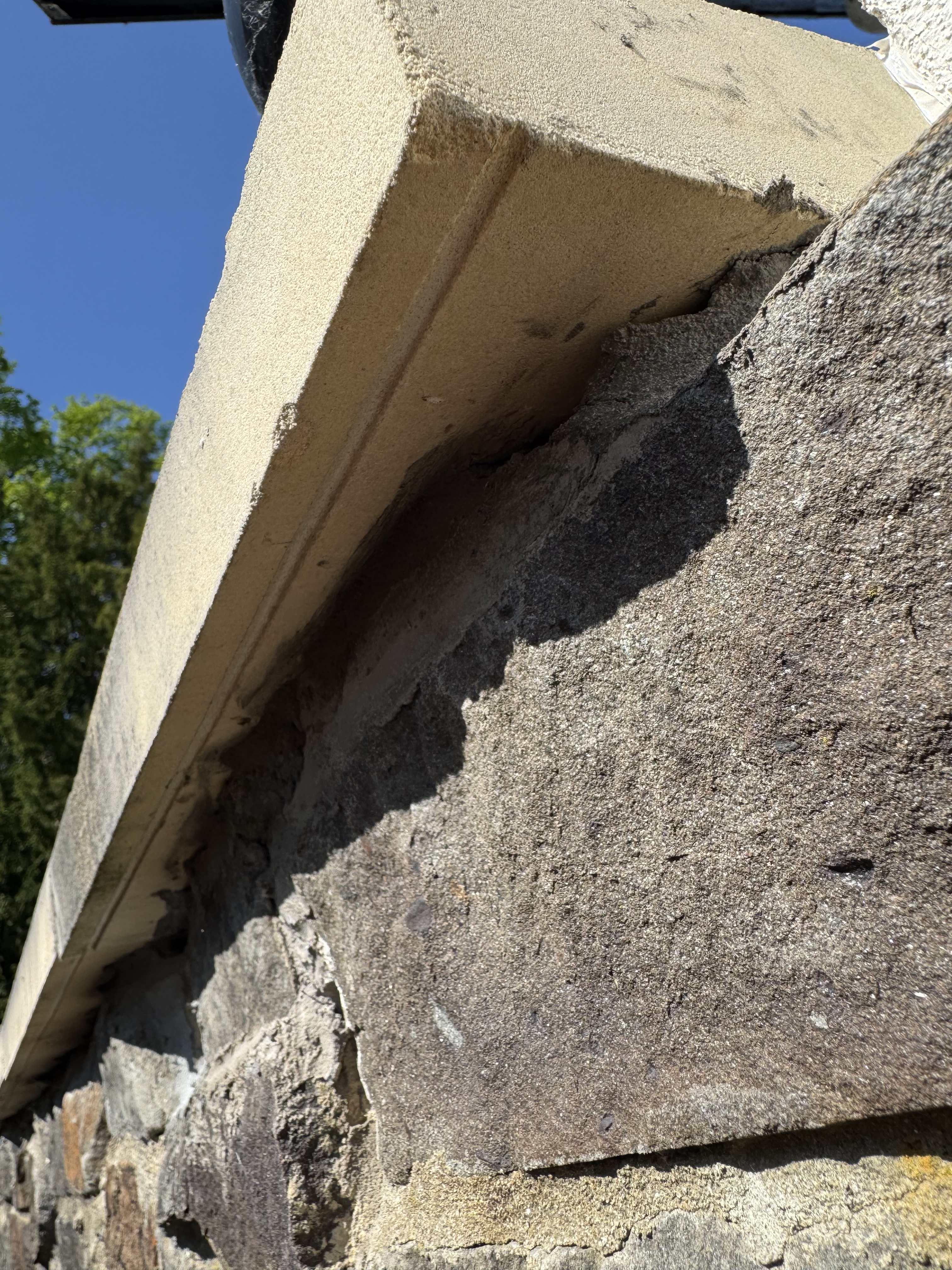

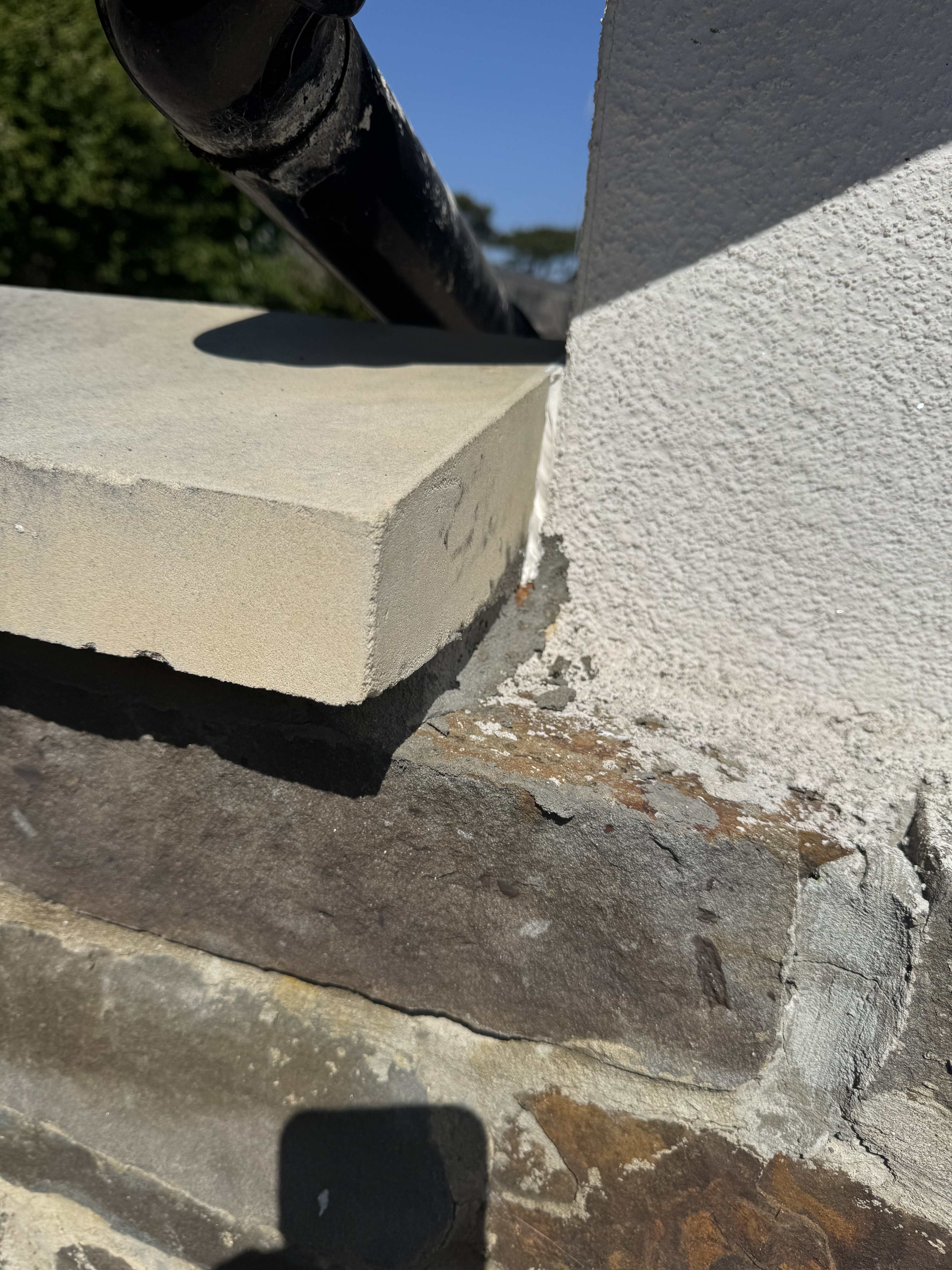

Pocster Posted April 30, 2025 Author Posted April 30, 2025 Hmmmmm Some gaps . So I guess in theory when I hose the wall and coping stone it could run down this side - track under pass the drip channel . There are gaps - so will mix some cement and fill them
Pocster Posted April 30, 2025 Author Posted April 30, 2025 Really want a better way to finish that edge - some form of flashing ???

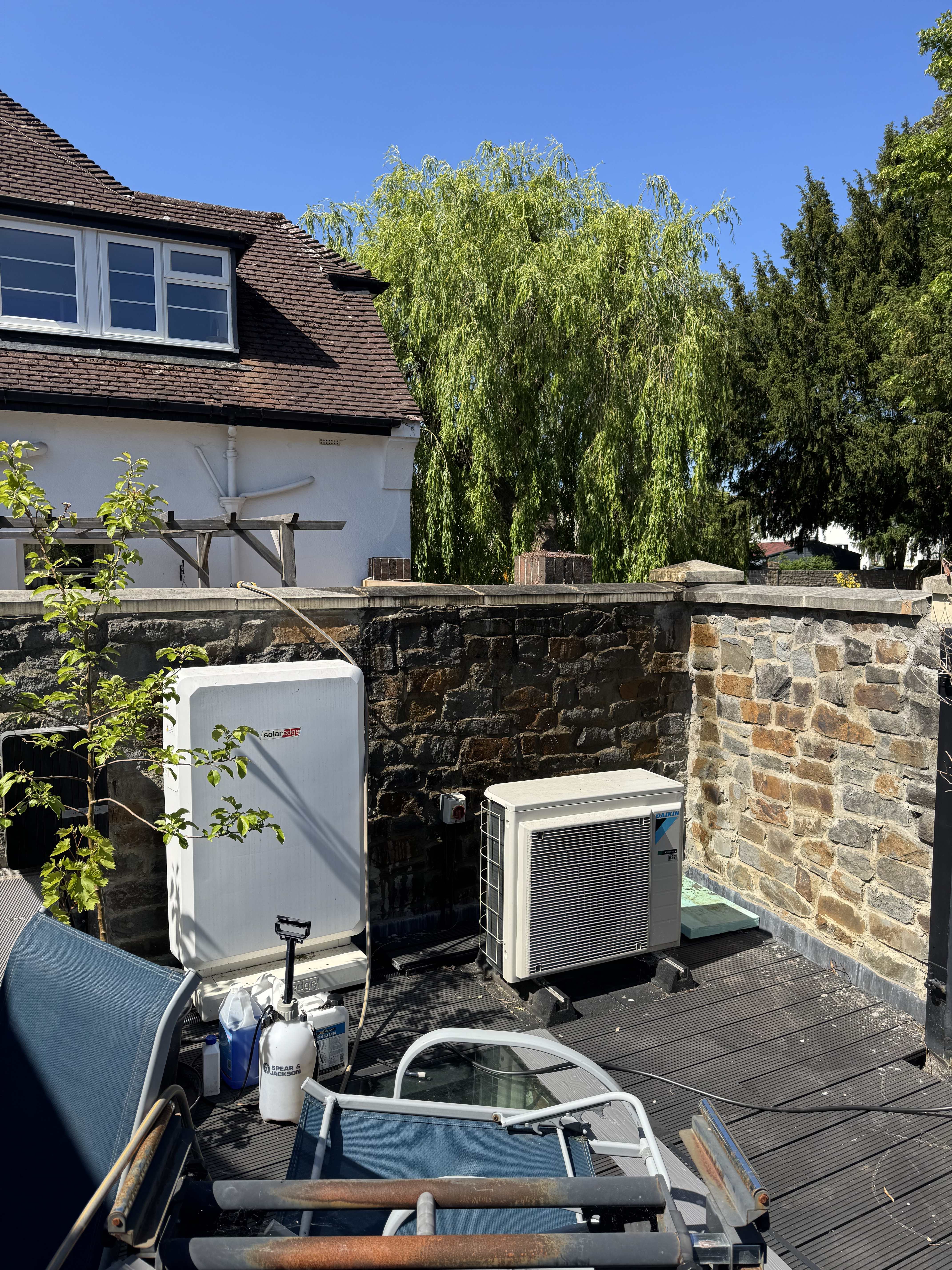

Pocster Posted May 11, 2025 Author Posted May 11, 2025 Bummer ! Still leaks ! Considerably less though . That corner is bone dry so not there . i did notice this though … when the sun comes and it’s dry going to hose just that bit
Pocster Posted May 11, 2025 Author Posted May 11, 2025 (edited) Clearly any of that wall is an issue as it sits on the slab . So I’ll fill more of those gaps but that doesn’t mean a hairline gap couldn’t open up . Might put a line of ct1 right in that edge I.e where the coping stone meets the wall stone . Over the entire wall , both sides .Think I’ll need to inspect the wall every year for any vulnerabilities…. Edited May 11, 2025 by Pocster 1
Pocster Posted May 13, 2025 Author Posted May 13, 2025 Filled all those tiny gaps . Had rain , still leaks ! Nothing else visually obvious to check !!
