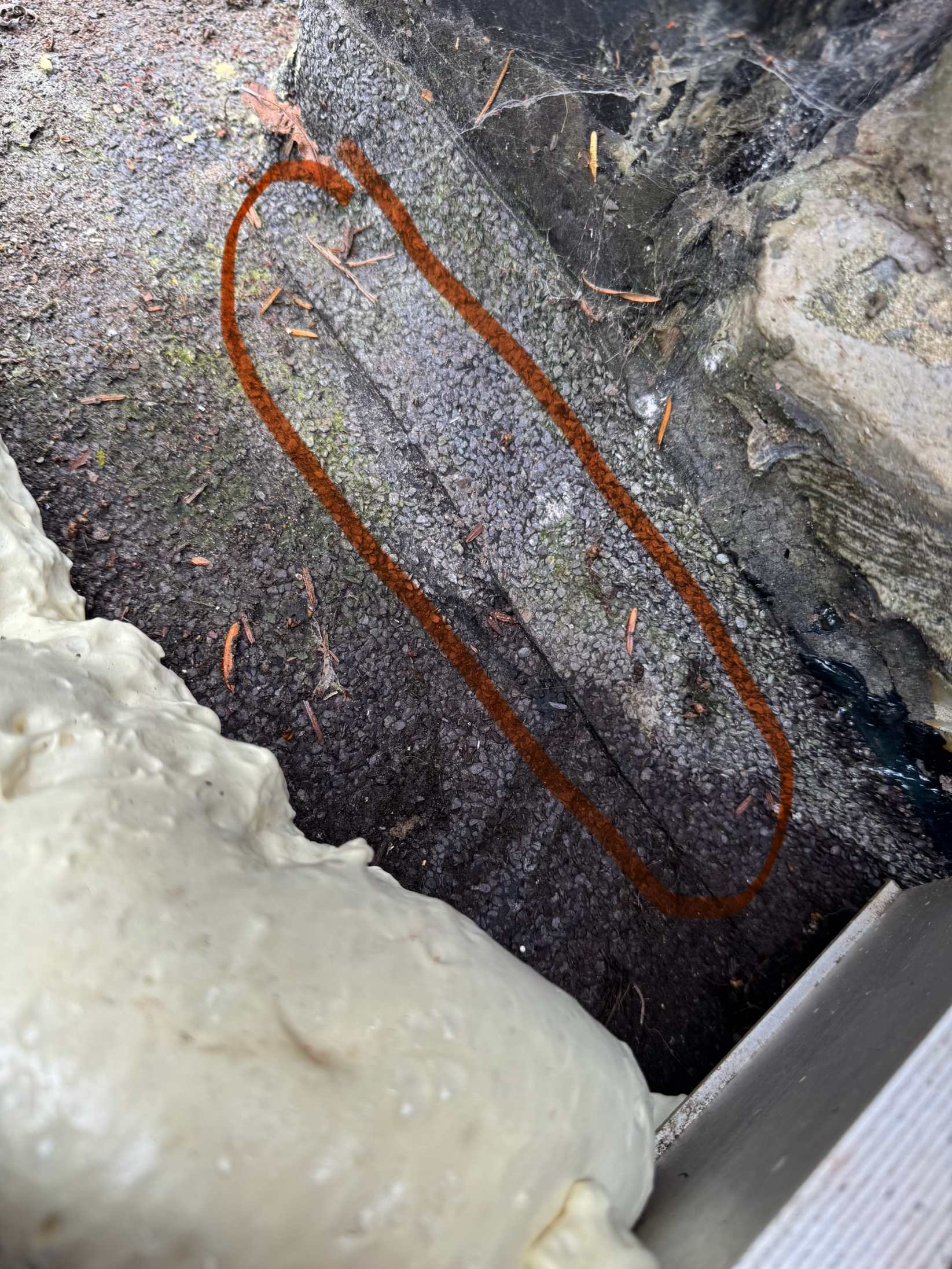

Pocster Posted June 16, 2025 Author Posted June 16, 2025 The results are …. Inconclusive! Still damp inside from yesterday- but no obvious drip . Will leave now and check every 30 mins …

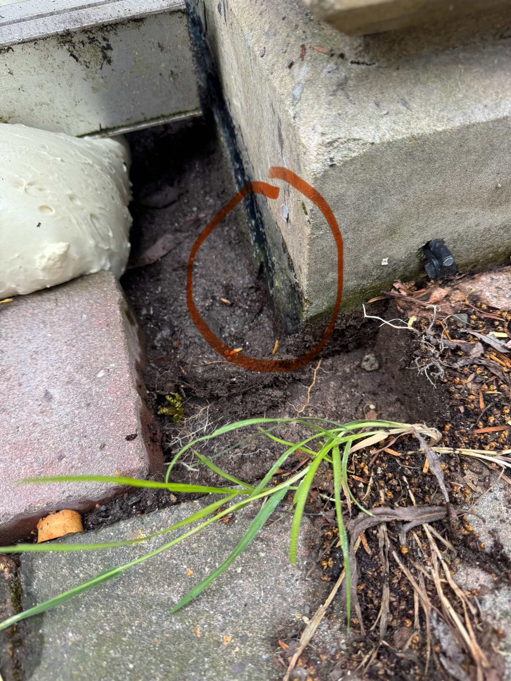

Pocster Posted June 16, 2025 Author Posted June 16, 2025 I notice now these tiny gaps . Will ct1 them once a bit drier

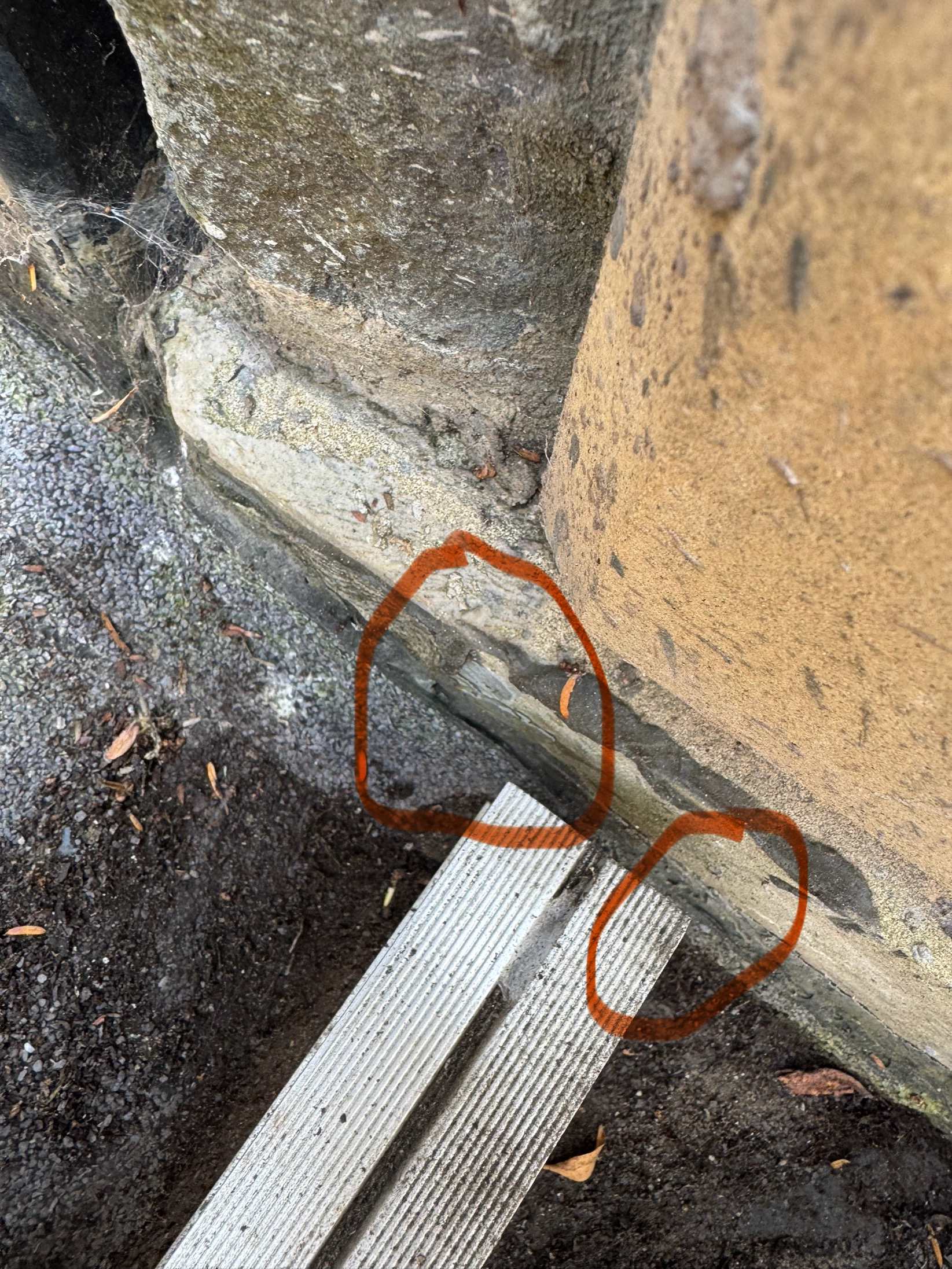

Pocster Posted June 16, 2025 Author Posted June 16, 2025 You know I think it’s less . Whilst damp and I could see a droplet - not enough has come through to drip to the floor ! So wil ct1 that bit now !

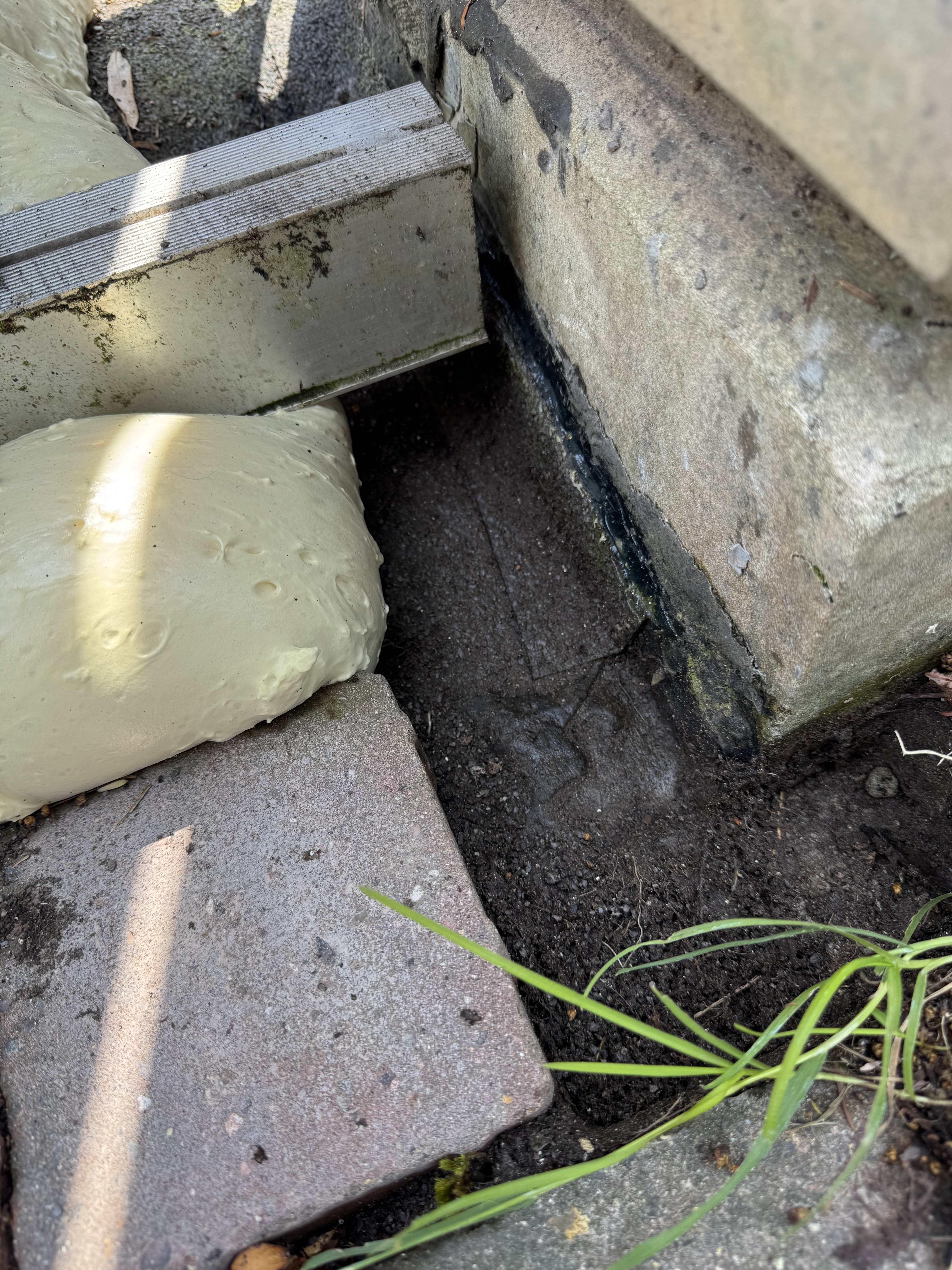

Pocster Posted June 17, 2025 Author Posted June 17, 2025 I think the problem exists because the water pools there when overwhelmed. I could remove paving blocks to avoid that . But I’d rather it can deal with the pooling . Cleaned it up as best I can . Will ct1 the asphalt overlaps and that end again .
Onoff Posted June 17, 2025 Posted June 17, 2025 5 hours ago, Pocster said: I think the problem exists because the water pools there when overwhelmed. I could remove paving blocks to avoid that . But I’d rather it can deal with the pooling . Cleaned it up as best I can . Will ct1 the asphalt overlaps and that end again . Just paint the lot with a flexible bituminous paint, concrete, felt, overlaps etc. You've too many maybe points so "tank" the lot I would.
Pocster Posted June 17, 2025 Author Posted June 17, 2025 10 minutes ago, Onoff said: Just paint the lot with a flexible bituminous paint, concrete, felt, overlaps etc. You've too many maybe points so "tank" the lot I would. Yeah I know ; but that’s hit and hope …. Do me a favour and link to a suitable product on Amazon ? Was not going to test tomorrow- give ct1 more time to cure . If Thursday it leaks I’ll blast that corner with what ever you suggest ; yeah bro ? 👊🏻

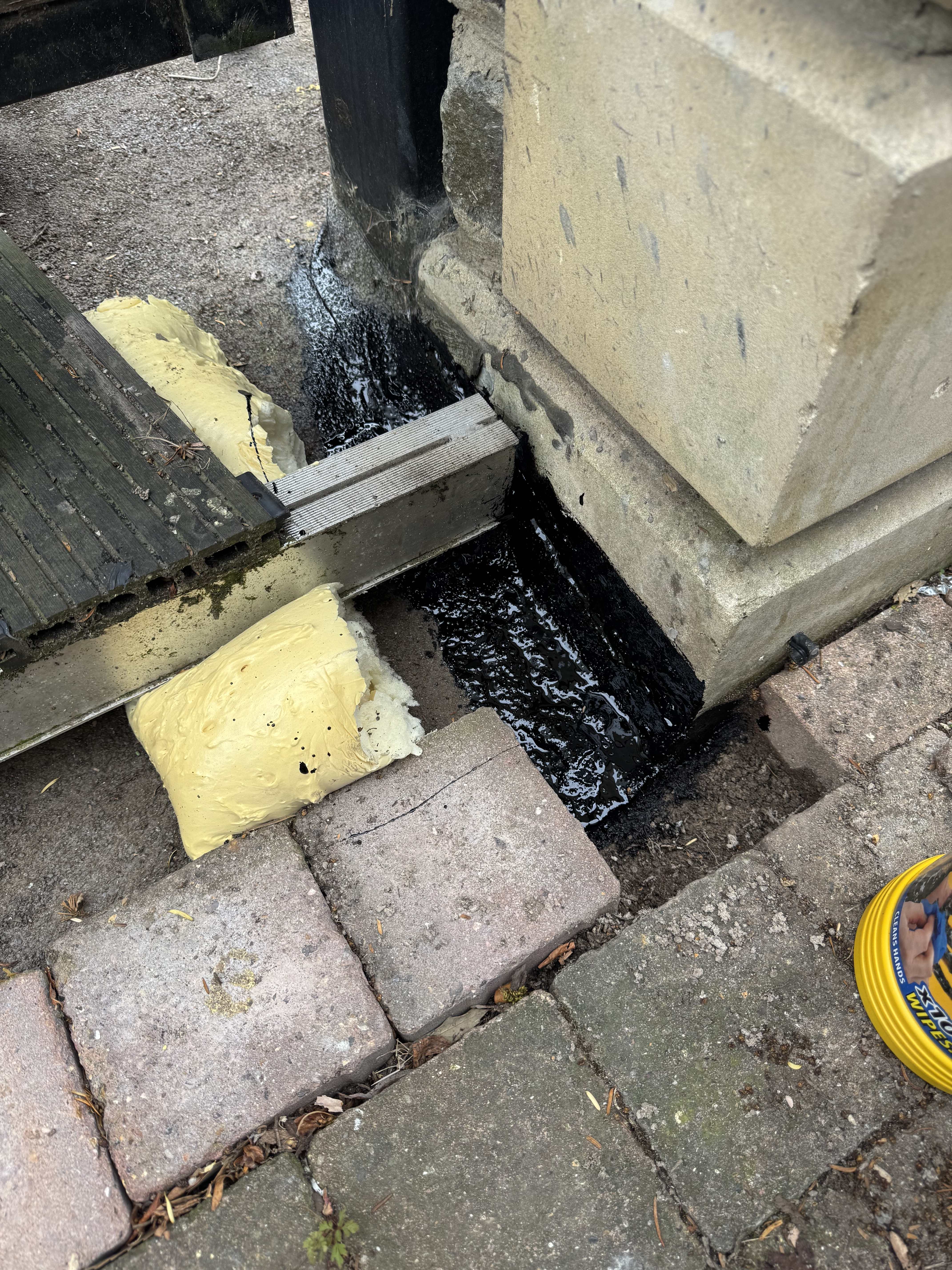

Pocster Posted June 19, 2025 Author Posted June 19, 2025 I would say it still leaks . Just a tiny bit damp - but was still damp from 2 days ago ! ( didn’t test yesterday ) .So will let it dry out and bitumen paint that area tomorrow
Pocster Posted June 20, 2025 Author Posted June 20, 2025 Bitumen paint applied . Pretty warm today so will go over it again in 5 hours or so 3
