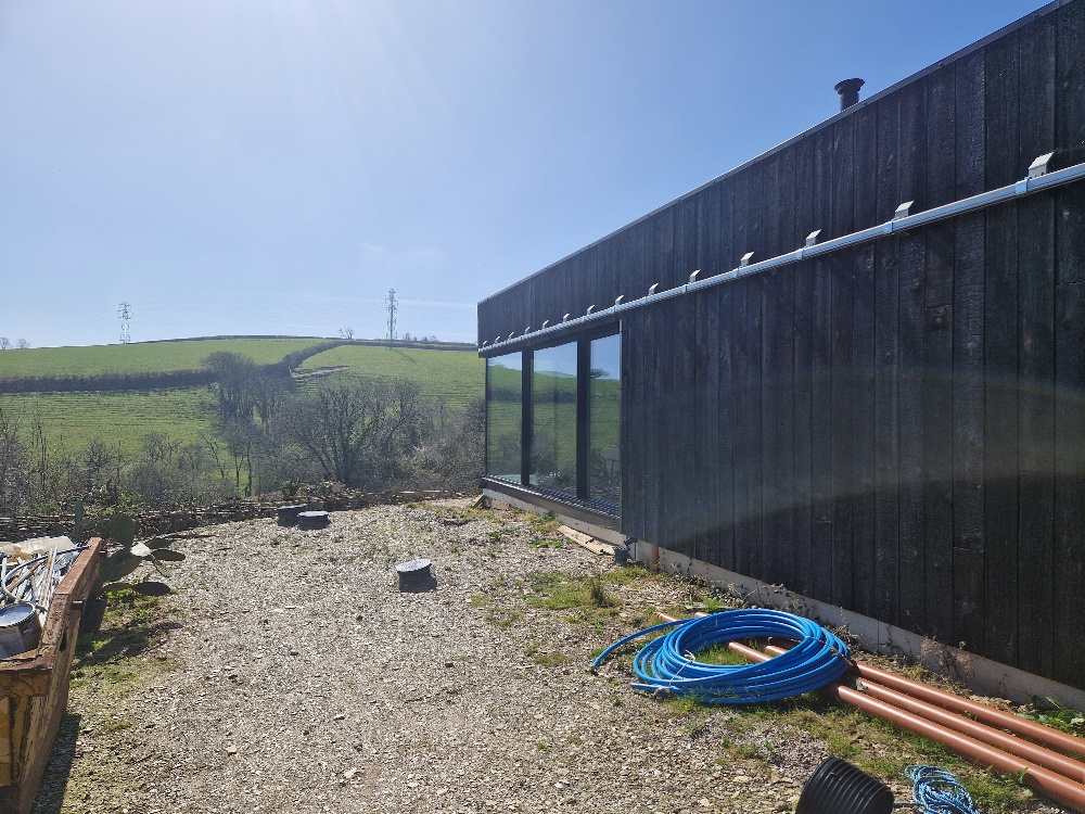

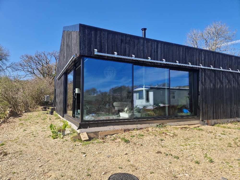

Tom Posted March 31, 2025 Posted March 31, 2025 Hi all - now that we're acually in the house, much of the drive to actually complete the landscaping has evaporated, but I really need to knuckle down and get this sorted. We have some wraparound glazing at one corner and want to put some decking here to give as close to level threshold as I can. I'm not keen on composite, wood would be OK, but I've been toying with the idea of using beam and block which I think would fit in with the overall design of the place, see pics. Is there any glaring reason why this wouldn't be possible? As it's not really a loadbearing thing, could I just sketch it out and order the bits, or should it be designed properly by a structural engineer? Thanks all 1
Conor Posted March 31, 2025 Posted March 31, 2025 Would you not just raise the ground level with stone and pave? Would be a lot simpler and cheaper.
markc Posted March 31, 2025 Posted March 31, 2025 (edited) As above, B&B would be more work, more concrete, leave a gap underneath and still need screed/bedding for the pavers or stone etc. P.s. no need for any calcs etc. if you did want to use B@B Edited March 31, 2025 by markc
JohnMo Posted March 31, 2025 Posted March 31, 2025 B&B sounds naff.👎 Level decking 👍 finish how you want. Patio👍 You may need a French drain or similar to keep water out.
Russell griffiths Posted March 31, 2025 Posted March 31, 2025 (edited) Sounds a hideous idea, you can get reasonable paving for £25 a metre, or if budget is tight prepare the area with type 1 and cover in a gravel of your choice for a year or two until you can afford the paving. or my neighbour has used 200mm wide oak boards 25mm thick for a very rustic deck. Edited March 31, 2025 by Russell griffiths 1
saveasteading Posted March 31, 2025 Posted March 31, 2025 I like b and b and have used it a lot. For buildings. This doesn't need it. In fact it's a bad idea i think, in practice and cost. As above. Fill and pave with a slope away from the house. Or gravel, or a mixture.
Tom Posted March 31, 2025 Author Posted March 31, 2025 Ok, ok enough already! So the idea's shit, i get it! I agree, building the level up and paving makes more sense... What was I thinking?!😵💫 1 1

Russell griffiths Posted April 1, 2025 Posted April 1, 2025 If you don’t want paving you could use the steel decking system and some rustic boards to match/ contrast with the house. 1

Temp Posted April 4, 2025 Posted April 4, 2025 I think B&B would work well but might be a bit more complicated. You would probably need to build walls for each end of the beams to rest on. The wall near the house could be just blocks. The one furthest from the house probably brick and block or block clad with timber. Once done any paving or tiling on top would be pretty bomb proof.
