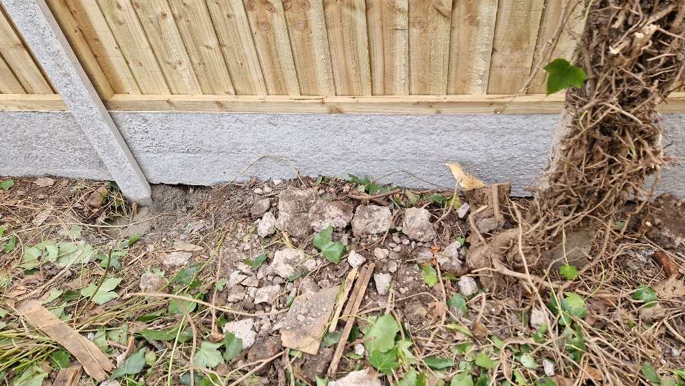

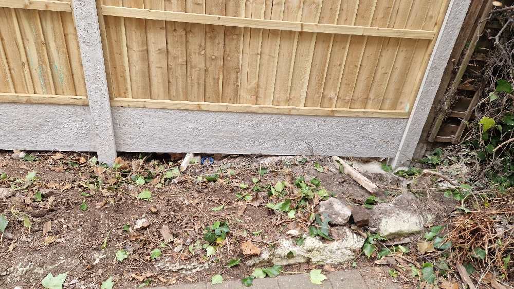

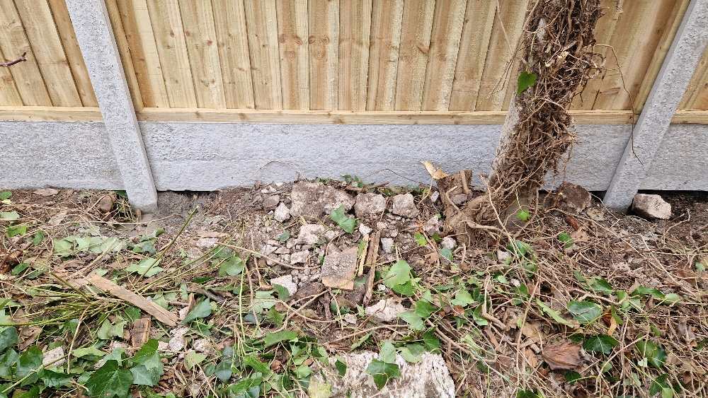

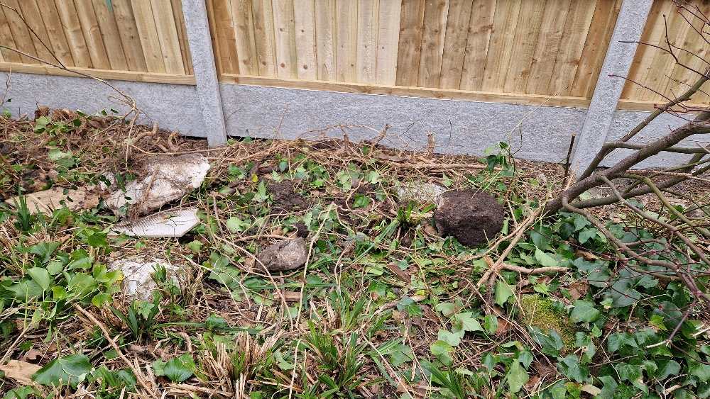

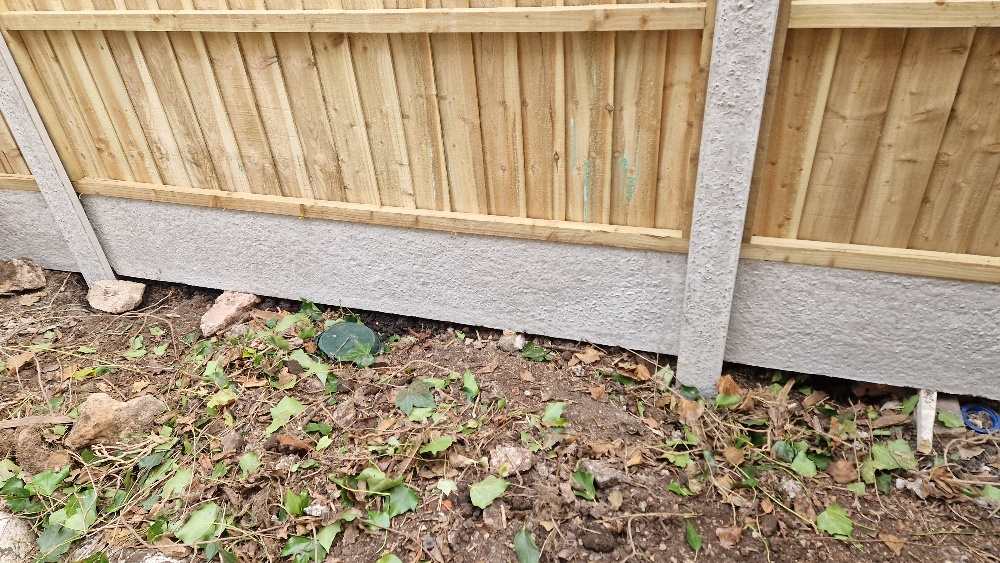

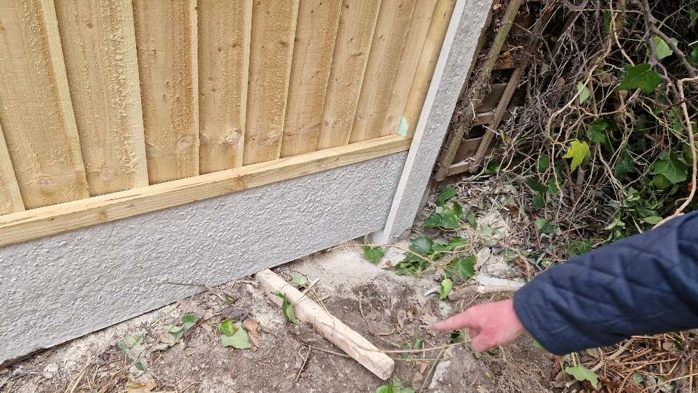

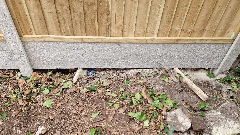

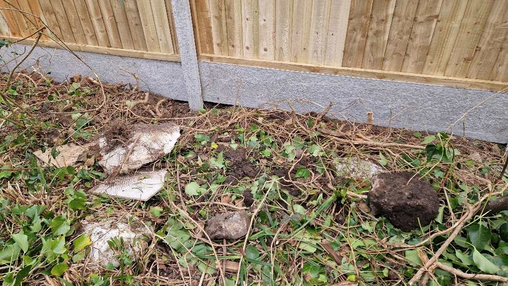

Zak S Posted March 17, 2025 Posted March 17, 2025 Hi I had around 17 panels installed over the weekend and these look like as per the pic. There is a slight slope away from the house. Ground is a bit uneven and it gets a bit boggy in winter. On my side the fencer filled in the soil to hide away any gaps under the gravel board (not that there should be any) but these gaps were left on the neighbour side and I got the complaint as soon as they left. From the neighbour side it looks like as per the close up photos. Please could you advise how bad it is and if it can be fixed easily so that fence panel stay aligned. Contractor said that he will come back and infill with soil and bark and fill the area around posts with postcrete. He says that they don't normally do the footing or trenches unless there is significant slope which I don't have. The neighbour said that they should have done a trench and footing. What are your thoughts and how can it be fixed? Thanks
twice round the block Posted March 17, 2025 Posted March 17, 2025 Concrete posts and gravel boards can be a pain at the best of times. Personally I'd do as the contractor said... bark and top soil to fill in the gaps. If you start digging out to drop the gravel boards you could end up with a fence top that is out of line in-between bays. Did your delightful neighbour share the cost?????🤩 1

Russell griffiths Posted March 17, 2025 Posted March 17, 2025 I would want the post Crete up high enough to support the gravel boards, it looks ok at the moment but in a years time when all those little bits of timber have rotted the gravel boards will sink down. 2

torre Posted March 17, 2025 Posted March 17, 2025 Tidy looking fence but as @Russell griffiths said, those bits of timber will rot and the gravel boards drop eventually Is that foot long piece being pointed to on the neighbours side? You can't expect them to be happy with that!? I'd put a brick below that end of the board before they pull the timber out (and your panel drops) 2
Temp Posted March 17, 2025 Posted March 17, 2025 +1 I'd find something that can't rot (perhaps half bricks and broken roof tiles?) and wedge between the postcrete and the underside of the concrete barge boards. Do both ends then pull out the wood and random packing they used. Chuck buckets of topsoil to cover up the half bricks. Bit of a pain. 1

Zak S Posted March 18, 2025 Author Posted March 18, 2025 7 hours ago, torre said: that foot long piece being pointed to on the neighbours side? That's right. It's on the neighbours side. The contractor accepted that its not right and will come back to tidy up but was against the idea of trench and footing for the gravel board (idea which the lovely neighbour suggested that I should have done).
