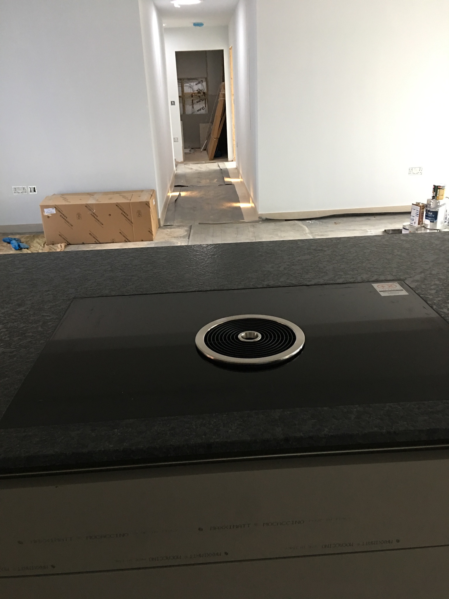

The BFIU and yes it is very quiet. I'm open plan and its certainly good enough. We have tested a few things on it as kitchen is in and hob is working but we are not in yet ...we have no bathrooms!
I am hugely pleased with it I wanted the funky ring in the middle and 'invisible' controls rather than slot vent and knobs.

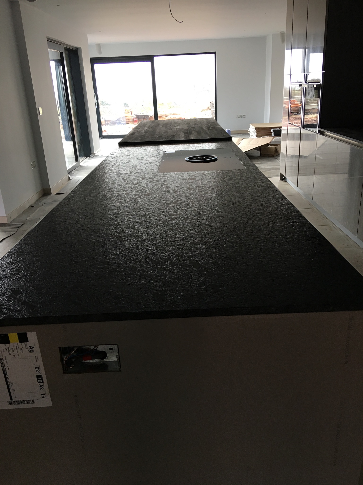

I’m sure she wouldnt regret it. I have Island 5.2m long and Bora is set into honed granite.....its a defininte WOW as well being brilliant piece of kit

I totally love my bora. Just this minute finished cooking a steak (for my poorly woofer).  I think its the best hob I have had to date and I have had a few inductions.  I have flexi with recirculation and it works like a dream.
@lizzie just seen the photos of your kitchen. Wow, its fantastic.
I love the hob sunk into the granite.
What a wonderful idea, no chipping the edge of the hob.
