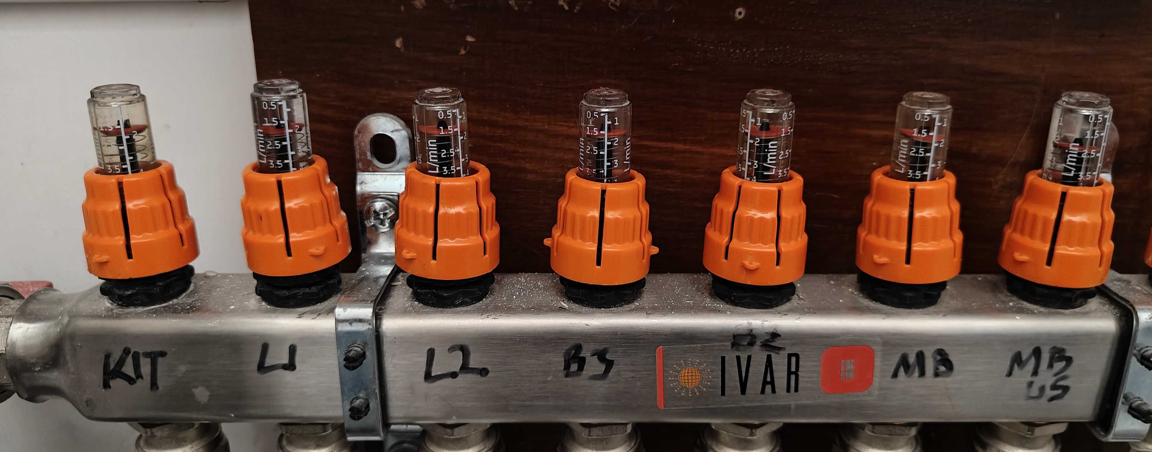

Nickfromwales Posted Friday at 21:54 Posted Friday at 21:54 26 minutes ago, JohnMo said: Do exactly the same without buffer or LLH Then the circulation pump ramps up / down, so flow through the loops follows suite? Long in-fill house with east (front) / west ends, so I wanted heat from each area (zone) to be in constant equilibrium; to steal heat from one place and distribute it to another. I remain sceptical about how well that would happen with reduced pump potential on the UFH loops at the manifold.
JohnMo Posted Friday at 22:48 Posted Friday at 22:48 47 minutes ago, Nickfromwales said: Then the circulation pump ramps up / down, so flow through the loops follows suite? Pretty much, but only between 14 and 19L/min (less what goes via fan coil). This is the loops at min flow, so plenty of flow. 52 minutes ago, Nickfromwales said: to steal heat from one place and distribute it to another Do it for the same reason, living room gets plenty of solar gain so moves that heat to back of house. 1

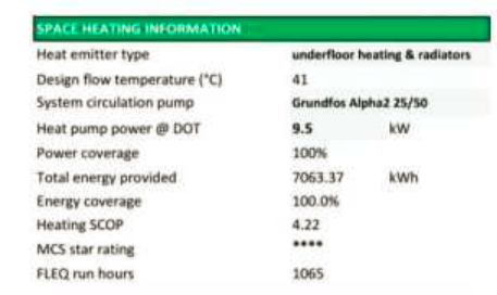

sharpener Posted Friday at 23:48 Posted Friday at 23:48 (edited) 2 hours ago, YorkieSelfBuild said: The 9.5 is the outdoor design temperature DOT -3.4C (from their website https://www.imsheatpumps.co.uk/blog/understanding-your-heat-curve/) As I have a 12kW Vaillant their heat curves are all familiar stuff but doesn't really explain what the 9.5 figure is, what its dimensions are and whether there is another figure missing between "9.5" and "kW", can anyone else shed any light? If IMS are your installers then it is odd their web site lists Vaillant and Nibe HPs which are both high end of the market but then they propose a Riello which is not. Edited Friday at 23:53 by sharpener

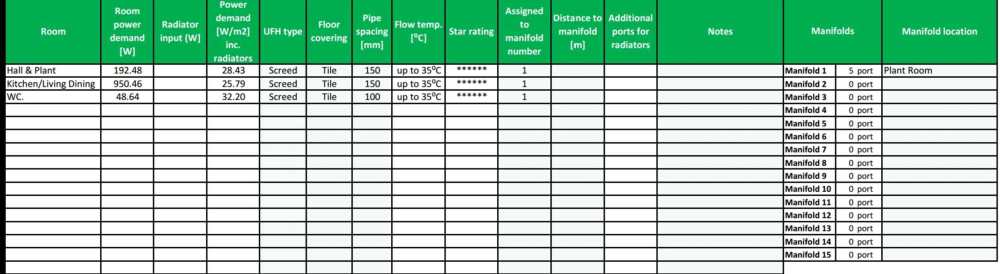

JohnMo Posted Saturday at 08:37 Posted Saturday at 08:37 15 hours ago, YorkieSelfBuild said: Not PassivHaus but quite close. MVHR, PV, SIPs, insulated, triple glazing, etc House still being built so assume no air test. And 120m² So to out that into perspective, we are similar build, but have 192m² living space plus 26m² plant room/store, not quite twice the size. Our heat demand at -9 is 3.5kW. So you should really be installing a 4kW heat pump. Or a 6kW if you want the ability to batch charge the floor in cheap periods (like a storage heater). But you need a decent depth of screed for that also. 1
JohnMo Posted Saturday at 08:53 Posted Saturday at 08:53 Really wouldn't get to hung up on the R32 V R290. R290 is great if you need high flow temperature, not much different otherwise. More important is system design. Your design with UFH and rads is generally fine. You don't have to have the rads on. You could have then on, and run the whole system cooler, plus the additional water volume is good. I would say the rads need to be designed for the same flow temp as UFH, so you have no mixers or additional pumps. Run the whole system as an open loop single zone. Just TRVs on bedroom rads if you need them. Notes on design Installer cannot take credit for airtightness, unless you have a test certificate, they cannot take credit for MVHR if not installed and certified. These all drive the kW required up. The standard heat loss spreadsheet has some big air change numbers in it, which do not truly reflect a house that is airtight with heat recovery ventilation.

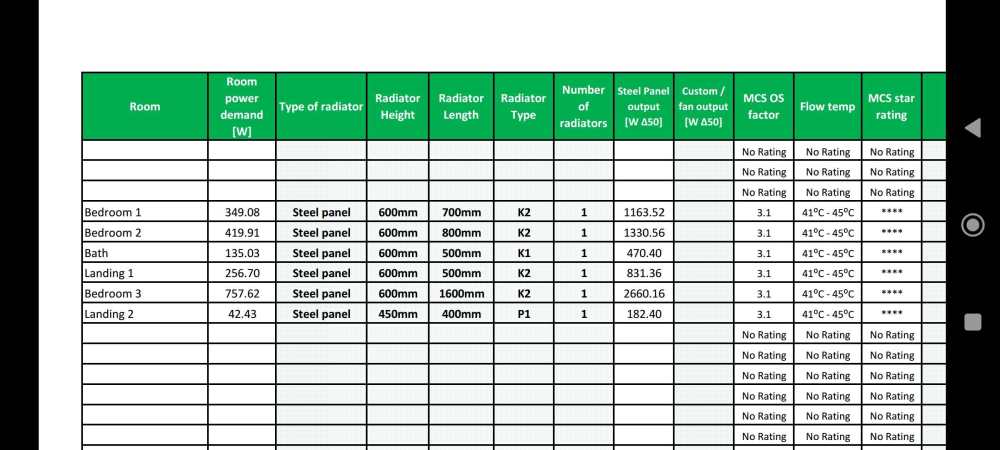

YorkieSelfBuild Posted Saturday at 13:40 Author Posted Saturday at 13:40 4 hours ago, JohnMo said: Your design with UFH and rads is generally fine. You don't have to have the rads on. You could have then on, and run the whole system cooler, plus the additional water volume is good. I would say the rads need to be designed for the same flow temp as UFH, so you have no mixers or additional pumps. Run the whole system as an open loop single zone. Just TRVs on bedroom rads if you need them. The architect is suggesting to IMS to use rads designed for high flow temp but actually run it at same lower temp used by UFH, so there's no mixing. If rads were designed for low flow temp, would they be even bigger?
sharpener Posted Saturday at 14:14 Posted Saturday at 14:14 (edited) 34 minutes ago, YorkieSelfBuild said: The architect is suggesting to IMS to use rads designed for high flow temp but actually run it at same lower temp used by UFH, so there's no mixing. Then the rads will not emit their designed output so it is a nonsense. If it is a fudge and you are not actually going to use them as upthread it does not matter how big they are. OTOH if IMS are insisting on every room having adequate emitter(s) of its own it will not suffice. 34 minutes ago, YorkieSelfBuild said: If rads were designed for low flow temp, would they be even bigger? Yes. even to get the HP flow temp as low as 45C I needed to have mine uprated to 1.9x the area they were with a oil boiler at 65. To get down to UFH temps bigger again. It should all be in the emitter schedule that came with the MCS quotation, mine had different columns for different flow temps so it was easy to see the effect. Edited Saturday at 14:14 by sharpener

Beelbeebub Posted Saturday at 19:53 Posted Saturday at 19:53 Can I check what the issue is with fitting the specified rads? Is it aesthetic? Cost? Space? I've had to replace the failed UFH in some of my upstairs rooms with rads, 600x1400 (or maybe 1600, can't remember) with a flow temp sub 40c (it runs same flow temp as UFH). They work really well, despite feeling only slightly warm and you can feel the heat coming off them and the room warms up nice and quick.
YorkieSelfBuild Posted Monday at 13:20 Author Posted Monday at 13:20 On 08/03/2025 at 19:53, Beelbeebub said: Can I check what the issue is with fitting the specified rads? Is it aesthetic? Cost? Space? I've had to replace the failed UFH in some of my upstairs rooms with rads, 600x1400 (or maybe 1600, can't remember) with a flow temp sub 40c (it runs same flow temp as UFH). They work really well, despite feeling only slightly warm and you can feel the heat coming off them and the room warms up nice and quick. All 3, cleaner without, added cost, stops wall being used. But also are they needed or is proposed design flawed? Plus the flow temp is 40C+, higher than for UFH.
