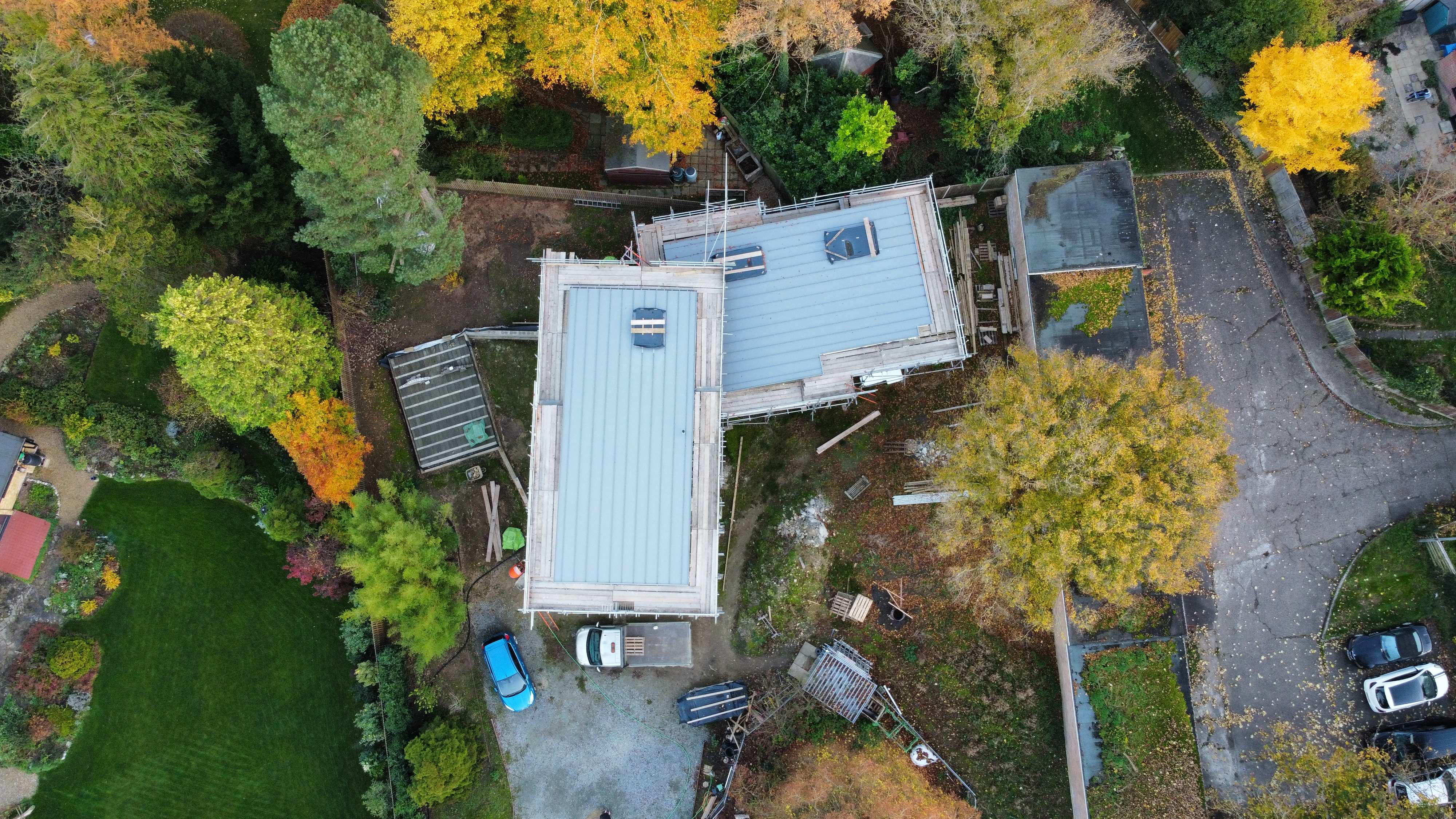

Mulberry View Posted February 24, 2025 Posted February 24, 2025 We're in a bit of a pickle and really hoping for a bit of moral support/guidance from anyone that has any positivity to add. We are now fully into a legal dispute with our Zinc roofing contractor, I mentioned it here, for those that didn't catch my previous post. Sadly there is really no avoiding this, the roof has numerous potential defects, some more serious than others and the eventual result could mean the whole thing has to come off. With the help of a good solicitor, we have put together a fairly compelling case but have to allow it to run its course now. The roof is mostly watertight, although it has 3 large rooflight openings that do not have their windows in them. I have sheeted these up with fairly substantial timber frames covered with thick UV-treated Poly-tunnel plastic. These have so far withstood the last 3 bouts of 50+mph gusts, so seem to be pretty good. This photo was in the Autumn, the rooflight covers are better than you see in this pic by the way! We really need to get on and cannot afford for the project to sit still whilst the legal work takes place. However, we cannot ignore the fact that some amount of roof repair is going to have to take place at some point and maybe even total replacement. We gave the Zinc company full notice that we planned to remove the scaffolding that had been put up for their work and that progress would need to continue, the scaffolding came down just after Christmas. Part of our legal claim will be for the costs to re-erect the scaffolding to complete the remedial works, but if we progress any further, the scaffolding will of course have to be a 'top hat' covered style to prevent the inside getting wet. Our project is already quite a long way behind. We had hoped to get a window order finalised around the middle of last year, it was supposed to be my focus when the Zinc team arrived, but sadly I had to be so hands on, both during and since this work that we still have not pulled the trigger. We really cannot wait much longer and the next steps are to fit the floor insulation, UFH and screed. Do you think we're doing the right thing here? I know it would, in many ways, be better to wait until the roof is sorted, but that could be months and SWMBO has very clearly told me that she cannot do another Winter in this caravan (it'll be our fourth!), so the pressure is on.

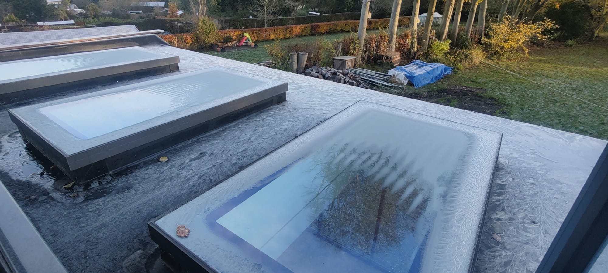

Mr Punter Posted February 24, 2025 Posted February 24, 2025 From what you have posted the issue is just down to the hinges on 2 or 3 rooflights on a flat roof. Why do you think the roof may have to come off? You probably don't need scaffolding. In my experience, the Velux flat roof windows do not offer much ventilation when open so you could consider ditching the opening function if push comes to shove. With the fixing the brackets through several layers of zinc, could you offset the hinges to overcome this? The legal route can be very long and costly and it sounds like it will be difficult to achieve a complete victory, while you risk considerable expense. You would need to expand on the "numerous potential defects". You would need actual defects to convince the court, even if they have not resulted in e.g. water ingress.
Nickfromwales Posted February 24, 2025 Posted February 24, 2025 7 minutes ago, Mr Punter said: In my experience, the Velux flat roof windows do not offer much ventilation when open so you could consider ditching the opening function if push comes to shove. With the fixing the brackets through several layers of zinc, could you offset the hinges to overcome this? In a well insulated and airtight house, I’d defo want the roof lights to open to help purge excess stagnant heat out. The chain gear opens them quite far, and the rain sensors shut them when the great British weather reverts back to normal. Between the roof manufacturer and Velux, this is a shower of shit tbh, they’re not being very helpful? I would have thought if you could pack the hinges which are sat on single ply roofing to bring them out to the same plain as the ones on multiples of sheeting then Velux should be happy! That’s just nonsense from them afaic. If the roof can be cut around the Velux window openings etc the there’s no reason why they shouldn’t allow you to cut / weld / dress around the hinges, but I would defo use testimony from the other installers (if they’ll put pen to paper) and see if there can be a resolve that leaves the rest of the roof on. Run this by your replacement architect maybe and format a multi-pronged attack.
Mulberry View Posted February 24, 2025 Author Posted February 24, 2025 28 minutes ago, Mr Punter said: From what you have posted the issue is just down to the hinges on 2 or 3 rooflights on a flat roof. Why do you think the roof may have to come off? You probably don't need scaffolding. In my experience, the Velux flat roof windows do not offer much ventilation when open so you could consider ditching the opening function if push comes to shove. With the fixing the brackets through several layers of zinc, could you offset the hinges to overcome this? The legal route can be very long and costly and it sounds like it will be difficult to achieve a complete victory, while you risk considerable expense. You would need to expand on the "numerous potential defects". You would need actual defects to convince the court, even if they have not resulted in e.g. water ingress. The issue began as being about the hinges, but more defects have been discovered in the time since. I think the installer has circumvented the compliancy process by not compounding out-of-scope elements. The Zinc manufacturer doesn't care because they only warrant the material, probably not worth anything in the grand scheme. For example, the longer of the 2 roofs is just a smidge under 14 metres. This significantly exceeds VM Zincs maximum tray length. It turns out that they gave special approval for it, but it doesn't look like the installer highlighted to them that, along with the long trays, there are also soldered seams behind the rooflights, which essentially lock the trays together. There is also no expansion tolerance behind the rooflight upstands, so these 3 points combined make for a risky roof. Lots of concern has been shown about the amount of soldering too, which is a big reliability issue. The need for soldering was not presented in advance and, apparently will require frequent inspections. The joined trays make this issue many times worse. How can we effectively monitor soldered joints on a roof that is 7 metres up? There's no way we'd have agreed to this if we had known. There are also possible signs of leakage which need to be investigated. I am tracking at least 2 wet patches which I have evidence of going through a wet/dry/wet/dry cycle.
Mulberry View Posted February 24, 2025 Author Posted February 24, 2025 21 minutes ago, Nickfromwales said: In a well insulated and airtight house, I’d defo want the roof lights to open to help purge excess stagnant heat out. The chain gear opens them quite far, and the rain sensors shut them when the great British weather reverts back to normal. Between the roof manufacturer and Velux, this is a shower of shit tbh, they’re not being very helpful? I would have thought if you could pack the hinges which are sat on single ply roofing to bring them out to the same plain as the ones on multiples of sheeting then Velux should be happy! That’s just nonsense from them afaic. If the roof can be cut around the Velux window openings etc the there’s no reason why they shouldn’t allow you to cut / weld / dress around the hinges, but I would defo use testimony from the other installers (if they’ll put pen to paper) and see if there can be a resolve that leaves the rest of the roof on. Run this by your replacement architect maybe and format a multi-pronged attack. You're exactly right, it's a shower of shit. I know that we should have had Architectural support, but the installer absolutely should have kicked the problems back to me when they were realised. Instead they 'winged it'. Velux have offered some help, but they do not take responsibility. The hinges, if you ask me, are skimpy anyway (and with 3no M5 fixings each) and with windows that weigh 275kg each, they must have a good fixing. Especially because the window has to be pivoted up to vertical in order to fix the final bolt in each hinge, so there'll be 275kg bearing down vertically at that point. It turns out that the Vario by Velux windows run close to the upstands and moving the hinge at all from it's designed position could cause the inner edge of the window to foul the upstand as it opens. Both of the onward installers that viewed the roof say that it's not a straight-forward issue, but both have tabled something that might be able to be developed, well for the rooflight issue at least. But both of course state that I'll screw any warranty I might have on the roof as soon as they start to mess with it.

JohnMo Posted February 24, 2025 Posted February 24, 2025 2 minutes ago, Tetrarch said: We went for (quite expensive) sealed unit rooflights that "drop over" our timber upstands. They make a great seal and then the only join that matters is where the upstands poke through the roof material We did similar, although on compacfoam upstairs. We did an EPDM standing seam, the upstand is completely covered and seal welded. Again we open doors and windows, but also run UFH in cool mode. 1

Mulberry View Posted February 24, 2025 Author Posted February 24, 2025 1 hour ago, Tetrarch said: I've got 6 sq m of rooflights and MVHR. I haven't yet gone through a summer, so time will tell, but I've noticed that the MVHR is very good about maintaining fresh air throughout the whole house. We went for (quite expensive) sealed unit rooflights that "drop over" our timber upstands. They make a great seal and then the only join that matters is where the upstands poke through the roof material. In our case it's a rubber roof so I was massively obsessed with the way that these were constructed. I'll open our patio doors if things get too hot! Regards Tet I do honestly think we'd reconsider the rooflights, but obviously the water is under the bridge. Ours are the sort that drop over the timber upstands too. I meticulously constructed the roof and installed the upstands to the absolute letter of their guidelines and well within the tolerances. It's a shame that all turned to you-know-what when the Zinc roofer arrived. We liked the idea of some sort of stack ventilation, we have an openable rooflight at the high end of the living room and in the double height entrance hall.
