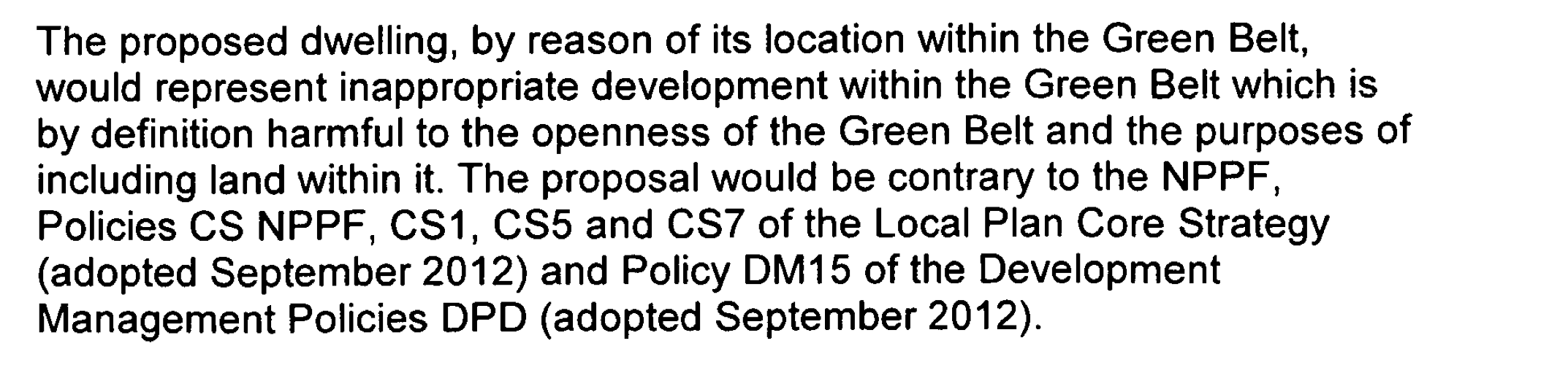

That's a really good point. I'm unsure when the original houses were given planning in the 1930s.  It's so perculiar that one wasn't built. and why they'd build either side and not this.
Posted
Just now, Sully said:
that's was the on the decision notice for the last application in 2014 @IanR . thanks for the links will have a read
It doesn’t sound like their reason for refusal was because there ‘wasn’t ever a building on the plot’ - which isn’t really a condition of infill anyway. If you can prove the settlement boundary extends to encompass your plot and there’s a clear gap then infill should be a reasonable scenario for planning. Did the council not address this in their response? Have you got the delegated report or link to application for us to look at?

Posted
Their reason for refusal indicates there is no mitigation to it being within Green Belt, and the plot therefore resides outside of the defined settlement boundaries. Check that's the case in the Local Plan and that the Core Strategies, CS1, CS5 and CS7 all indicate that development should not be allowed in this position.
If the LPA are accurate with their reason for refusal, and there's been no boundary or policy change since, then don't waste anymore time on this plot.

And an appeal inspector can decide that a plot is within the village in terms of the NPPF even though it might not be within the settlement boundary. Their job is to interpret the plans according to what they find on the ground.  And given the push to build, build, build, they may be even more inclined to grant permission these days.
And the decision was based on the Plan from 2012 - a lot will have changed in that time
