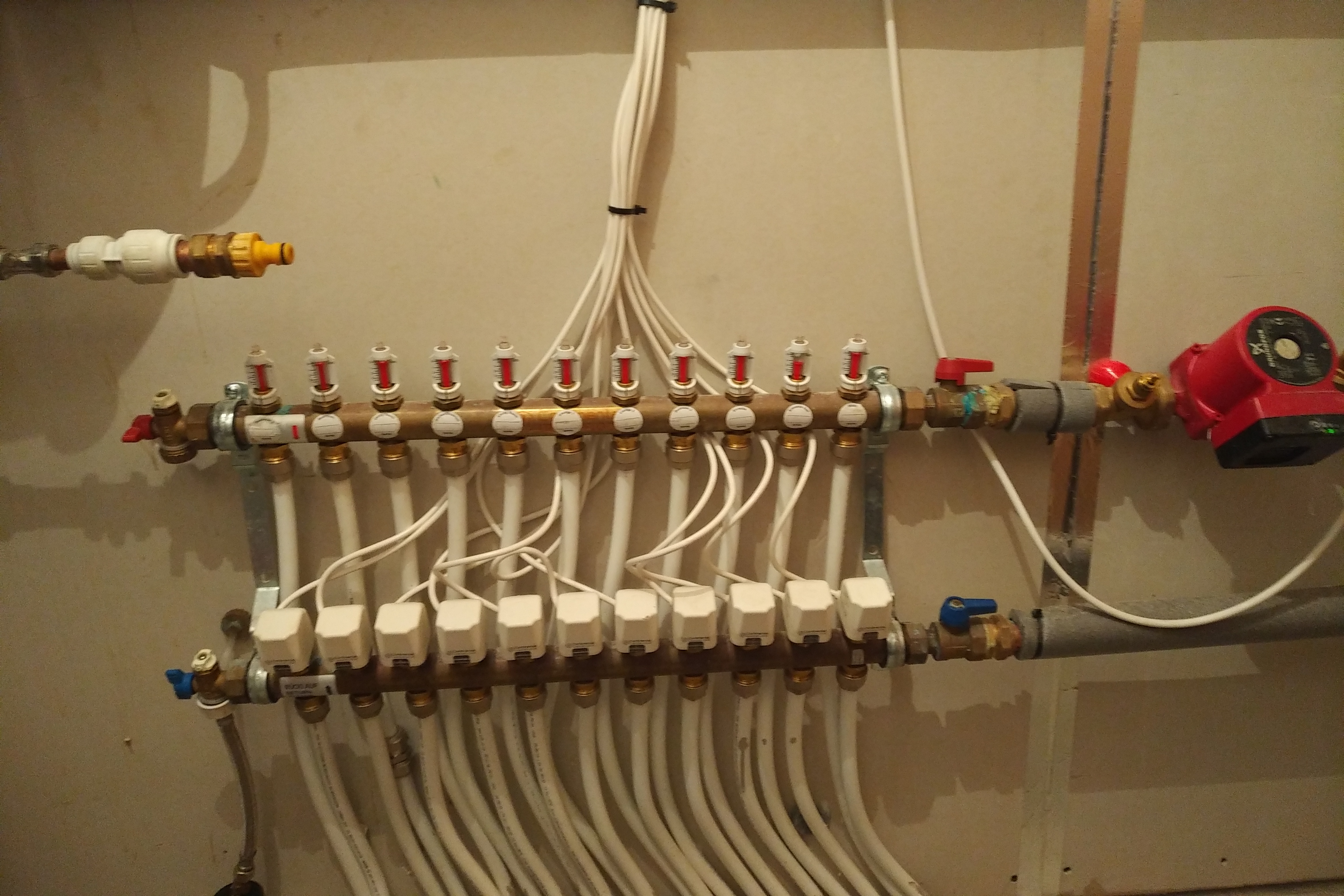

Jeremy Harris Posted December 6, 2017 Posted December 6, 2017 It's something you can probably do yourself. On the UFH manifold there will be a thermostatic mixer valve, either a two or three port one, that sets the UFH flow temperature. We have a simple two port one, you can see it here, the white control at the left of the lower manifold, in the centre of this photo, where the flow comes in from the ASHP: Then, when this is set to give the desired UFH temperature, the ASHP flow temperature can be adjusted upwards. I'd suggest setting it to around 40 deg C, as I found that seem to work very well for ours.
NSS Posted December 6, 2017 Author Posted December 6, 2017 Nope, we have nothing like that on the manifold.
Jeremy Harris Posted December 6, 2017 Posted December 6, 2017 (edited) They do come in different shapes and sizes, but all do the same thing, they ensure that the UFH runs at the set temperature, irrespective of the heat source temperature. Yours may be a smaller three port blender valve, with a smaller control. I've not seen a UFH manifold without a form of temperature control valve, either a two port one like ours, or a three port one. The three port ones look very much like the ones used on thermal stores or other hot water storage systems to control the DHW temperature. The UFH flow temperature needs to be adjusted to give just enough heat to the floor to warm the house quickly enough, without too much overshoot, just for comfort. Having a high UFH flow temperature tends to result in greater swings between the maximum and minimum room temperature, as it takes time for the heat to get from the UFH pipes to the floor surface, so if the UFH pipes are running too hot, the heat will continue to soak out to the floor for a long time after the thermostat has turned the heating off, resulting in the rooms continuing to warm up for some time. We suffer from this if the flow temperature exceeds about 26 deg C; as long as I keep the thermostatic valve set down below that level things are fine. The ASHP flow temperature, just like any other heat source, needs to be set to give best performance at the load it is operating at. Running an ASHP at too cool a flow temp will tend to cause the unit to modulate down to a low level, all the time, and never operate at it's most efficient temperature. One key point is to get the difference between the flow and return temperature of the ASHP up to a reasonable level, as this sets the modulation level and also has a significant impact on the anti-short cycle timing. If the ASHP is running with the anti-short cycle system kicking in a lot, then it's efficiency will drop because of all the additional starts and stops, especially in milder weather, when the heating isn't being required to deliver much heat. Edited December 6, 2017 by JSHarris 1

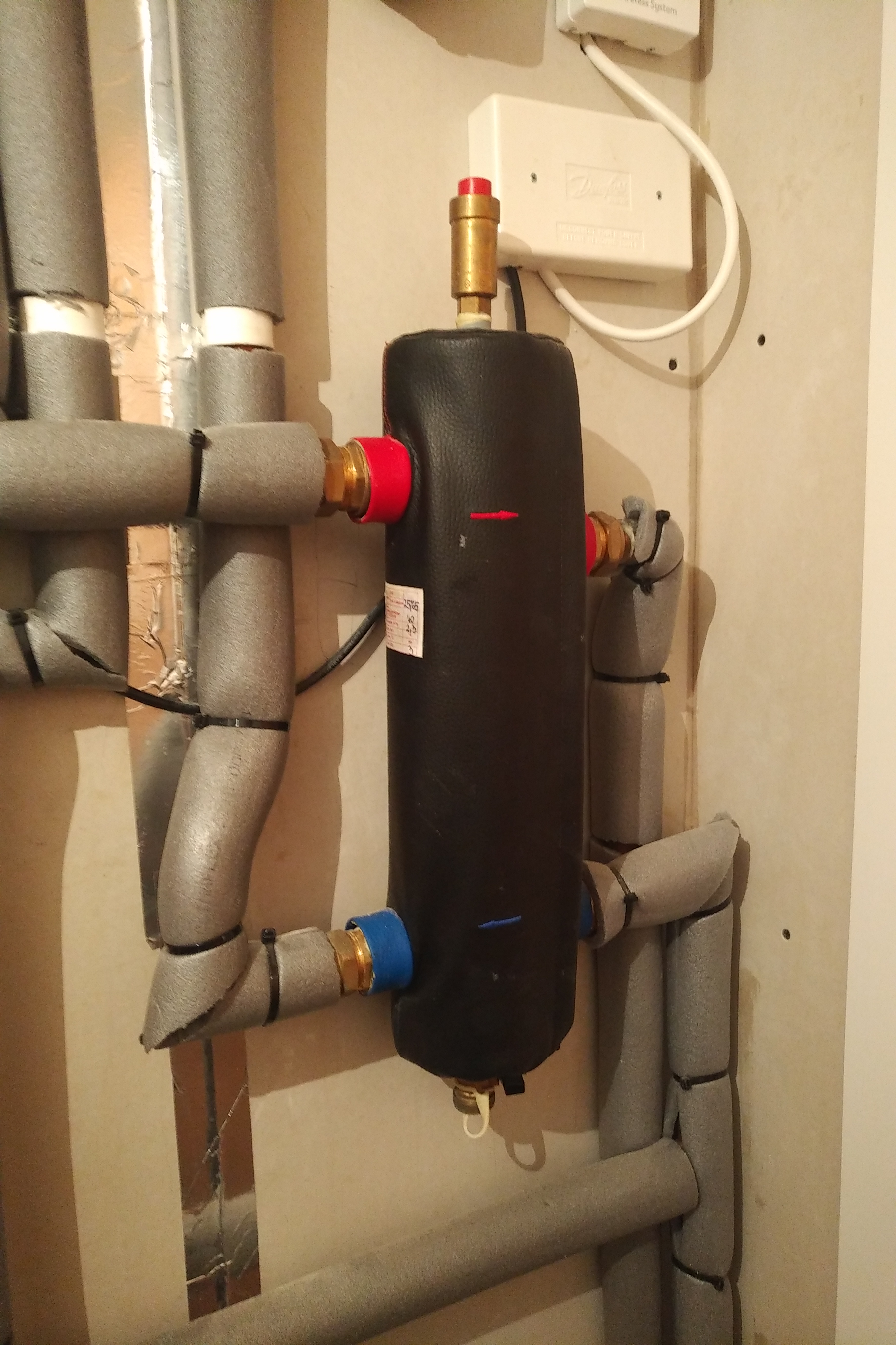

NSS Posted December 6, 2017 Author Posted December 6, 2017 The only thing that sits across the flow and return sides to/from the manifold is this thing.
Jeremy Harris Posted December 6, 2017 Posted December 6, 2017 (edited) It's not that, the thermostatic mixer valve is almost always directly mounted on the manifold and UFH pump itself, or very close to it, either as shown in my photo or as in these photos of other UFH mixing valves, taken at random from the web: The mixing valves are all at the bottom or lower left of each photo, with a temperature control knob. There is almost always a thermometer in both the flow and return manifolds to, to allow the UFH to be set up properly to give the desired differential temperature between the UFH flow and UFH return (not the same as the ASHP floa and return, they are separate; not all the flow from the ASHP goes through the UFH all the time, when the thermostatic valve senses that the UFH flow is at the set temperature it throttles back the flow and so some of the ASHP flow goes through the bypass, buffer tank, other heating appliances in the circuit etc, at the ASP set flow temperature. Edited December 6, 2017 by JSHarris

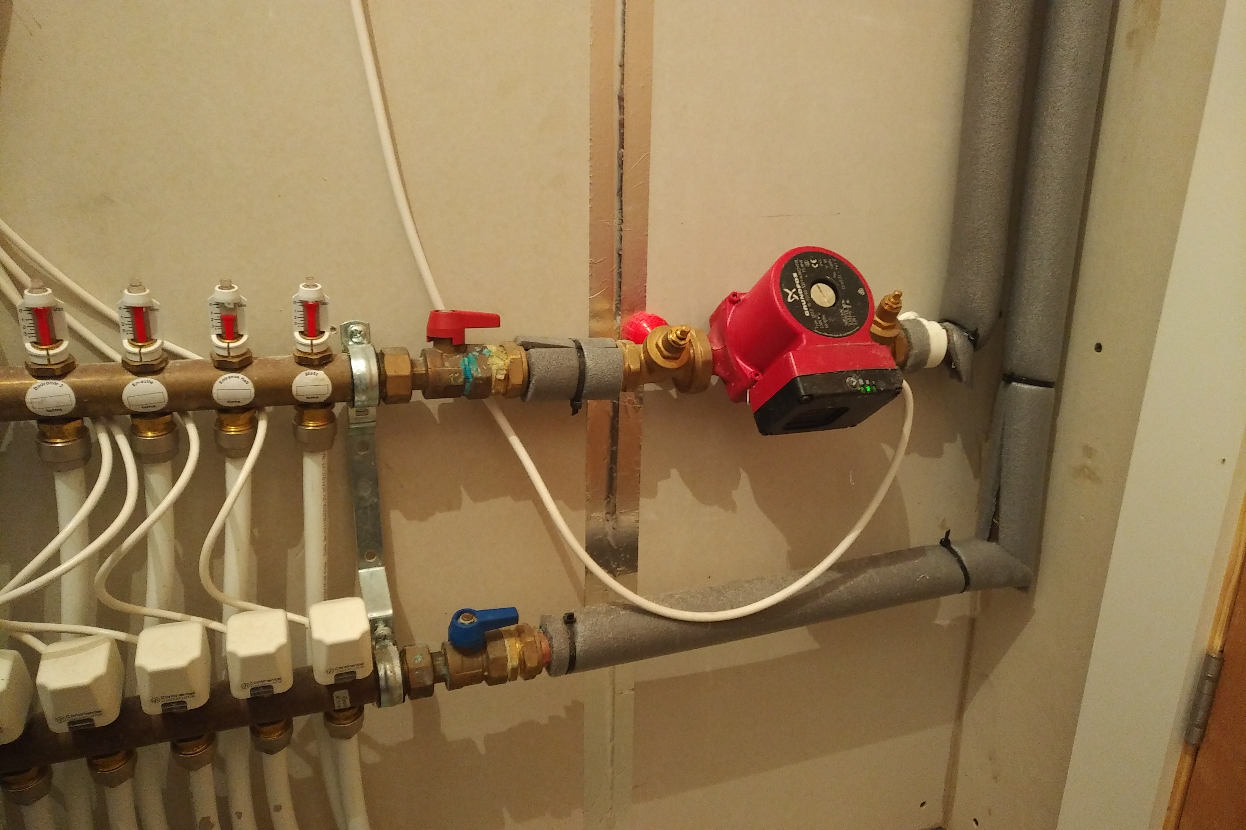

PeterW Posted December 6, 2017 Posted December 6, 2017 52 minutes ago, NSS said: The only thing that sits across the flow and return sides to/from the manifold is this thing. Thats a low loss header .... Got a photo of the manifold itself and the pump that drives the flow around the circuits ..??
PeterW Posted December 6, 2017 Posted December 6, 2017 So basically all your floor loops are directly linked to the ASHP and the pumps only run when the ASHP is on. Hence why you can’t change the flow as it’s the ASHP that is dictating the flow temperatures.
Jeremy Harris Posted December 6, 2017 Posted December 6, 2017 @Nickfromwales may add to this, but I've never, ever, seen a UFH manifold configured like that. I did loads of research before installing ours, and every single manifold system I looked at had the pump and mixer valve across the manifold. None had another pump is series with the ASHP pump (assuming your ASHP has an integral pump; most seem to).
Nickfromwales Posted December 6, 2017 Posted December 6, 2017 32 minutes ago, PeterW said: So basically all your floor loops are directly linked to the ASHP and the pumps only run when the ASHP is on. Not quite. The UFH can circulate from the low loss header ( spot on with that btw ) as it hydraulically separates the UFH from the ASHP. That allows each circuit to remain at 0 poreabtail and each can pass through the LLH without either pulling or pushing in any direction. Both 'can' therefore circulate independently, but there should REALLY be a 2-port zone valve in that arrangement which opens when the ASHP is called on for heat. That imo would offer a better heating characteristic / hysteresis as it would circulate the heated water rather than heat linear to the ASHP set temp ( and its hysteresis). I agree that the likelihood is that it's all running in unison, and it's very strange to see it configured this way, as @JSHarris has highlighted. @NSS, does the ASHP also provide DHW ?

Jeremy Harris Posted December 6, 2017 Posted December 6, 2017 (edited) TBH, I doubt that the low loss header is doing much, if anything. They all have a lowest operating power rating, which is set at boiler type temperatures (it's why they were designed - to deal with the minimum flow requirements of boilers). When run below about 40 deg C I doubt that the minimum power rating for that low loss header would be achieved (it looks as if it is a 30 to 40 kW minimum power rating one to me, probably rated at about 60 to 65 deg C). I reckon this system was installed by someone who usually installs radiator systems, where the flow temperature is controlled by the boiler heating thermostat, as that's exactly how it seems to have been set up. The good news is that reconfiguring it to with the pump circulating around the UFH, with a valve (as @Nickfromwales suggests to be able to turn off the return from the UFH) and a mixer valve added to set the UFH flow temperature looks to be reasonably straightforward. The pump can probably be re-used, a mixing valve would need to be added, plus ideally thermometers on both manifolds, and some reconfiguration of the pipes and wiring would be needed, but you would then get a system that would undoubtedly be more flexible, more efficient and allow the air rads to work normally, with a higher output if that is needed. Edited December 6, 2017 by JSHarris
