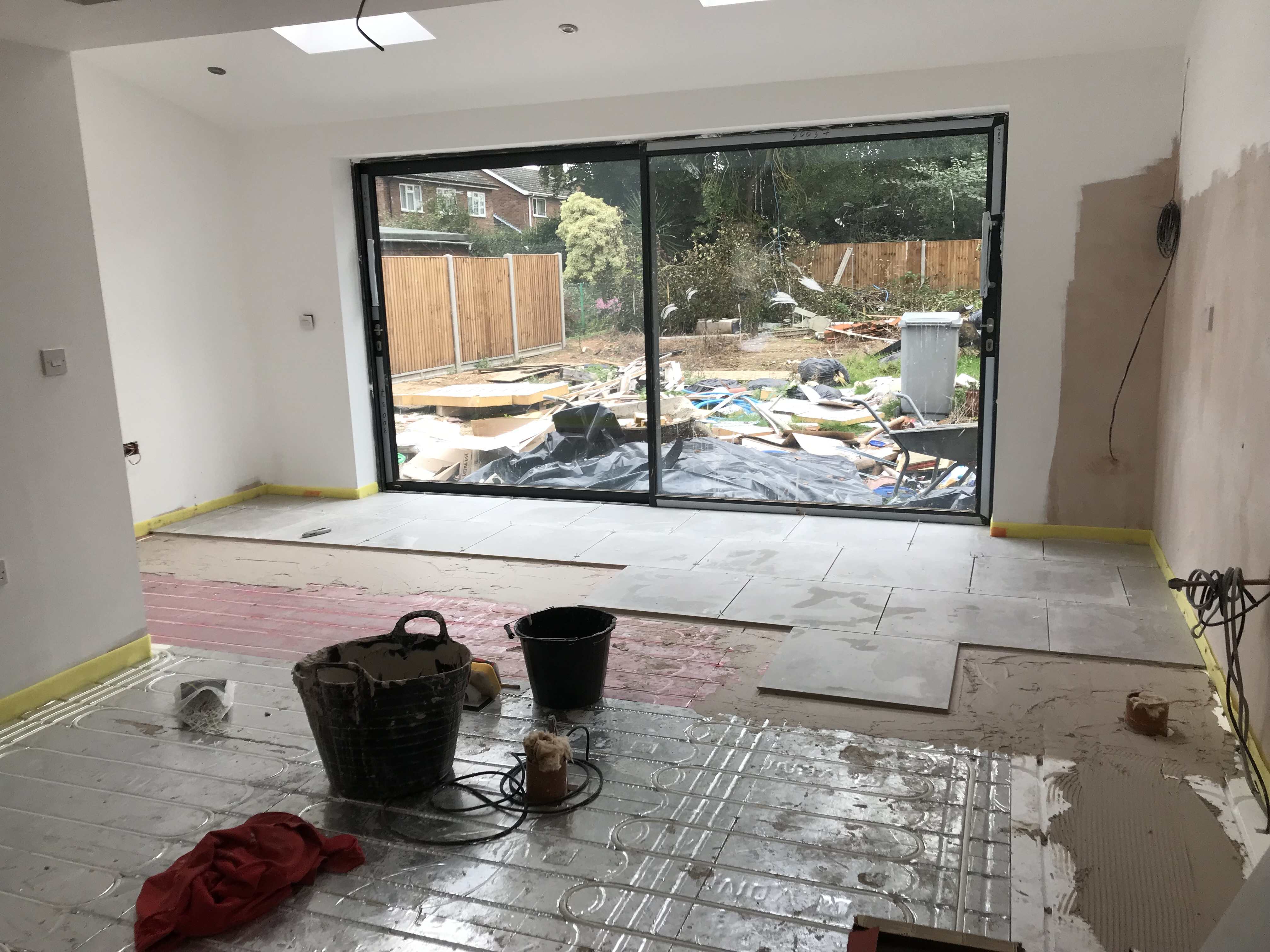

Posted
Are you going to tile over? If so, can you tile directly onto the over floor boards? I did that with the wundaboards, after applying the appropriate primer.
