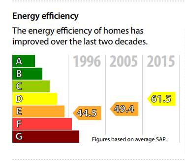

Ferdinand Posted December 3, 2017 Share Posted December 3, 2017 A quick EPC question to which I cannot find an answer. What would be an EPC value for a typical "building regs minimum" newbuild property? I did however find numbers for how EPC values have changed over the last 20 years. Right direction, more still to do. Source: https://www.gov.uk/government/uploads/system/uploads/attachment_data/file/627688/Potential_stock_improvements_Report_2015-16.pdf Link to comment Share on other sites More sharing options...
ADLIan Posted December 3, 2017 Share Posted December 3, 2017 Depends on fuel used, if mains gas expect approx SAP of 85, Band B. Figures above refer to existing housing stock. Link to comment Share on other sites More sharing options...
