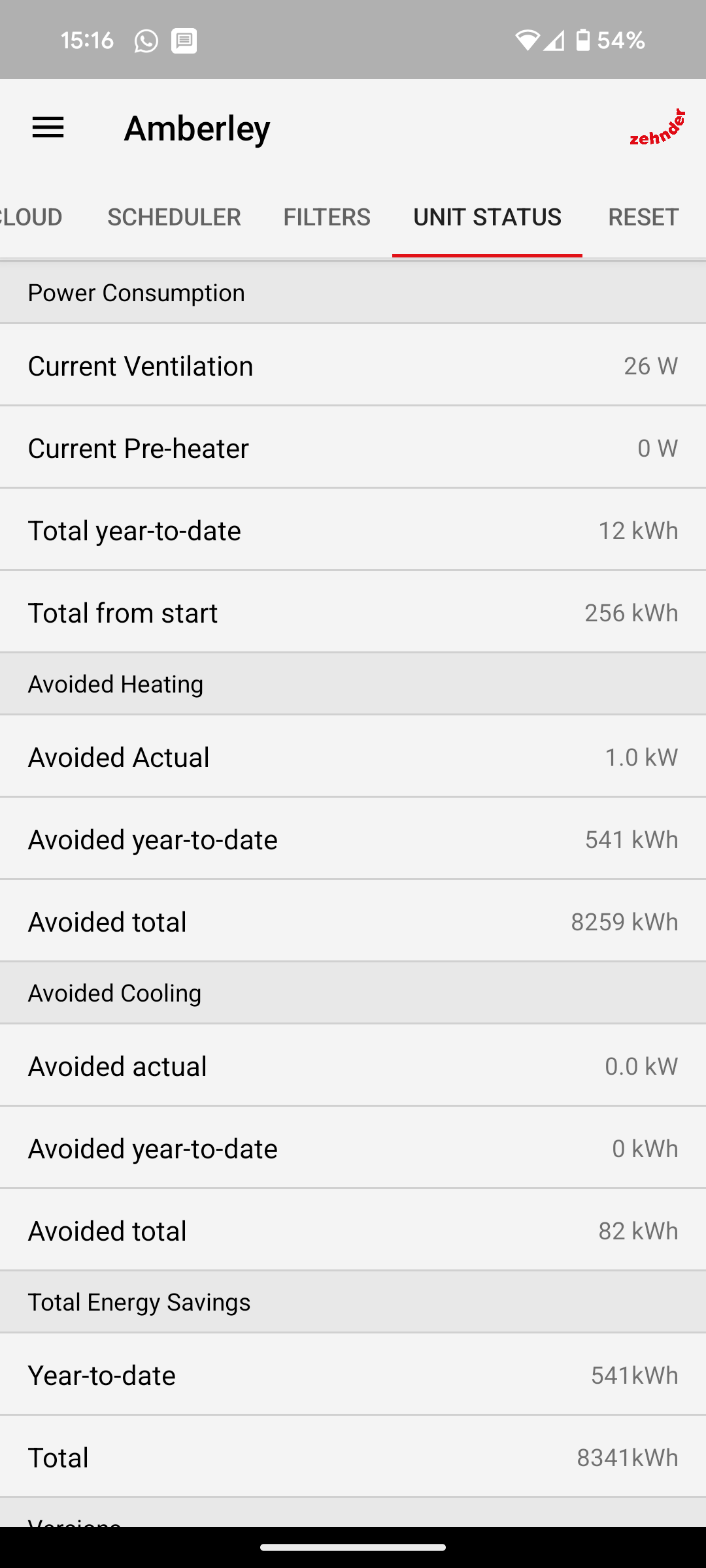

joth Posted Friday at 15:30 Share Posted Friday at 15:30 I also installed mvhr for comfort rather than financial payback. But it claims to have saved over 2000kWh per year since installed so will pay for itself in ten years. The fact it uses power is negligible. It's about 3% of the saved energy. But again, it's for the comfort. Every previous house my wife would constantly be opening windows (to remove humidity to avoid mold) and I'd be constantly closing them because it was so damn cold. So I guess the biggest financial saving was mvhr has saved us a costly divorce 😂 2 3 Link to comment Share on other sites More sharing options...
JohnMo Posted Friday at 16:50 Share Posted Friday at 16:50 The formula for calculating ventilation heat loss is: Rate of heat loss = V x ACH x DeltaT x 0.33 So if we take the efficiency of MVHR as 85%, some better some worse. The formula becomes to calculate savings V x ACH x DeltaT x 0.33 x 0.85. So if you flow rate through MVHR as 0.3 ACH. A 200m² house with 2.4m high ceilings, inside temp 20 outside temp -3 (200 x 2.4) x 0.3 x 23 x 0.33 x 0.85. So you are saving just over 900W against a ventilation heat loss of 1100W, without heat recovery. That is worse case. So a more average winter temperature of 6 degs The saving becomes an hourly savings of 600W throughout the heating season. 600W x 24 hrs x 180 days. So about 2500kWh. So @joth numbers are in the correct ballpark. So a CoP of 4 or gas, so around 5p per kWh. 2500 x 0.05, is about £125 a year. My first quote for MVHR was £10k so that for us would have been about 80 years payback. As it is I am still looking at 16 years as DIY installation. 1 hour ago, joth said: so will pay for itself in ten years. So you only paid £1000 for the full system? Link to comment Share on other sites More sharing options...

joth Posted Friday at 18:49 Share Posted Friday at 18:49 (edited) 2 hours ago, JohnMo said: So you only paid £1000 for the full system? No. However I would have paid more than 5p per additional marginal kWh of delivered heat over last 4 years, and predict I would pay more again on average over next 6 years. It's a weak comparison without factoring in inflation, prediction of future energy prices, and opportunity cost of tying up the capital, which ICBA to do given I didn't install for financial payback. It's O(10) years. Good enough Edited Friday at 18:51 by joth Link to comment Share on other sites More sharing options...
joth Posted yesterday at 04:11 Share Posted yesterday at 04:11 (edited) 9 hours ago, joth said: 11 hours ago, JohnMo said: So you only paid £1000 for the full system? No. However I would have paid more than 5p per additional marginal kWh of delivered heat over last 4 years, and predict I would pay more again on average over next 6 years Actually I just realised, the 2000 kWh / year saving is compared to having perfectly managed (mechanical) ventilation without a heat exchanger. So the relevant cost saving here is the heat exchanger itself which is £800 Inc VAT (Zehnder Enthalpic) so pays for itself in under 8 years even at 5p/kWh for extra heating. (Shorter if paying more for heat) In reality if I hadn't installed MVHR then we'd: (a) have trickle vents, (b) renovated to a much lower airtightness goal, and (c) have the windows open much more of the time, even in winter. Together these three would yield far greater (and largely unmanaged) heat losses than that what the Heat exchanger is recovering. The principle savings come from the upgrade to managed rather than unmanaged ventilation, and the heat recovery is just the icing on the cake. And I should add I've also automated the window opening and closing now too, modulating the window gap according to needs in summer, so even that is managed. That's the cherry on the icing on the ventilation cake. Edited yesterday at 04:15 by joth Link to comment Share on other sites More sharing options...
