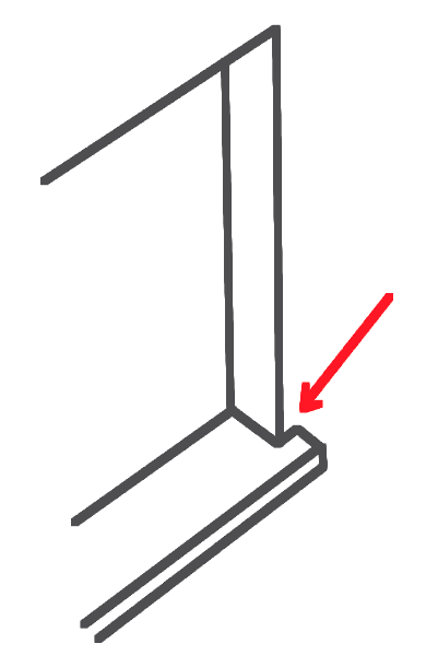

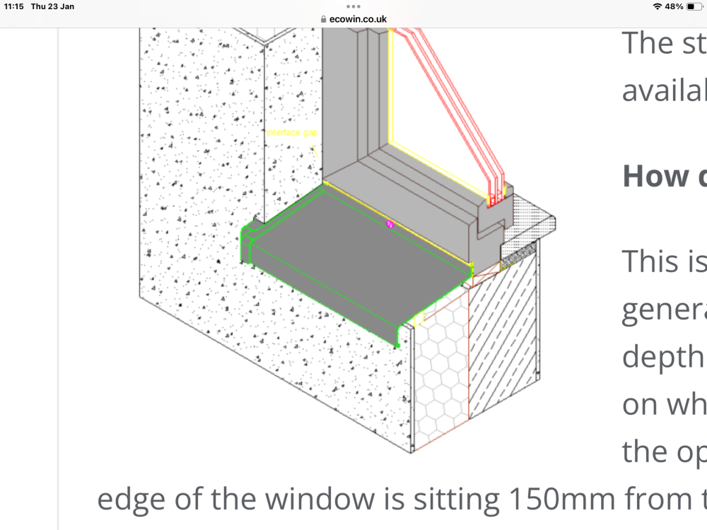

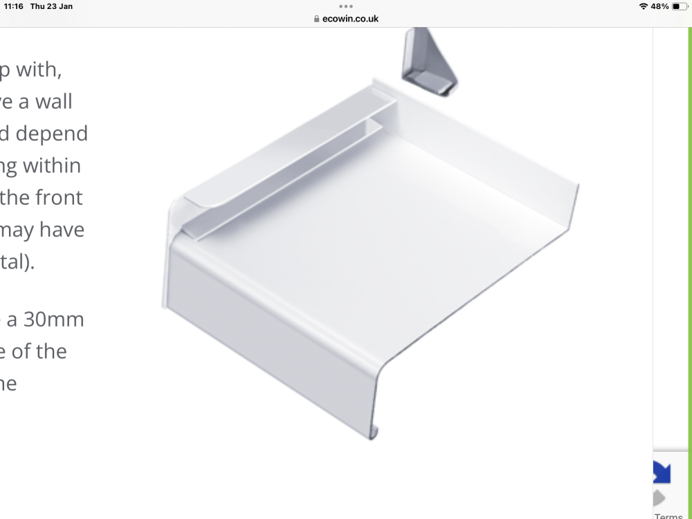

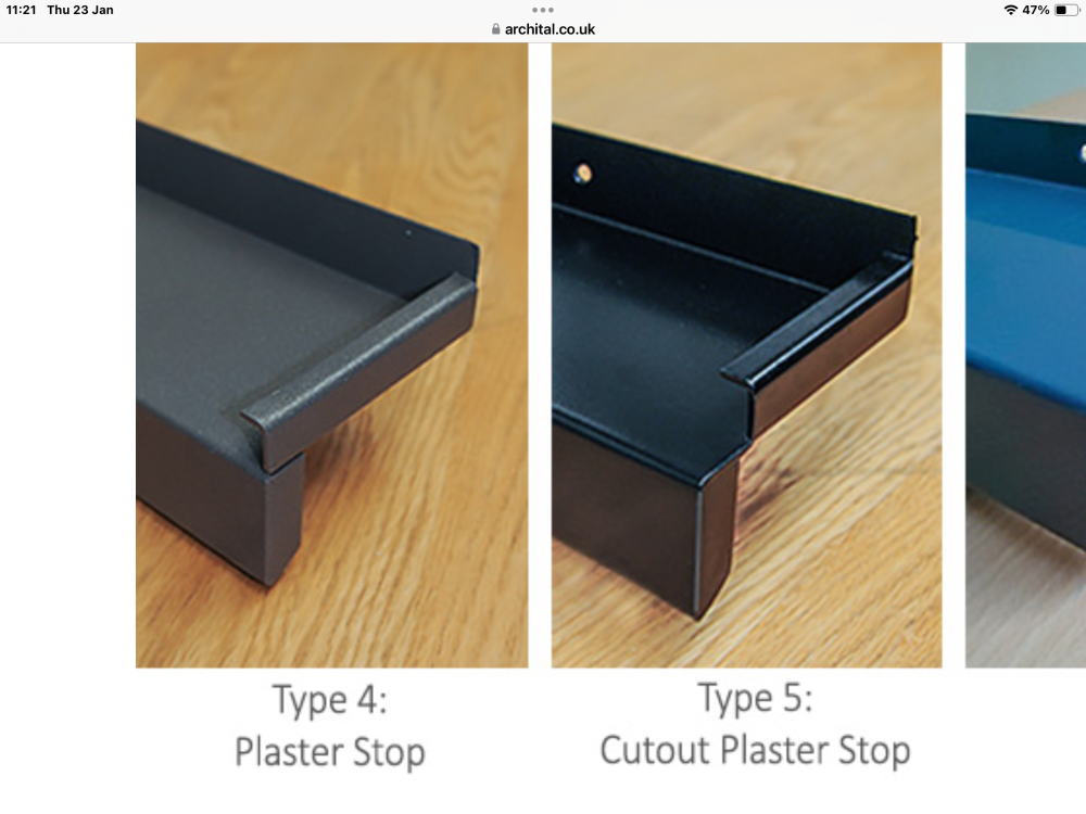

Mike Posted January 22, 2025 Posted January 22, 2025 23 hours ago, LaChab said: I'm having the outside of the reveals rendered with 15mm stop beads before the windows are fitted Slight deviation from the topic, but what are you doing for the window sills? They're not part of the window - or they are and you're pre-shaping the render to fit?
