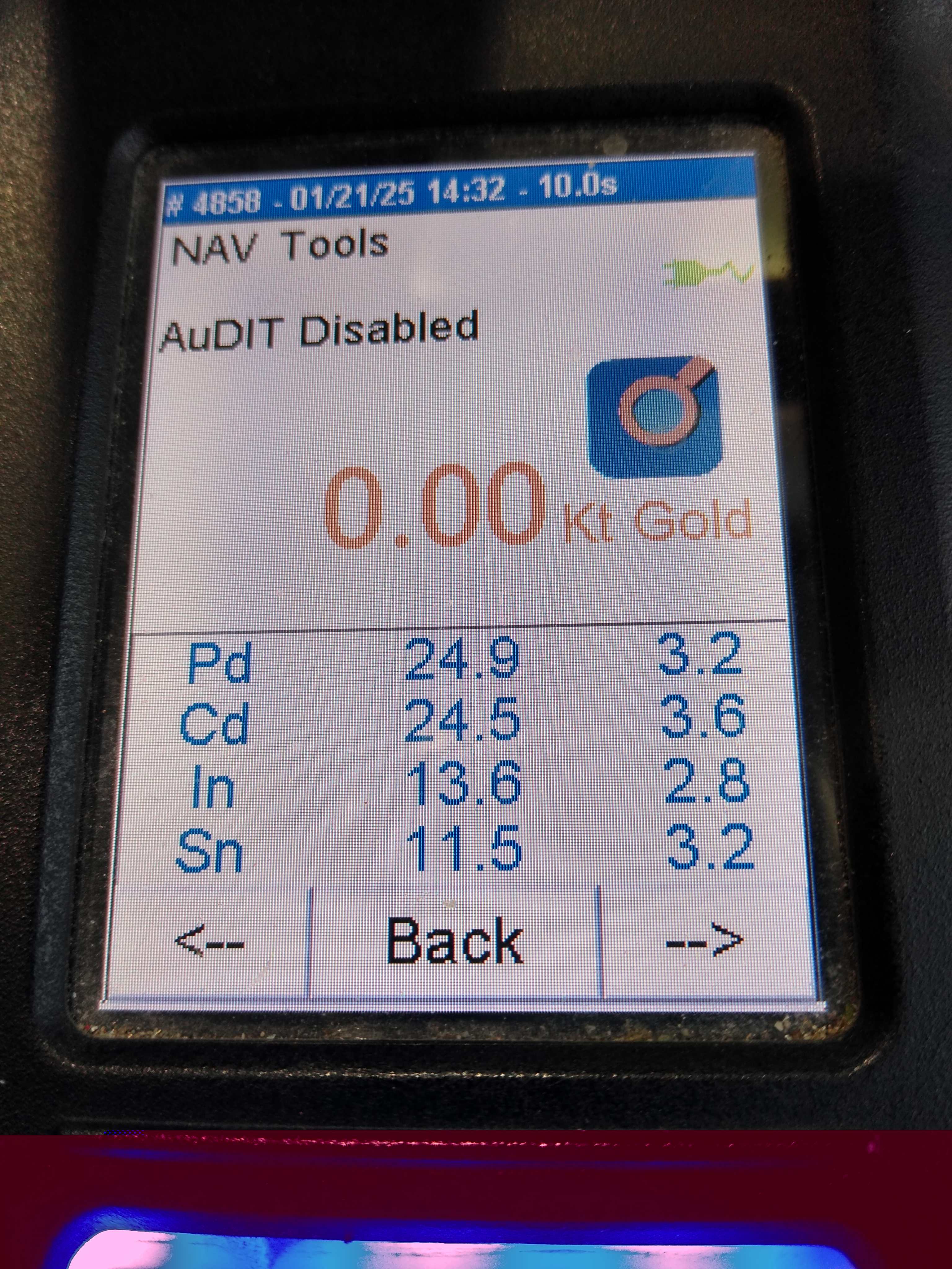

SteamyTea Posted January 20 Posted January 20 On 20/01/2025 at 17:25, Jeremy Harris said: Quite why anyone would ever feel the need to have a WiFi connected and controlled hot water heater is beyond me Expand It gives the impression that the customer has some control and can reduce their energy bills. I blame the marketing departments. (Metal Mickey was not at work today, so could not put the PCM under the lazer, hopefully he is in tomorrow) 1
SteamyTea Posted January 21 Posted January 21 Saw the metal man earlier. The first column is the element, second the percentage and third is the uncertainty. 1 1
SteamyTea Posted January 22 Posted January 22 So do we know how the elements 30 (Zinc), 46 (Palladium), 48 (Cadmium) and 49 (Indium) all work together to control the phase changing?

SteamyTea Posted January 23 Posted January 23 On 22/01/2025 at 20:52, Onoff said: I'm only guessing mind Expand Stable crystals then.
