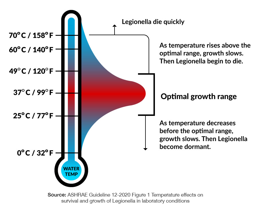

JohnMo Posted Thursday at 10:09 Share Posted Thursday at 10:09 9 minutes ago, JamesPa said: Also my heat pump does the legionella cycle at 70 In 99% of households this just isn't required, just heat the water to 50, it's no longer an issue anyway. Most houses run on chlorinated water (like or not), if you have an unvented system also, how does legionella get in? 15 minutes ago, JamesPa said: honestly whats wrong with 55 Is that a real comment, add in loads of defrosts at anything approaching zero, sounds like a good system performance will prevail - NOT. Link to comment Share on other sites More sharing options...
Sparrowhawk Posted Thursday at 10:34 Share Posted Thursday at 10:34 21 minutes ago, JohnMo said: In 99% of households this just isn't required, just heat the water to 50, it's no longer an issue anyway. Most houses run on chlorinated water (like or not), if you have an unvented system also, how does legionella get in? Exactly. Obligatory Heat Geek article: https://www.heatgeek.com/hot-water-temperature-scalding-and-legionella/ I chatted unofficially to our heating engineer, looked at our hot water usage (daily turnover %), and keep our UVC with a target temperature of 47C (range 45-49). Link to comment Share on other sites More sharing options...

JamesPa Posted Thursday at 10:56 Share Posted Thursday at 10:56 37 minutes ago, JohnMo said: 59 minutes ago, JamesPa said: Also my heat pump does the legionella cycle at 70 In 99% of households this just isn't required, just heat the water to 50, it's no longer an issue anyway. Most houses run on chlorinated water (like or not), if you have an unvented system also, how does legionella get in? I agree you are probably right, but that's not the point. The point is that, until there is a public health statement from the NHS to the contrary, legionella protection will inevitably be fitted/required by some, if only for liability reasons and so until we fix that it must be provided for. If there were an authoritative public health statement that could change, but it can't change based on your opinion or mine, it needs someone with the relevant qualifications in the relevant position. 41 minutes ago, JohnMo said: 1 hour ago, JamesPa said: honestly whats wrong with 55 Is that a real comment, add in loads of defrosts at anything approaching zero, sounds like a good system performance will prevail - NOT. I said it's not ideal, but the world isn't ideal and to outlaw it is going too far. There are people who quite happily run at this temperature accepting the cost trade off and it's still better for the environment than burning fossil fuel. Not everyone lives in a well insulated new build with lots of space and money for large radiators, and if we want to get to 1.4m per year we need some flexibility for people to make informed trade offs. Link to comment Share on other sites More sharing options...
