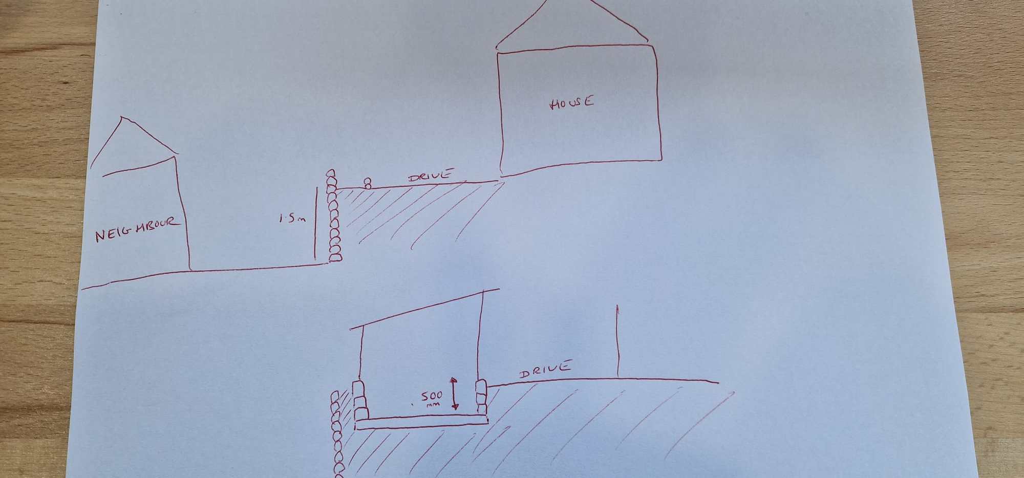

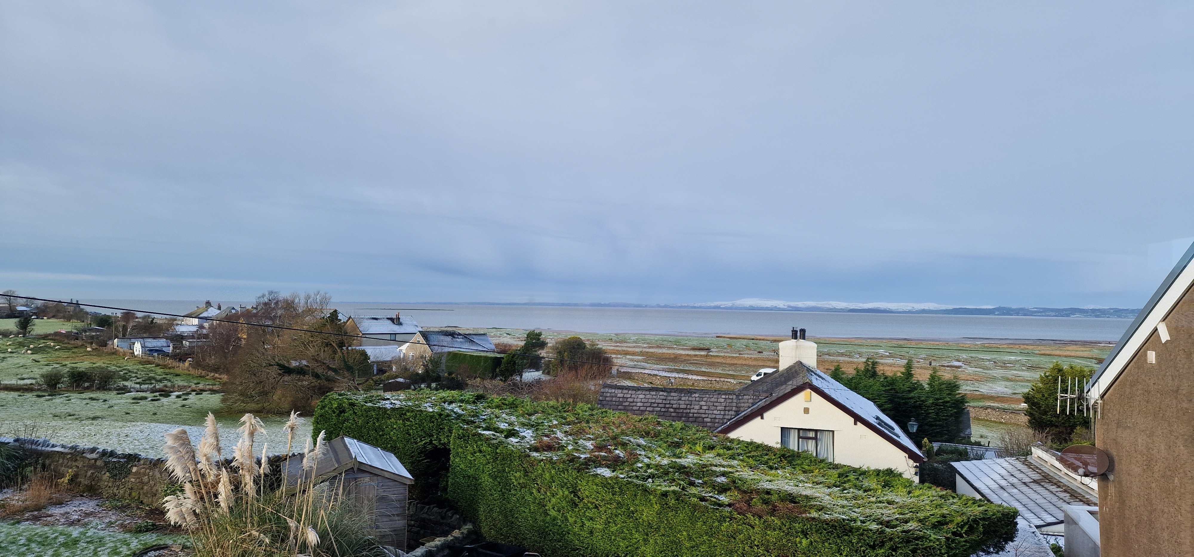

iSelfBuild Posted January 10 Share Posted January 10 I'm just embarking on a large extension and as part of that I'm building a 30m2 home gym / garage. Please see my marvellous sketch... At the moment there is a large deep boundary hedge which is about 2.7m high - blocking stunning views over the seafront. I am wanting to be able to overhead press in the gym and need 2.8m ideally. So I wondered if I can sink down the base and build up with blocks (laid on their side up to above the driveway height. Fortunately next door it drops away about 1.5m so I'm thinking if I make a French drain all the way around and fill in the sides with EPS then crushed rock it should be ok... Silly idea or should it be ok? Floor level would be 500mm lower than the drive. Link to comment Share on other sites More sharing options...

saveasteading Posted January 10 Share Posted January 10 The sketch is perfect. Thd issue is the load of the new building thrusting against the existing retaining wall. Imagine loads spreading at 45 degrees. What is the wall construction? Keeping the gym dry inside will need careful detailing and some cost. Will there be a door at ground level and steps down inside? 1 Link to comment Share on other sites More sharing options...
iSelfBuild Posted January 10 Author Share Posted January 10 27 minutes ago, saveasteading said: The sketch is perfect. Thd issue is the load of the new building thrusting against the existing retaining wall. Imagine loads spreading at 45 degrees. What is the wall construction? Keeping the gym dry inside will need careful detailing and some cost. Will there be a door at ground level and steps down inside? Hadn't really considered that! It's just a stone wall - in good condition no cracks etc - but there is a big root structure of the Leylandii hedge which I imagine "reinforces" it all. I imagine the soil I take out will be more ground pressure than the new structure (as it will be timber frame) however definitely worth considering and looking into! Yes a door on the drive way and steps down. Link to comment Share on other sites More sharing options...
saveasteading Posted January 10 Share Posted January 10 4 hours ago, iSelfBuild said: imagine the soil I take out will be more ground pressure than the new structure (as Unfortunately not. I think you will have to take the foundation down to next door's ground level. Link to comment Share on other sites More sharing options...
iSelfBuild Posted January 11 Author Share Posted January 11 14 hours ago, saveasteading said: Unfortunately not. I think you will have to take the foundation down to next door's ground level. I would be using a raft foundation so the 45* impact would be less than strip footings I imagine? Taking a closer look it looks like once I remove the banked up soil (there is also a dwarf wall my side) the drop to next door will be more like 1m. If I keep it 1m away from the boundary retaining wall by the time the 500mm wall height and 200mm raft epth it's going to be almost level with their side. Just my house to worry about falling into my man cave 😆 Link to comment Share on other sites More sharing options...
Marvin Posted January 11 Share Posted January 11 Hi @iSelfBuild Items you may wish to consider.. Soil mechanics! Load baring capacity of the Soil Slip plane Heave Full design details of existing retaining wall (survey may be required) Existing services. Old and new drainage. Localised flooding Leylandii hedge is known for its shallow but wide root system, depending on the soil and the variety of leylandii. Permitted development rules. https://www.gov.uk/government/publications/permitted-development-rights-for-householders-technical-guidance Who owns the retaining wall Conversation with the neighbours Undermining the stability of the existing retaining wall whilst your gym vibrates as you pump iron🤣 43 minutes ago, iSelfBuild said: I would be using a raft foundation so the 45* impact would be less than strip footings I imagine? Taking a closer look it looks like once I remove the banked up soil (there is also a dwarf wall my side) the drop to next door will be more like 1m. If I keep it 1m away from the boundary retaining wall by the time the 500mm wall height and 200mm raft depth it's going to be almost level with their side. Yes this is the problem. Without a drawing with accurate dimensions (not a scaled drawing)written on it, with both horizontal and vertical distances, ideas given could be excellent or Ballox and pictures of the walls really help. (is the retaining wall vertical or leaning towards your drive at the top?) In my opinion a raft foundation is more likely to cause heave or lateral pressure on the retaining wall. Good luck Marvin 2 Link to comment Share on other sites More sharing options...
saveasteading Posted January 11 Share Posted January 11 Yes @iSelfBuild. We are here to advise but not design. The advice now is that it can be done and that you need professional advice and more money than you first hoped. 2 Link to comment Share on other sites More sharing options...

ProDave Posted January 11 Share Posted January 11 I can't see your neighbours best pleased with you taking the hedge down and then having a window from your gym looking straight into that gable end window (presumably a bedroom) Link to comment Share on other sites More sharing options...
iSelfBuild Posted January 11 Author Share Posted January 11 Definitely no windows planned. The hedge from their side is a mess. Cut back and it's all brown and dead. I shall replace it with a nice fence most likely. Link to comment Share on other sites More sharing options...
