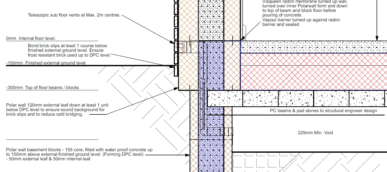

Vijay Posted November 26, 2017 Posted November 26, 2017 (edited) Is there any reason I couldn't have these so they sit at the same height as the concrete beams in a B&B floor? I know a lot of details show the vents under the beams. So like this: air vent.bmp Edited November 26, 2017 by Vijay
Vijay Posted November 26, 2017 Author Posted November 26, 2017 sorry, meant the internal vent height. I know external vent is 150mm above ground level
Russell griffiths Posted November 26, 2017 Posted November 26, 2017 do you mean the beams have a flat area below the height that the blocks sit at so providing a free air gap that the periscope can sit in so allowing good air flow? if so this sounds good to me.

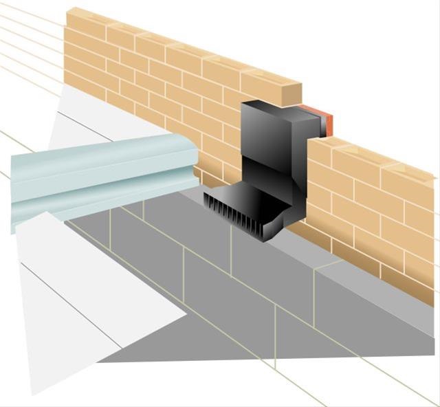

nod Posted November 26, 2017 Posted November 26, 2017 7 hours ago, Vijay said: Is there any reason I couldn't have these so they sit at the same height as the concrete beams in a B&B floor? I know a lot of details show the vents under the beams. So like this: air vent.bmp Hi Vijay if you have the vents at the same height as the beams, you will struggle with airflow BC will want to see the slab before you start building So it might be worth running it past BC We had a simalar problem and I had to buy 70 ent extensions to allow the be to clear the beams

Vijay Posted November 27, 2017 Author Posted November 27, 2017 9 hours ago, nod said: Hi Vijay if you have the vents at the same height as the beams, you will struggle with airflow BC will want to see the slab before you start building So it might be worth running it past BC We had a simalar problem and I had to buy 70 ent extensions to allow the be to clear the beams The vents would sit at the lower part of the beam, so be under the floor block level. Did BC make you lower it?
Russell griffiths Posted November 27, 2017 Posted November 27, 2017 aren't you building in icf? if so can you not cut the inner poly down 50-75mm so the black letterbox sits under the level of the beams. Got out a pic.
Vijay Posted November 27, 2017 Author Posted November 27, 2017 9 minutes ago, Russell griffiths said: aren't you building in icf? if so can you not cut the inner poly down 50-75mm so the black letterbox sits under the level of the beams. Got out a pic. I could if I really had to but would be easier for me at this stage to do it on the the next course of ICF, once the floor beams are in (and I would know exactly where the floor beams and rebar are located) Got out a pic??
nod Posted November 27, 2017 Posted November 27, 2017 9 hours ago, Vijay said: The vents would sit at the lower part of the beam, so be under the floor block level. Did BC make you lower it? 8 hours ago, Vijay said: I could if I really had to but would be easier for me at this stage to do it on the the next course of ICF, once the floor beams are in (and I would know exactly where the floor beams and rebar are located) Got out a pic?? 9 hours ago, Vijay said: The vents would sit at the lower part of the beam, so be under the floor block level. Did BC make you lower it? No our engineer said I was wasting my time putting the vents in if they were obstructed So I made the decision to extend them all
Mr Punter Posted November 27, 2017 Posted November 27, 2017 The proposal looks fine as it will vent under the blocks and you can it the vent on the beam DPC. Do you have any vents where the beams run parallel?
Oz07 Posted November 27, 2017 Posted November 27, 2017 I'm not sure you even understand what you are asking. You sit the internal vent on the same course you place your beams. The beams hold the block infill 50mm above this course. Your vent fits in this gap what alternative is there?! What are you asking?!

Vijay Posted November 28, 2017 Author Posted November 28, 2017 20 hours ago, Oz07 said: I'm not sure you even understand what you are asking. You sit the internal vent on the same course you place your beams. The beams hold the block infill 50mm above this course. Your vent fits in this gap what alternative is there?! What are you asking?! 1 minute ago, Vijay said: I have but the beam will be at least 50mm in front of vent This is how it's been drawn on my plans
Vijay Posted November 28, 2017 Author Posted November 28, 2017 And this is how I would like to sit them, on the same level as the beam
Russell griffiths Posted November 28, 2017 Posted November 28, 2017 How come you want to sit them higher? have you poured up to that level. Tbh both ways look fine to me the only argument I can see is if bc say that you won't have enough air flow with it being tight to the underside of the floor.
Vijay Posted November 28, 2017 Author Posted November 28, 2017 Not poured the concrete yet but it would just make my life easier to do it on the next course when the beams are in place. It also allows me to try and set the brickwork out, so the vents are in the right place on the exterior

Vijay Posted November 29, 2017 Author Posted November 29, 2017 Cheers guys. Spoke to Polarwall and he has no problem with them on the same level either and is gonna knock me up a sketch to show building control
