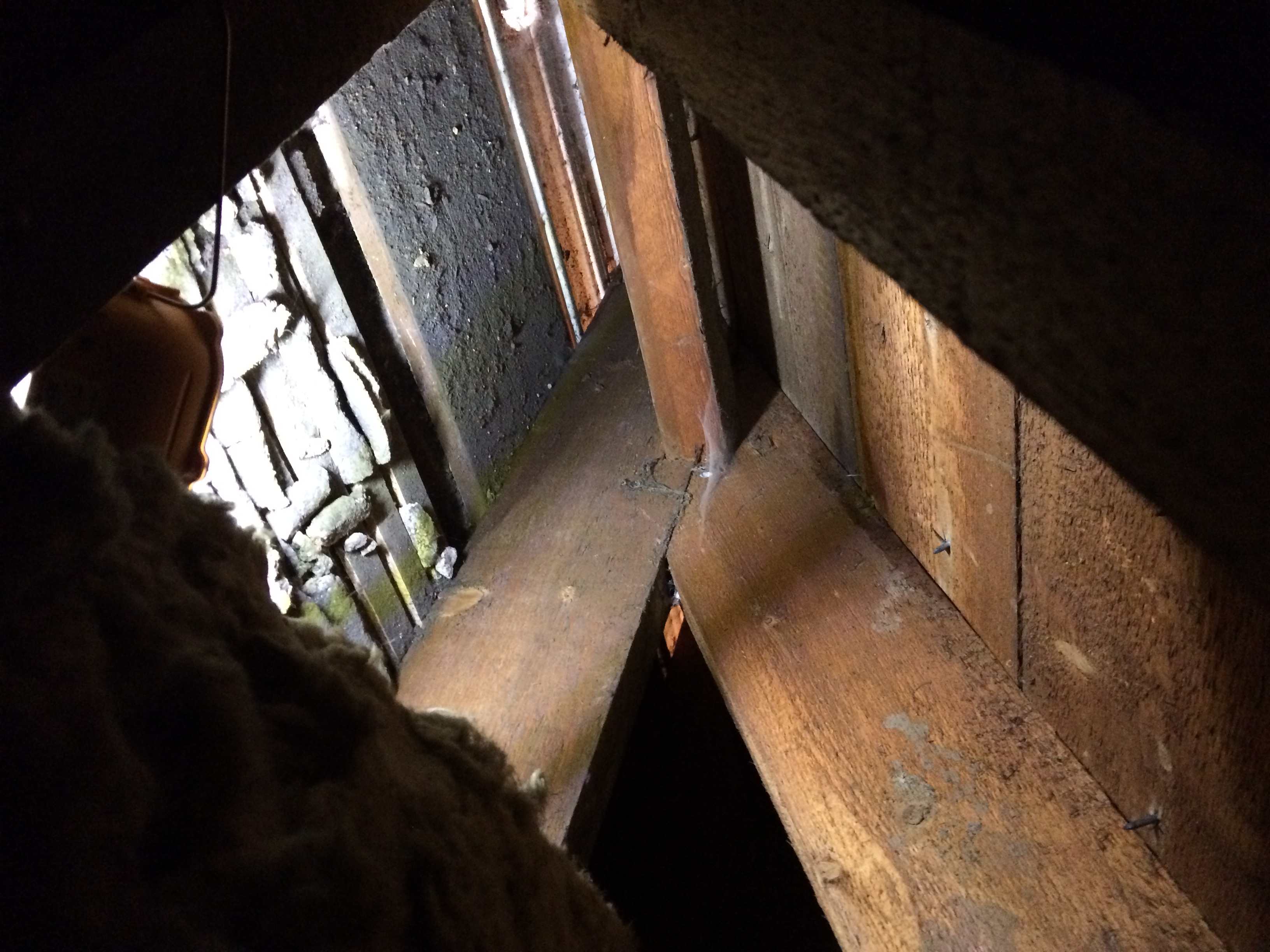

Gus Potter Posted January 3 Posted January 3 (edited) On 03/01/2025 at 01:54, Garald said: Of course part of the idea of reusing the existing structure is to reduce waste Expand I agree. It's a good appoach to let sleeping dogs lie. The existing roof will likely be restraining the existing wall heads. Often in the Uk we used what is called a pole plate roof. Here there is a timber runner that locks the rafter base to the ceiling joist. I'll dig out a photo, not tonight but later if of any interest. The more you mess with an existing roof the more risk that it will move. If you have a period property then you get no prizes for cracking the walls! Now this may not apply to you but many old walls rely on having a good amount of compressive load from above. Sometimes we can "unload" an old wall and we think that will be good for it.. but in fact it can be very bad! At first glance this is counter intuitive but the compressive load keeps the say soft lime mortar in compression. Masonry walls perfom well if they are subject to reasonable compression. In laymans terms this helps keep the joints tight., and by default water resistant. I could show you the maths but lets stick to concept ideas for now. Edited January 3 by Gus Potter 1
Garald Posted January 3 Author Posted January 3 On 03/01/2025 at 02:14, Gus Potter said: I agree. It's a good appoach to let sleeping dogs lie. The existing roof will likely be restraining the existing wall heads. Often in the Uk we used what is called a pole plate roof. Here there is a timber runner that locks the rafter base to the ceiling joist. I'll dig out a photo, not tonight but later if of any interest. Expand By all means do!

Gus Potter Posted January 3 Posted January 3 On 03/01/2025 at 03:23, Garald said: By all means do! Expand Rotate the image +90 degrees. i.e clockwise. The pole plate is the ~ 50 x 50 mm timber that locks the rafter to the ceiling joist. The simplicity of this connection is remarkable but this is not taught at university... and you won't find this in standard text books. What you will find is plenty Architects / builders and other historical types talking about this but few actually know how it works @ETC fancy a go? Just kidding you.. The primary forces are the gravity loads, wind uplift, timber shrinkage and creep. Now you live in France.. so you'll have some of these stunning winding stone stair cases that seem to be supported by sky hooks. We know they work and why qualitatively.. like the pole plate above... but if you get some twat from your approval authority that says.. lets see some calcs. It is very difficu to prove it by calculation. Even when you can you find that many old buldings and their structural membesr can't meet the moderns design loadings. When this happens we as SE's need to delve deep in our basic maths, we have a look at probalility and risk of over stress. and all the while folk are slagging us off and not willing to pay for us keeping their kids safe? I've got some high end soiftware that does finite element analysis.. it could maybe come close but it could take me about a week to set up the model.. then I need to verify that my model is rational, then explain to some (expletive deleted)wit in the council what it is all about. I would not do this for less than 7.5k... UK pounds. Now imagine if I sent this stuff to your local French Authority. They would / may do one of two things. The smart folk would say.. let's see how the Scots guy is modelling this and the conditions / assumptions he is making in his model. they would use it as a CPD excercise all at your expense.. the rest would say.. we don't like Jocks so "^ let them have intercourse" Still happy to give you a bit of advice though but as you can see from the above I'm a bit of a pragmatist. 1
