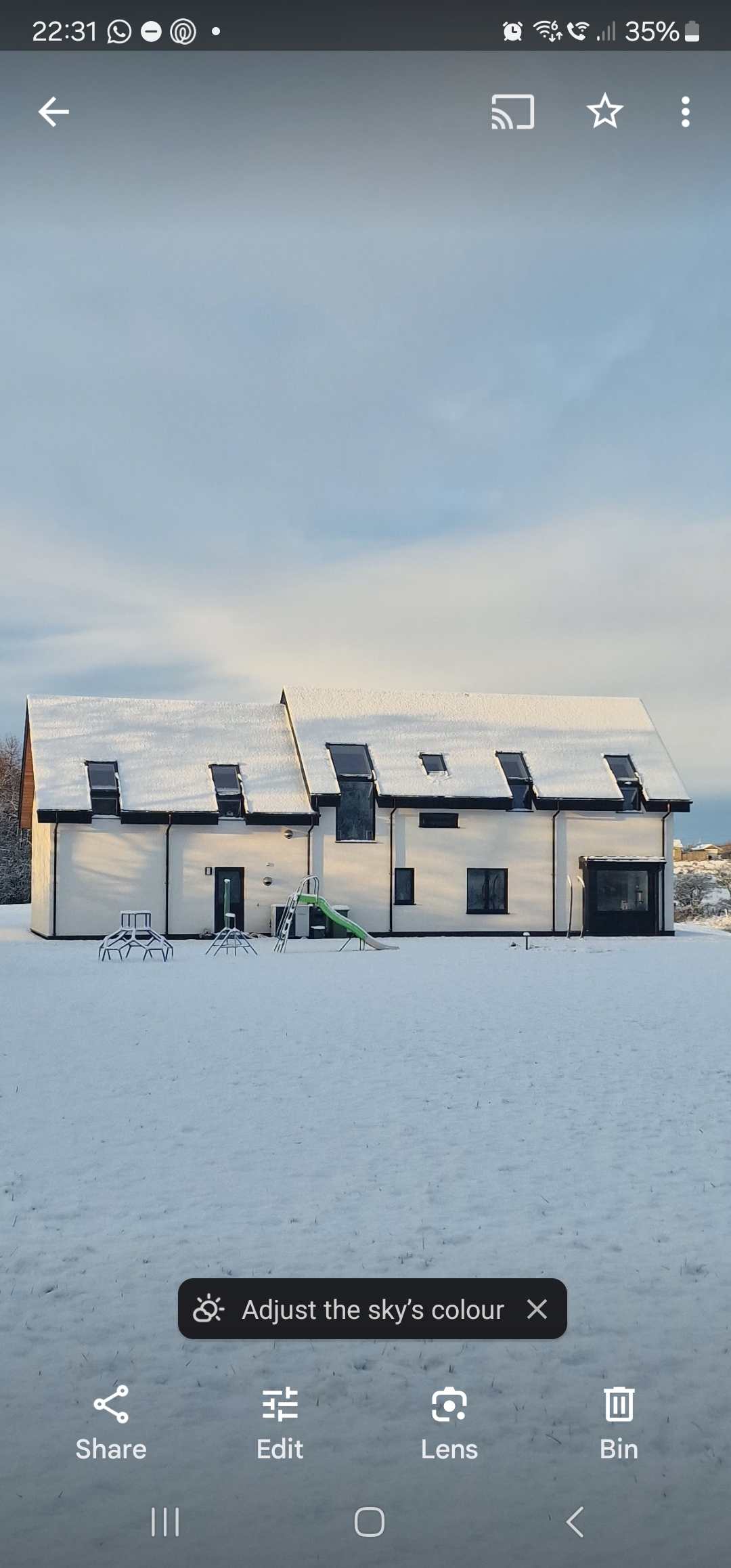

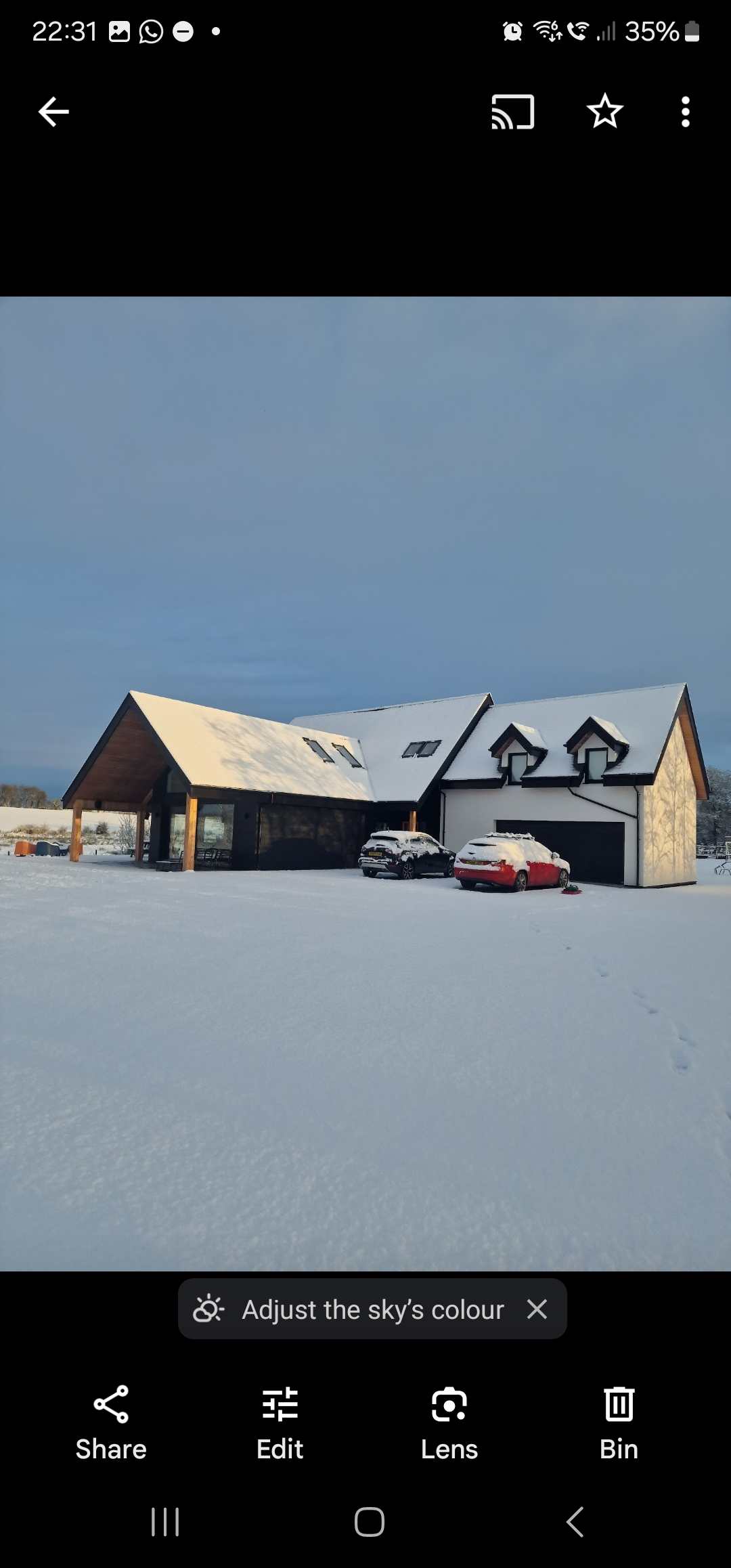

SuperJohnG Posted December 2, 2024 Share Posted December 2, 2024 I've a SIPS house with renderboard (Knauff Aquapanel) and K rend TC15 finish. Lovely walls with no expansion beads or unsightly breathers. 20m run on 1 wall...looks mega. Zero brickwork. Noise is a zero issue. Feels solid always, there was a very slight vibration when we had an Uber storm (90+mph winds) but that's all I'd say. You probably wouldn't have that in a block work house. We had no issues with getting a lender, we are with Barclays and house insurance and structural warranty no issue. SIPS is stiffer than purely timber framed so that may be less solid but I'm not sure. Self_build_ayrshire on Instagram if you want a look. 2 Link to comment Share on other sites More sharing options...
saveasteading Posted December 2, 2024 Share Posted December 2, 2024 25 minutes ago, SuperJohnG said: may be less solid but I'm not sure. Note how the snow has not melted anywhere on the roof. A very good proof of continuous and effective insulation and airtightness. Or that the heating is set low or off. Link to comment Share on other sites More sharing options...
G and J Posted December 2, 2024 Share Posted December 2, 2024 13 minutes ago, saveasteading said: Or that the heating is set low or off. Maybe they spent so much on the build they can’t afford heating lol Being serious our design started timber frame and no masonry skin. We did a good few hours research and concluded that at least a partial masonry outer skin increased the number of normal mortgage lenders (and we think house insurers) which would accept our house, and more importantly for us a significantly greater number of lifetime mortgage companies which would accept our house. We changed our design to just over 50% rendered block as a result. We will never know whether it would have caused us issues…. 1 Link to comment Share on other sites More sharing options...
