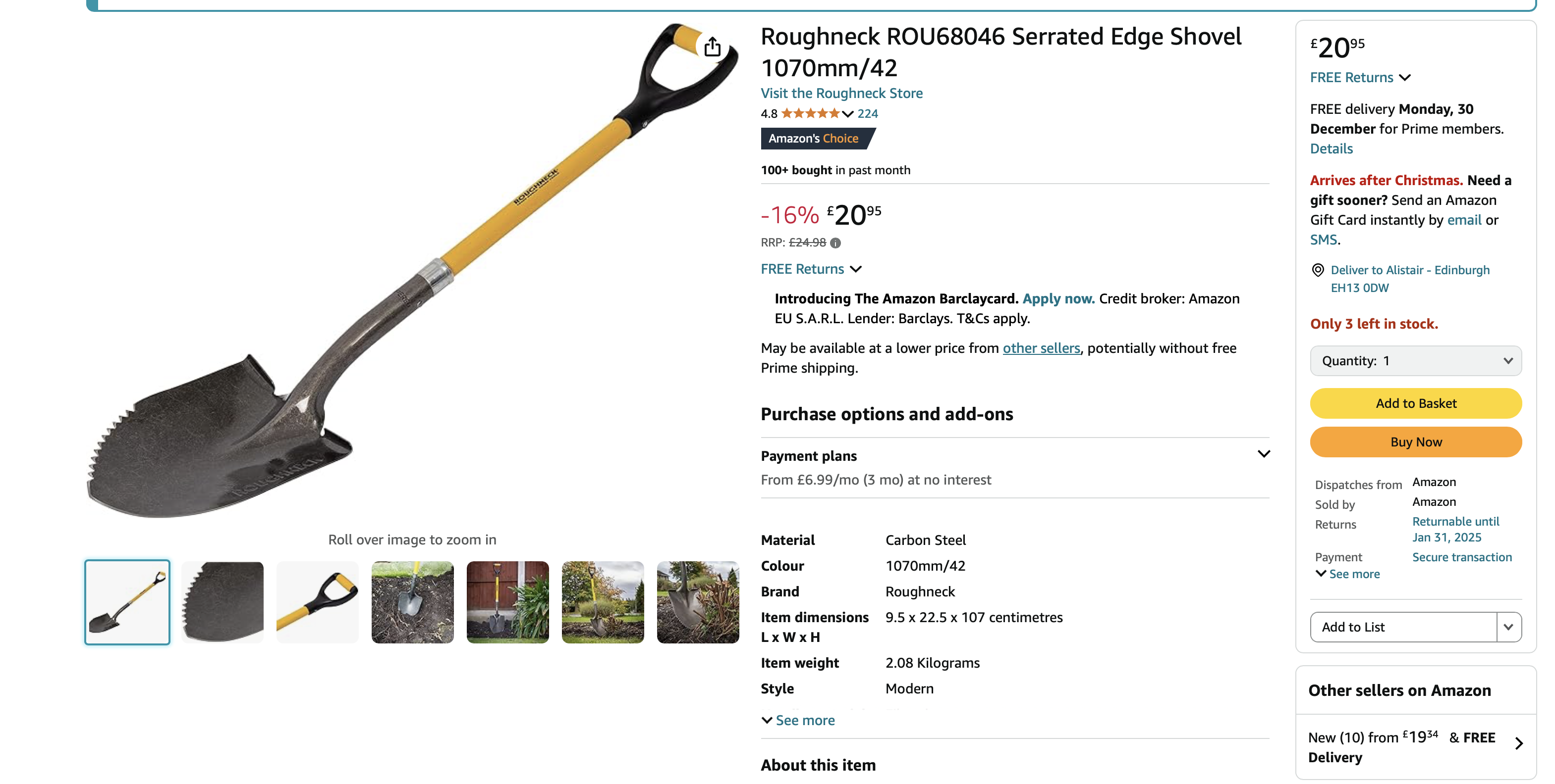

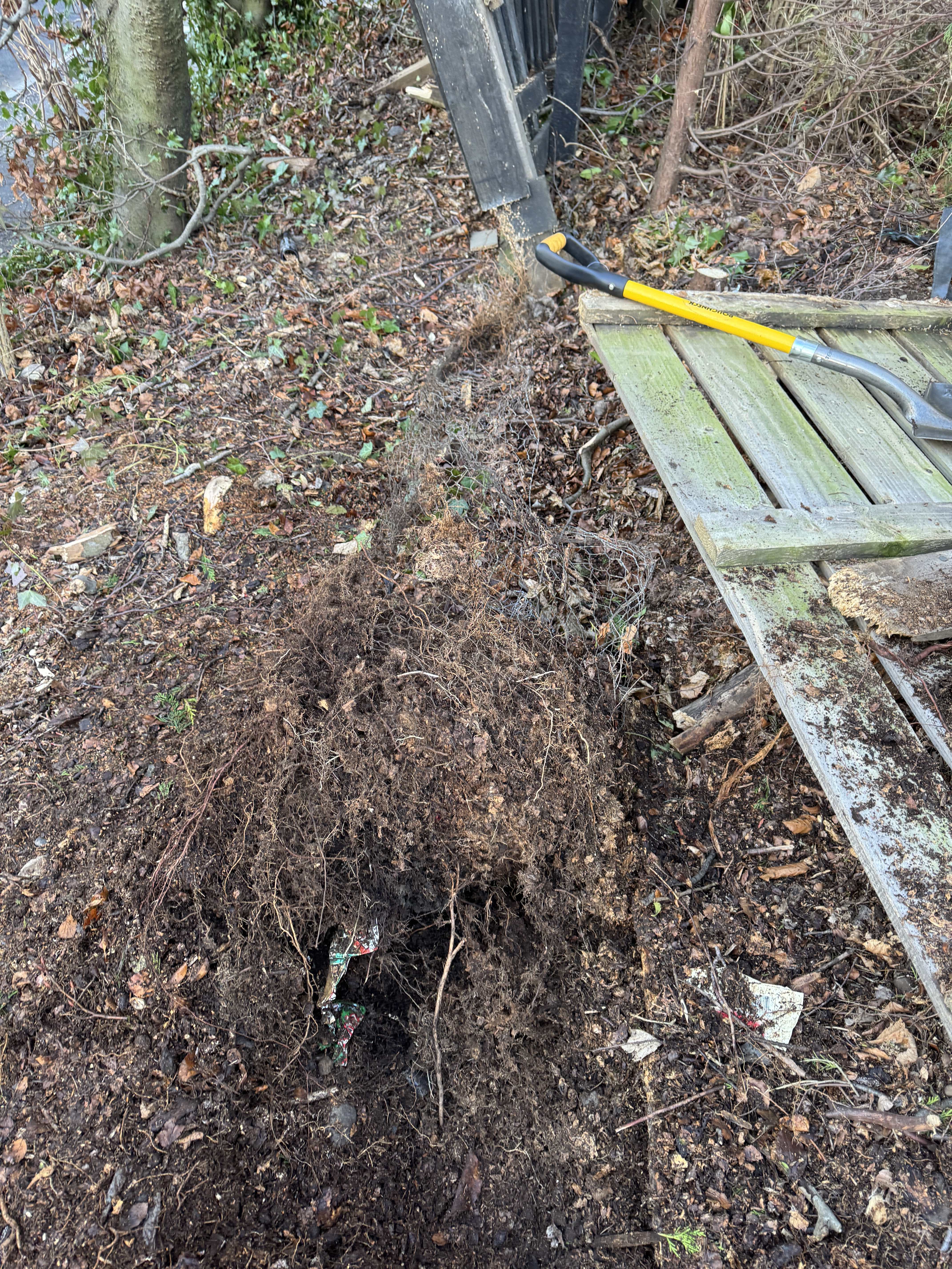

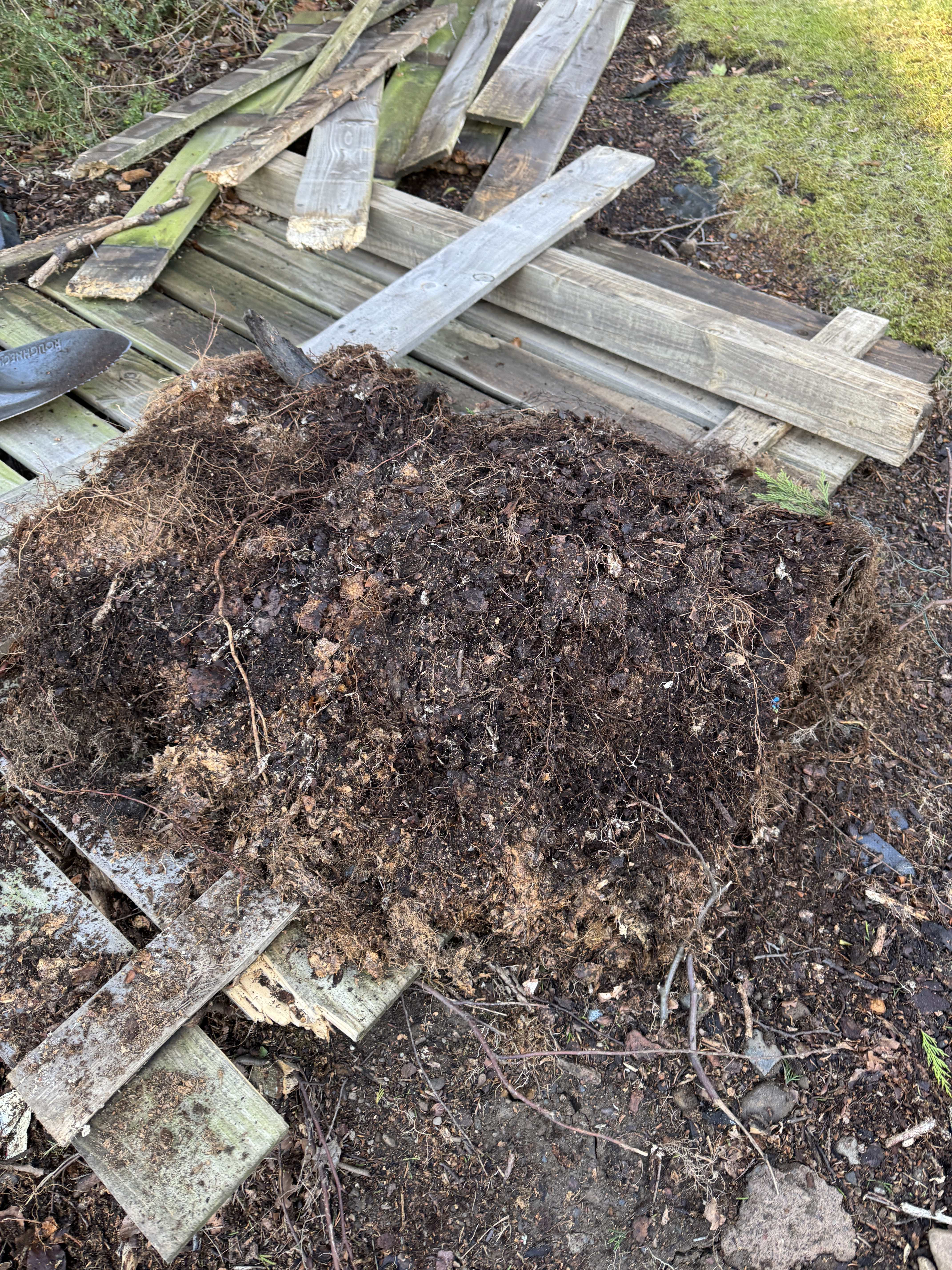

AliG Posted December 20, 2024 Author Share Posted December 20, 2024 I bought this shoveI. It has been excellent for £21. The serrated edge is very good at cutting through things. Have spent three hours so far digging and pulling. The best thing to do seems to be to dig along just past where you think the chicken wire is buried, then you can pull it up like a roll of turf. The problem is places where roots have grown through it, sometimes up to 2cm thick and in one place where someone wrapped it around a large tree and the tree has grown into it, I just had to cut it there. They also just dumped unused chicken wire on the ground to grow into the undergrowth. Idiots. As you pull the chicken wire back you occasionally have to stop and run the shovel under it to break up roots. It has been back breaking work, I have had to put my not inconsiderable weight behind pulling it out. A woman stopped and cautioned me that her dad did in his back doing something similar. My recommendation would be that you should use chicken wire sparingly. I have also been able to perform an archeological study on the eating habits of builders and school children. They appear to really like McCoy's crisps. 1 1 Link to comment Share on other sites More sharing options...
