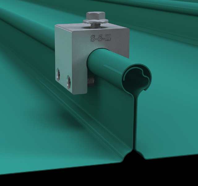

saveasteading Posted December 1, 2024 Posted December 1, 2024 It will likely be steel, coated with Plastisol. If within about 10 miles of the sea it needs a special finish. The PV will not load the cladding but will bear on the structure behind it. The reason for having standing seam is that the fixings do not penetrate it. So to then screw PV through it needs skilled attention. All the above may well be understood by the build team. It needs maintenance much sooner than tiles. Decades, but fewer of them. Why is the developer using it? Much cheaper while also being fashionable. That's why we are using metal cladding on ours, buf it will be screwed, not standing seam.
Russdl Posted December 1, 2024 Posted December 1, 2024 We have a standing seam zinc roof with a loft space that is open to below. It’s a warm roof construction, so lots of insulation between the zinc and the loft space and we don’t hear the rain on the roof at all so if your loft is more standard and closed off to the rooms below I don’t think you’ll hear a thing. I wouldn’t do zinc again because of how quickly the pigeons have made a mess of it that doesn’t wash off despite the endless rain. Probably most people don’t see it - I do. 18 minutes ago, saveasteading said: So to then screw PV through it needs skilled attention. That really shouldn’t happen. There are numerous fittings to attach PV to standing seam roofs, I’d have flipped my lid if the solar dudes had tried to drill through our zinc roof.
