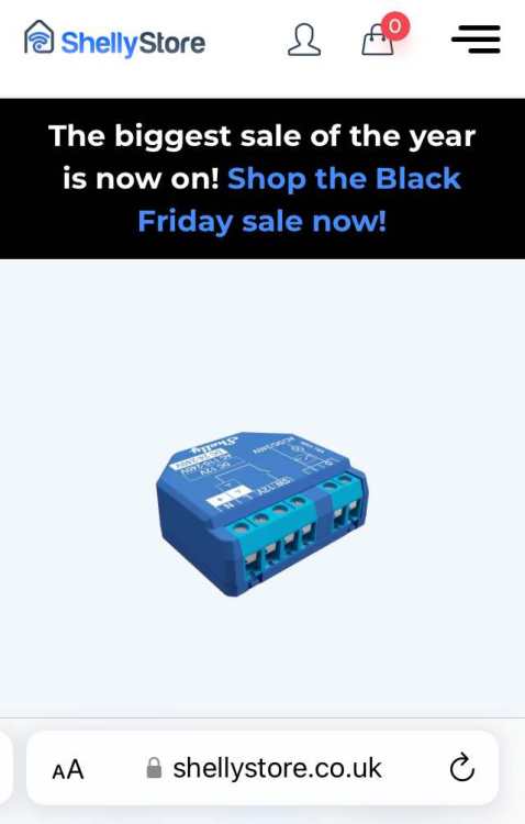

So how can one wire one of these relays so the manual switch and the relay work side by side?
Say for example a simple, single switch/pendant light.
Posted (edited)
Take a look at the specs for either the Shelly device above, or the Sonoff mini.  It's very simple, from memory, you take the power and switched live from the wall switch, put them on the wifi switch and take leads from the wifi switch to the wall switch live and switched live (and maybe a neutral).   Once you switch the circuit back on at the CU, you can search for the new device in the app.
Also, Sonoff do versions for Zigbee as well as wifi - I think zigbee has a better range and is less susceptible to a poor signal. I might be wrong there.  If you do go Zigbee, you'd need a Zigbee to wifi bridge to get the devices visible on wifi.
Buy one and have a play...  they're very cheap.

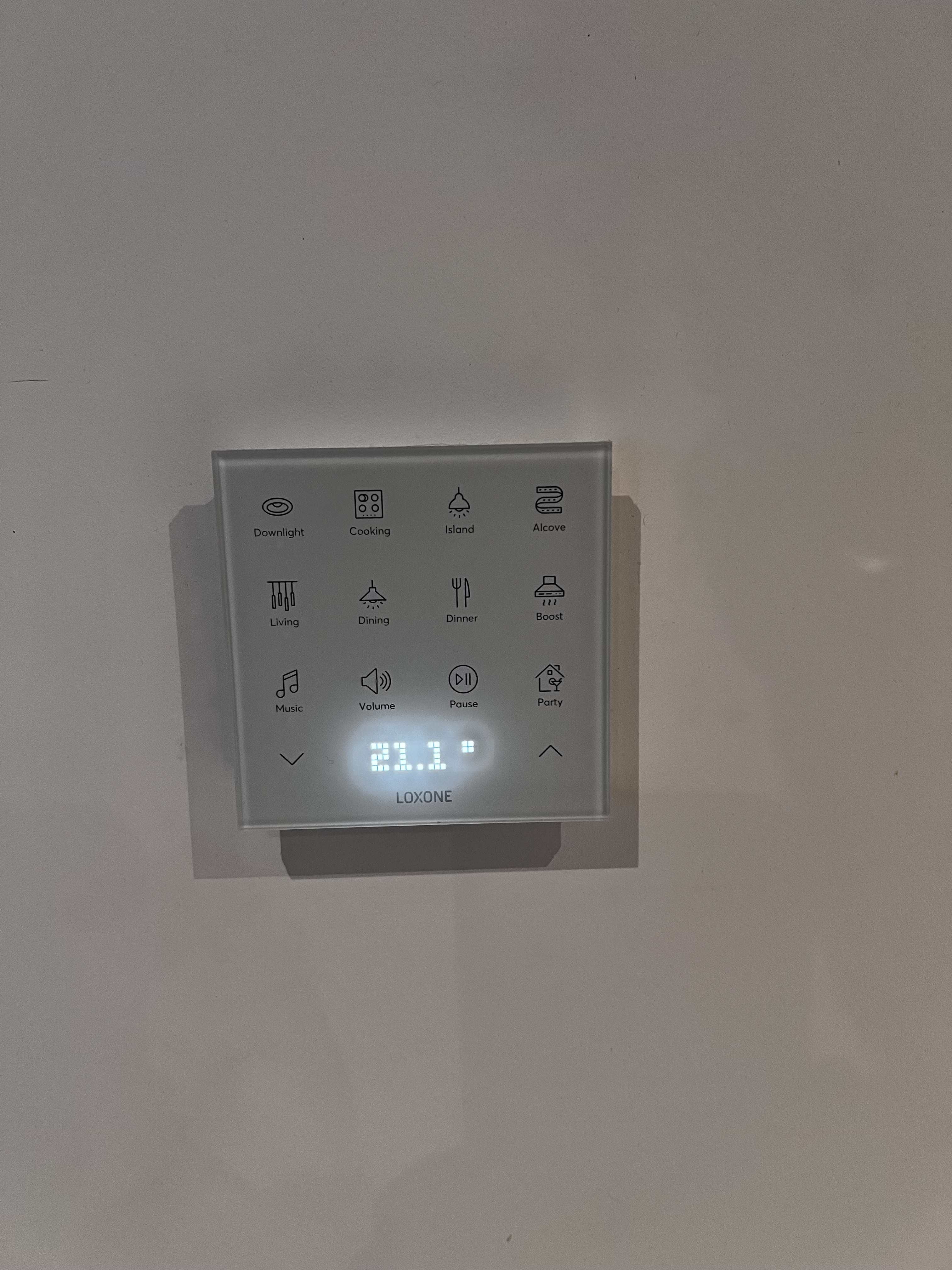

Posted (edited)
1 hour ago, Thorfun said:
There’s something magical about walking in to a room and the lights turning on to your chosen preset mood depending on time of day and current light levels etc.
I love it and glad I went down the Loxone route.
Me too but it is dear like any of the dedicated systems and arguably not worth it if it’s just lighting you are controlling.
My favourite part of the lighting is this switch that controls the whole open plan area and its many lighting circuits. You can also tap through all the various moods as there are several of those.
Edited by Kelvin
